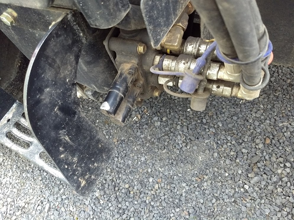

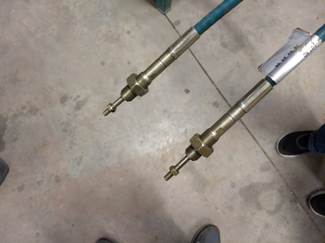

I don't know how similar your tractor is to mine, but I took some pictures that may help you if they are similar.
The first picture shows what your lower cable ends might look like. The smaller threads and lock nut on the end of the inner cable attach to a pin on the hydraulic unit under the cover we'll talk about later. The larger thread and lock nut on the outer cable end will screw into this same cover.

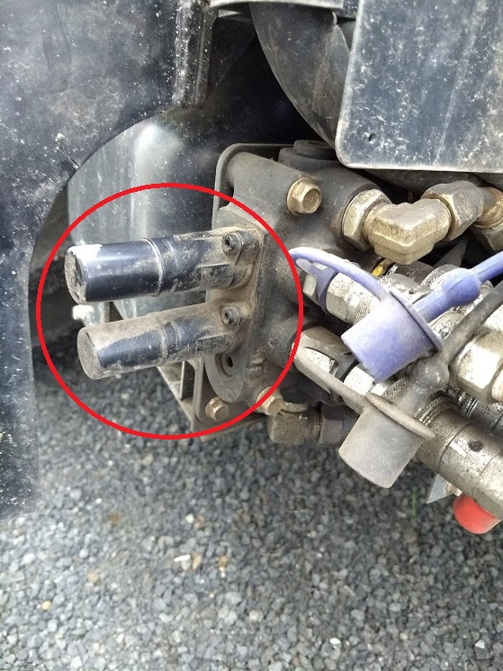

The hydraulic unit on mine can be made to operate from either side (the cables could be made to come in from the right or the left side). My cables come in on the left side. I can't access them to take a decent picture for you, so I took a picture of the unused right side covers instead. The left and right side covers are the same except the ones on the left side are made open on the end so the large threads on the outer cable in will thread into them. The cover is held on to the hydraulic unit with two allen screws. To remove the cable, you back off the big lock nut all the way so it is off the threads and is just sliding loose on the outer cable housing. Then you remove the two allen screws and back off this cover by unthreading it on these same threads the lock nut was on. You unthread the cover until it is off the threads completely and is also sliding freely on the outer cable housing. Then you can access the smaller lock nut and pin to disconnect the inner cable. Hope that makes sense! If yours ends up being substantially different than mine, ignore all of this:) I'll bet they are the same though.
On mine, I found it far easier to remove the whole hydraulic unit to access the lower cable ends. (I am 70 myself, and working under the tractor in a tight place isn't my cup of tea:) To remove the hydraulic unit, you have to disconnect all of the hydraulic lines both into the hydraulic unit and out of the hydraulic unit. If you do that, you had better lower the FEL to relieve all pressure on your bucket cylinders or there is a chance that the FEL will fall when you disconnect the hydraulic lines . It shouldn't, the check valves in the quick disconnects should prevent that.... but do lower the FEL just to be safe.
Pay attention to exactly how far each set of male threads on the cable are screwed into their respective female threads before you start. Duplicate that distance on re-assembly and you will make cable adjustment a lot easier.
