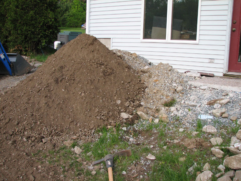

I had a nice writeup, but lost it - so this will be quicker.
Regrading where the pool used to be (lots of gravel & concrete chunks buried shallower than I thought:eek: ). Having trouble removing rocks w/ landscape rake. Tilled the area, then raked. Pulled a bunch of midsize rocks out.
Plan A - build screen & process dirt thru it - ~6,000 sq foot area - 55 yards if I go 3". Potentially timeconsuming
Plan B - buy sceened loam & cover. Expensive & still timeconsuming - can't get a truck back there - would have to shuttle loam with tractor.
Plan C - till again to get most of the bigger rocks out. Leave gravel & hope for the best.
Thoughts?
Some pix.

Here's what I did - I tilled it up again 2 passes. With a little experience under my belt, I can tell by the sound & how high the tiller jumps, how big a rock it just uncovered. I'd make a pass & then go back with a 5 gallon bucket and pick the bigger (potato size & up) stuff out. I've since raked it again. Found the larger stragglers. I've come to the conclusion that the new grass is just going to have to deal with the gravel sized pieces. If it turns out it doesn't grow, I'll order some screened topsoil.
I did buy some hardware cloth to build a screen, but figure it would take too long to try to collect all the soil to screen it. I will screen the dirt/rock mixture I have stacked up.

Unfortunately, there isn't an easy answer with that small of rock. From the looks of it, I'd guess that each time you'd work it, more rocks would be brought to the surface.
Have you tried angleing your rake and windrowing? That should get some of it, but it won't get it all. If you haul in some screened top soil to cover the mess you have now, all those rocks will work their way up.
The only other way I know of is a rake and bucket, which is very time consuming, but guarentees you pick up the worst of it.

For the best results, I would bring in a few inches of topsoil. I would not bother with the screen unless you have the time to spend. That gravel doe not look bad at all. I would say throw down some seed and keep it well watered. The grass will hide the gravel over time.
