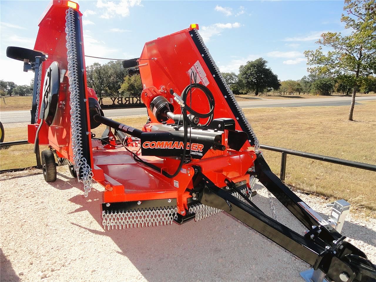

We Have 12ftWoods 5040 and ds1440.JPG and 8ftLandpridetractor3.JPG,im not familiar either with the two mentioned but I think for the money if just light mowing the Plainsman or the heavier stuff the Commander series would be a good pick lp15ft.jpg for the money. Another thing to consider that 15ft finish mower got alot more to it then just a regular batwing mower. Another shredder to look at would be ModernAgmodernag15ft.jpg they are made right here in Texas:D...
My 15ft batwing is a TerraKing(I think)or (OLD YELLER!)batwing1.jpg gets pulled by a 46hp Kubota M5040mowing.JPGfresh cut pasture.JPG

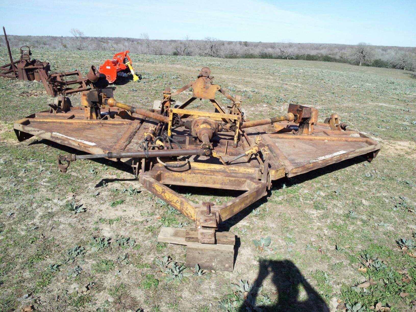

We Have 12ftWoods and 8ft Landpride,im not familiar either with the two mentioned but I think for the money if just light mowing the Plainsman or the heavier stuff the Commander series would be a good pick for the money. Another thing to consider that 15ft finish mower got allot more to it then just a regular batwing mower. Another shredder to look at would be ModernAg they are made right here in Texas...
My 15ft batwing is a TerraKing(I think)or (OLD YELLER!) gets pulled by a 46hp Kubota M5040.

Thanks for all the photos and excellent explanation on each component...Pictures are worth a thousand words, eh..??? After all of the comments received I will be moving forward with purchasing a rotary cutter for my mowing needs... I will lower the cutting height and try to cut it before it gets too high in order to keep up with it a little better before it gets out of control...
