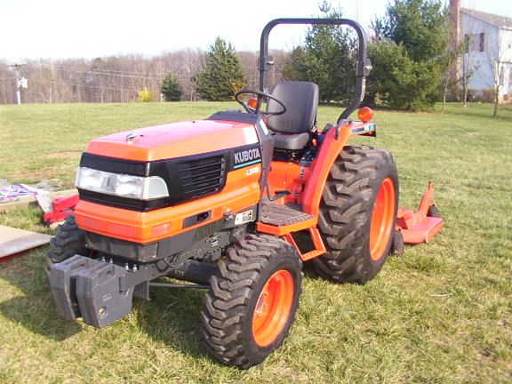

Jeremy at Byrd tractor in Manassas. Also, John at McMichaels in Warrenton. They were both $12,500.
However, unless I can sell my L3410, I won't be buying anything.
Another shamless plug: Intersted in buying a used L3410? I could save you a couple dollars over new? My tractor is HST, 4WD, with less than 170 hours, R4 tires, folding ROPS, front weights, mowing deck, spreader, PHD 9" & 12", carry all, and sub-soiler. E-mail me and come test drive, maybe we can work a deal.
