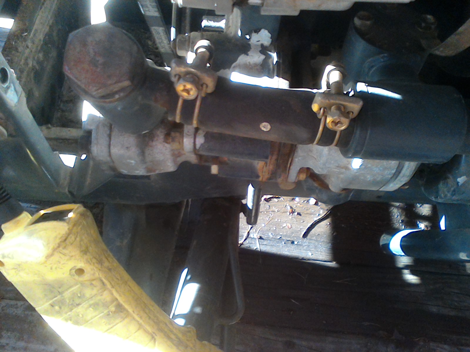

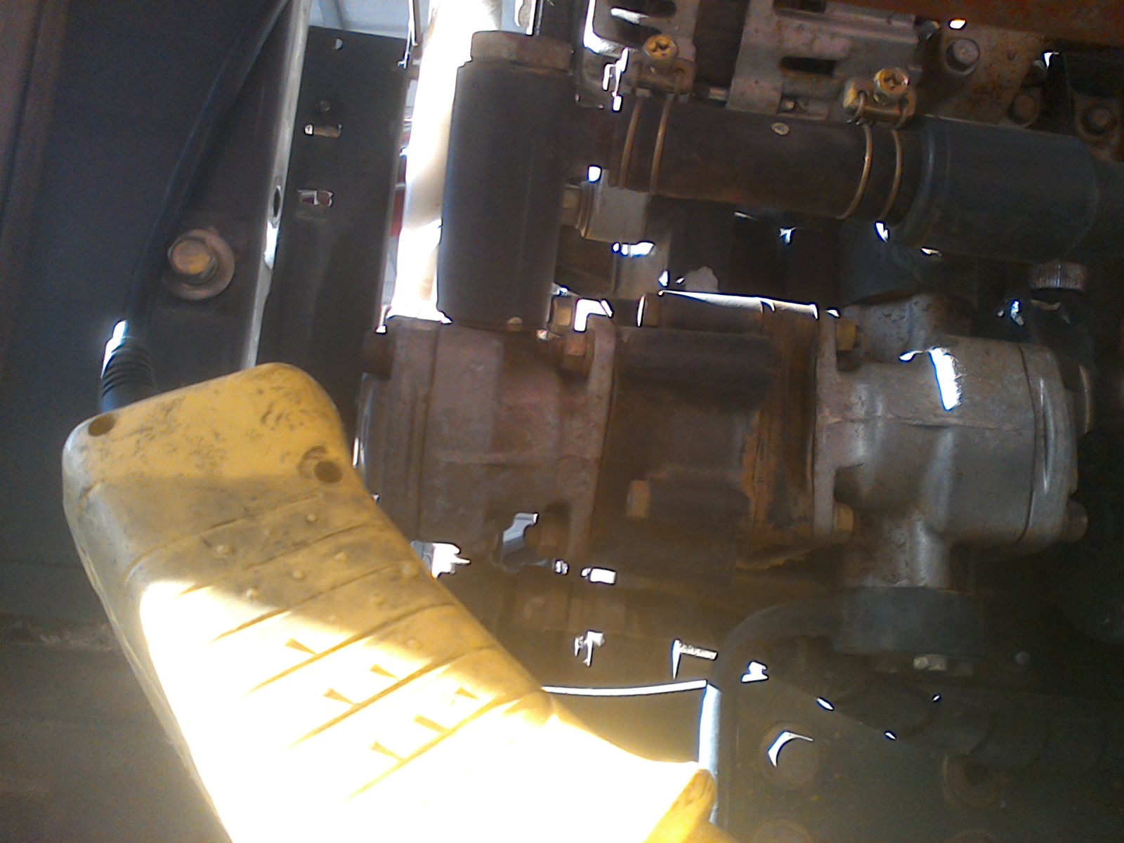

Hi, I bought my Mahindra 2015 tractor new in 2005. The engine finally died and now I am stuck on how to even get it out. I have stripped all the panels and stuff off to get to the engine, but there are two issues that has stopped me cold.
I can not find any diagram/manual that shows how to actually seperate the engine from the manual transmission such as what bolts to remove and where. The second issue is, it has a Ansung loader, model AM20 that I am working around - fun.
On the right side of the tractor, there is an hydraulic unit that is bolted to the front block. It has a steel pipe that runs under the engine to the left side to another hydraulic block where the hoses for the loader connect to. Also, the block on the right has another steel pipe that runs back to the rear and a hose that goes to the center console area. I need to know how to disconnect this from the engine so that I can remove the engine without any damage to this unit. Any help / assistance will be so greatly appreciated. WIN_20170128_150745.JPGWIN_20170128_150724.JPG

From your questions it sounds to me like you're likely in over your head. You have to split the tractor to separate the engine and tranny. Tractor engines anent like automobile engines as the engine block and tranny case along with the rear axle and diff housing bolt together to form one single solid unit from which everything else mounts. The unit on the front is the gear driven hydraulic pump. If you didn't know this kinda stuff then I'd say you'd be better off finding a qualified tractor mechanic to take over. You need to at least get your hands on a set of service and parts manuals before proceeding any further.

Also, I think I'm with dickfoster on this one - the loader needs to come off first, then a bunch of bolt on parts. The engine is a structural part of the tractor - meaning you will need a nice surface and will need to split the tractor. The halves will be difficult to move. And then, the front will be difficult to balance when the motor is removed. You need a couple floor jacks, engine hoist, chain hoist, maybe a second machine, etc.
