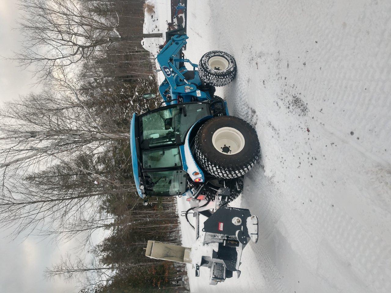

My LS was purchased to be able to handle firewood processing. 40HP and lift capacity of 2700 lbs. I lift nearly 1/2 cord at a time in modified IBC cages.
I use a 74" inverted blower for heavy snow and a front mounted back blade on a SSQA adapter for light snow and back dragging:
I use an MTL grapple to handle logs and it works well. If I did not need to handle IBC totes I might go with a set of pallet forks with a thumb for logs (look at what Sawyer Rob uses on some of his posts...looks good and a bit cheaper than a dedicated grapple). In any case, you want a 3rd function.
My LS was $31k with dealer installed 3rd function last year. A lot of tractor for the $$$.
