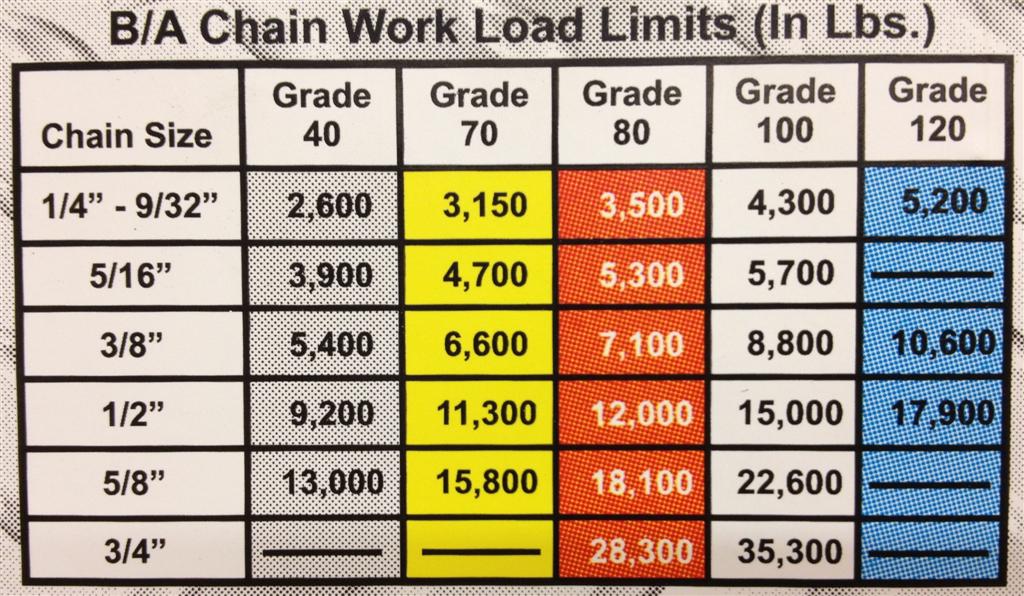

Your tractor will probably fit on a 20' trailer. 10K would be marginal figuring the trailer may weigh 2500 itself. Might want to look for a 12-14K trailer. 5/16" Gr 70 chain will be fine. The WLL of 5/16" is 4700 Lb. per chain. Use 2 in front and 2 in back. You can use ratchet or manual binders. You will also need to secure loader and BH bucket to trailer for tie down. Your F350 should have no problem hauling it around. You will need a trailer brake controller in the truck if you don't have one.

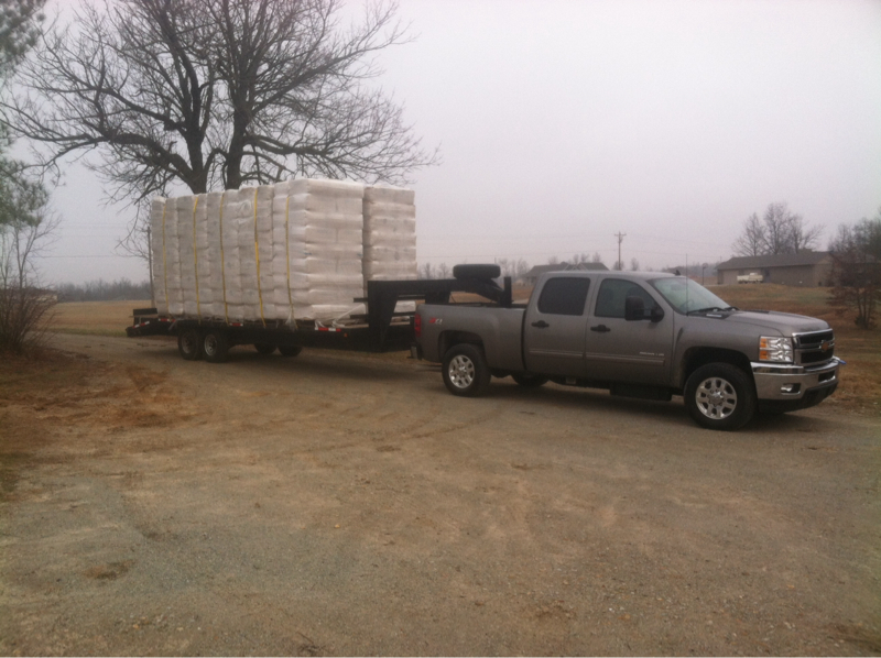

I went with a 25 foot deck over gooseneck for my 4200 Deere, but I'm really not a fan of bumper pull trailers, I have a place to put my loader, on the neck over when I haul my ranger, got plenty of room to haul extra implements. But I also haul hay and other heavy items for the farm. And tractors on equipment on deck overs are easier to boom down, there just at the right height. I do have a utility trailer also. But a tilt would be nice! LUTT

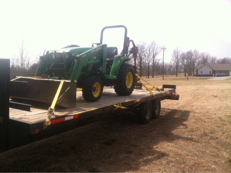

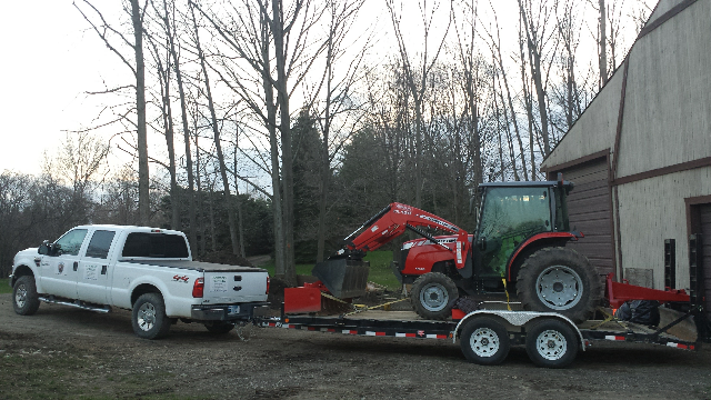

Here's a photo tonight of my trailer loaded up. I've got my 84" box blade at the front (maybe 700 lbs?) And my 96" HD back blade (1000+ lbs?) hanging on the back of the tractor. As you can see, I don't really have room to add more weight to the trailer; The back blade is tucked right in at the ramps as it is.
FYI...
