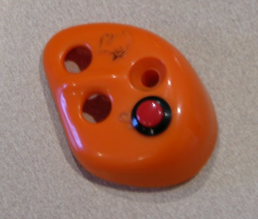

Thanks for all the suggestions guys. After a bit of re-consideration we opted for a thumb button instead of a foot switch. Decided it would be better not to expose a switch to all the mud that collects on a platform. This will be a part of our next addition, shown is the modified joystick faceplate.
