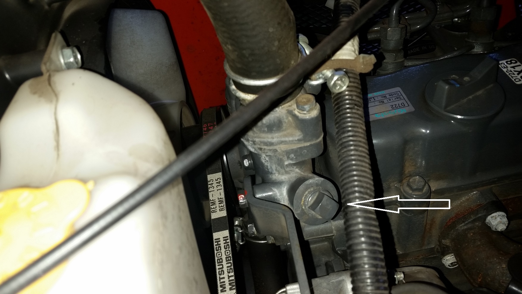

I see threaded ports on other BXs, but I don't think I have one. (D722 engine). I see other freeze plugs but don't know if there is room behind them for a heater element. The only recommended location for a heater I can find is the front top freeze plug (where my muffler obstructs its installation).
There is a threaded port on the lower thermostat housing. It seems like it would be too high to effectively heat the engine block. Anybody know if that is accurate? Anybody know the intended purpose of the threaded port on the thermostat housing?
Thanks!

Thanks, guys, for your help. HeLa, I called Messicks today and they were helpful. They said that the 70000-00298 part (lower hose heater) was the only heater recommended for the BX1860. Your install thread was very good and I wonder if the same thing would work on my machine. I see a freeze plug at about the same location - easily accessible, but I don't know what's behind it. It looks like your heater is designed so that it only extends a short distance into the engine block. I'd sure prefer to use that type of heater.
Ford850, I think you're right that I got the wrong heater. It fits just fine, unless you are one of those crazy types that wants a muffler! :) The link you provided was helpful, too. From what I can gather the 77700-00298 part number is no longer valid. When I talked with the Messicks guy today he said the only option is a hose heater.
oldnslo and 100 td, the part you reference (100 td) is the one the only recommended one for the BX1860.
How does yours work, oldnslo? Did you install it yourself?
Maybe I am overthinking this, but I really would prefer to have a block heater. I am tempted to attempt an install like HeLa; I guess the worst that could happen is I have to re-install a freeze plug if I see there's no room behind it. Well, there's always a chance I put a hole in whatever is behind the plug, but I'd be careful.:eek:
i wish i had taken more photos in the process :-/
the element on my heater is in fact very short. additionally, the space behind the freeze plug is limited in depth and width (the element MUST be oriented vertically to clear).
