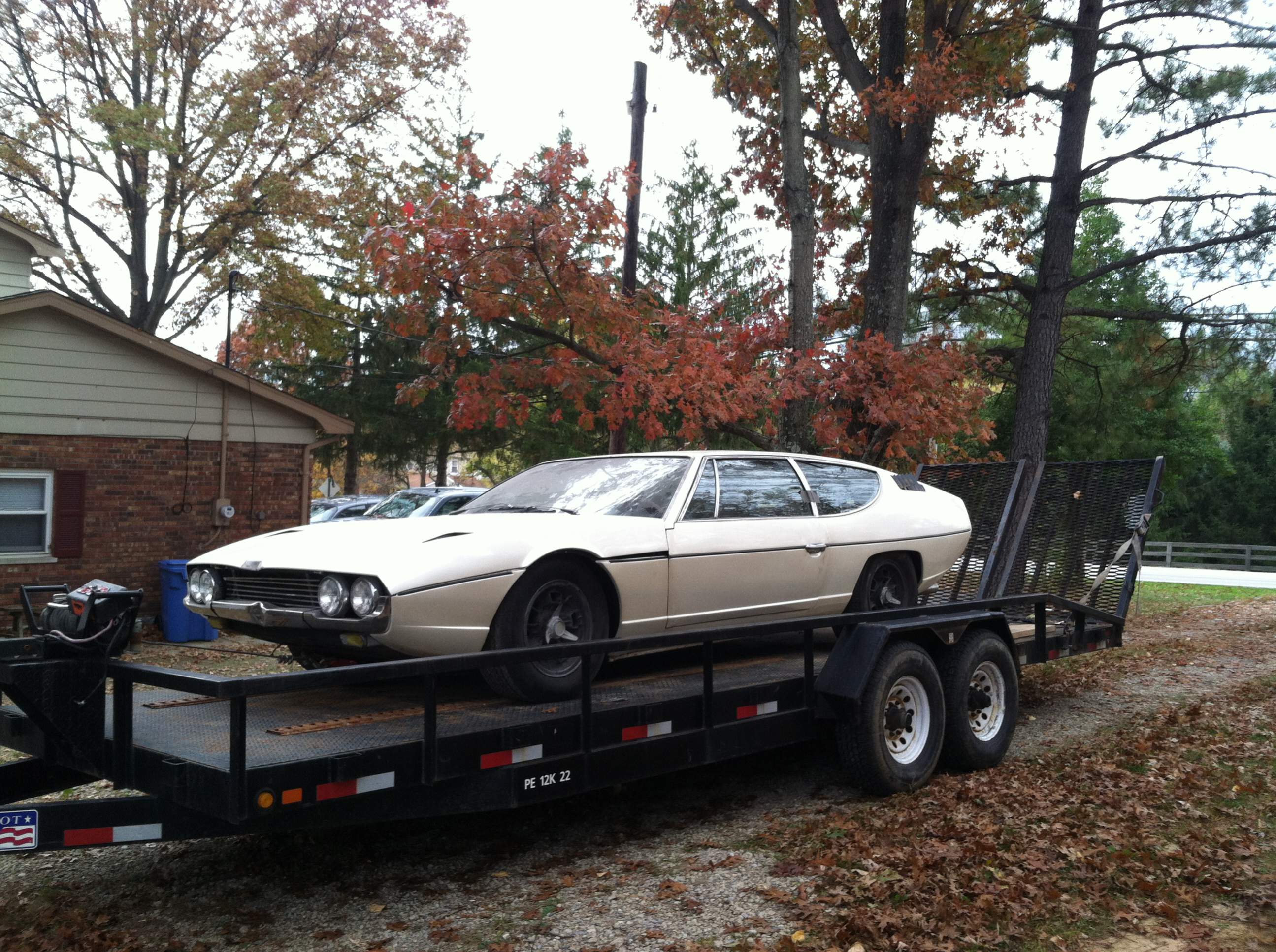

After running an open center, light duty car trailer for years, this 22'/12k lb trailer fell into my lap. Its unique and its the closest I've come to a one size fits all trailer yet. It was originally built to haul a rock crawler, hence the wide landscaper style gates and side rails, and it originally had a side gate for loading an ATV. I removed it to make forklift loading of pallets easier.
Patriot Trailers in Indiana built it new. The floor is 3/16" diamond plate steel on 12" centers, 12k axles, 3650# empty. I've since learned there's a 14k model, which is identical except for the heavier rated hubs. It cost me $2500 a couple years ago, used but in clean shape.
Its had 22' long sheets of roofiing, a Uhaul box truck, my F600 dump, etc on it. (you have to remove at least one of the outer duals to clear the rails though). When hauling box truck bodies, they slide right up on the rails easier than they would on a deckover. (rails are 2x3 thickwall supported by heavy angle iron braces, and will support the weight of a truck).
I haul materials and cars more than anything else, so the combination of size, ground height and weight capacity is great. It is more difficult to maneuver than a 16 or 18 footer. And I'll admit to keeping a beater 16' light duty car hauler around for quick trips LOL. One modification we made was to the rears - they originally were straight, with locking pins to hold the ramps straight up. The ends of the rails were always in the way, so I removed a brace and pie cut the rail so it folded down to meet the floor. Still need to make flat stock bars to hold the ramps, but 2" straps have worked for a while now LOL.
