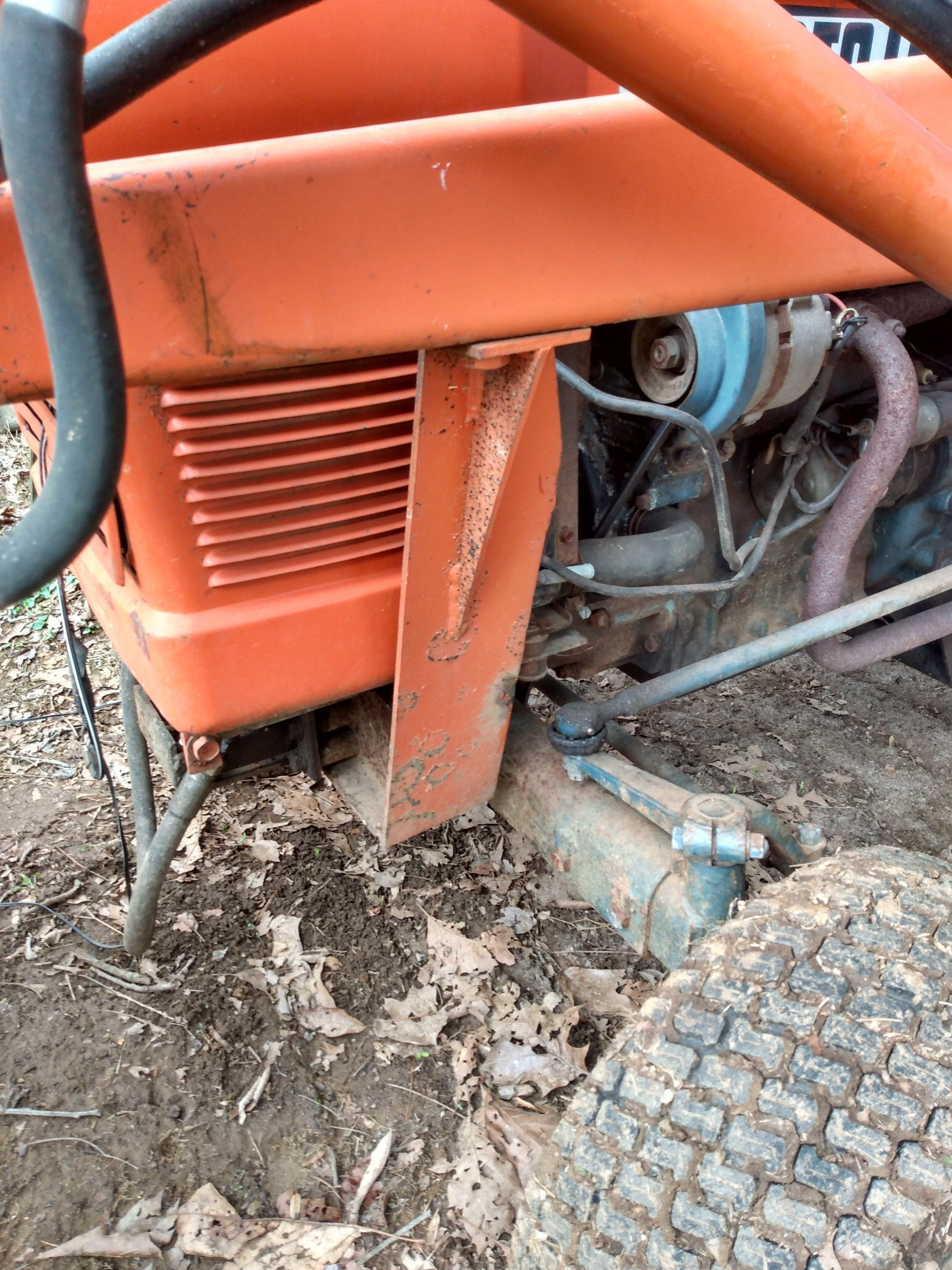

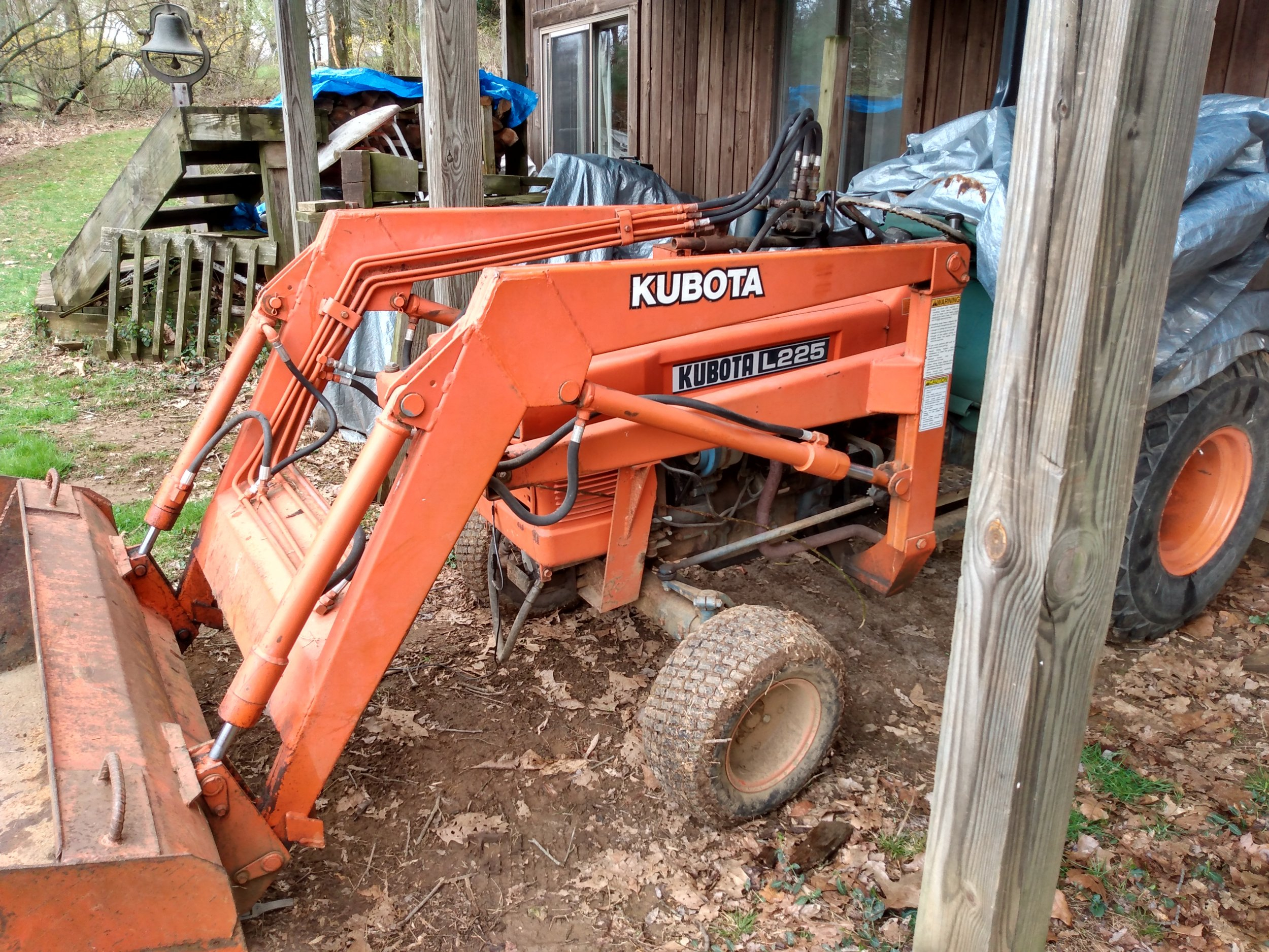

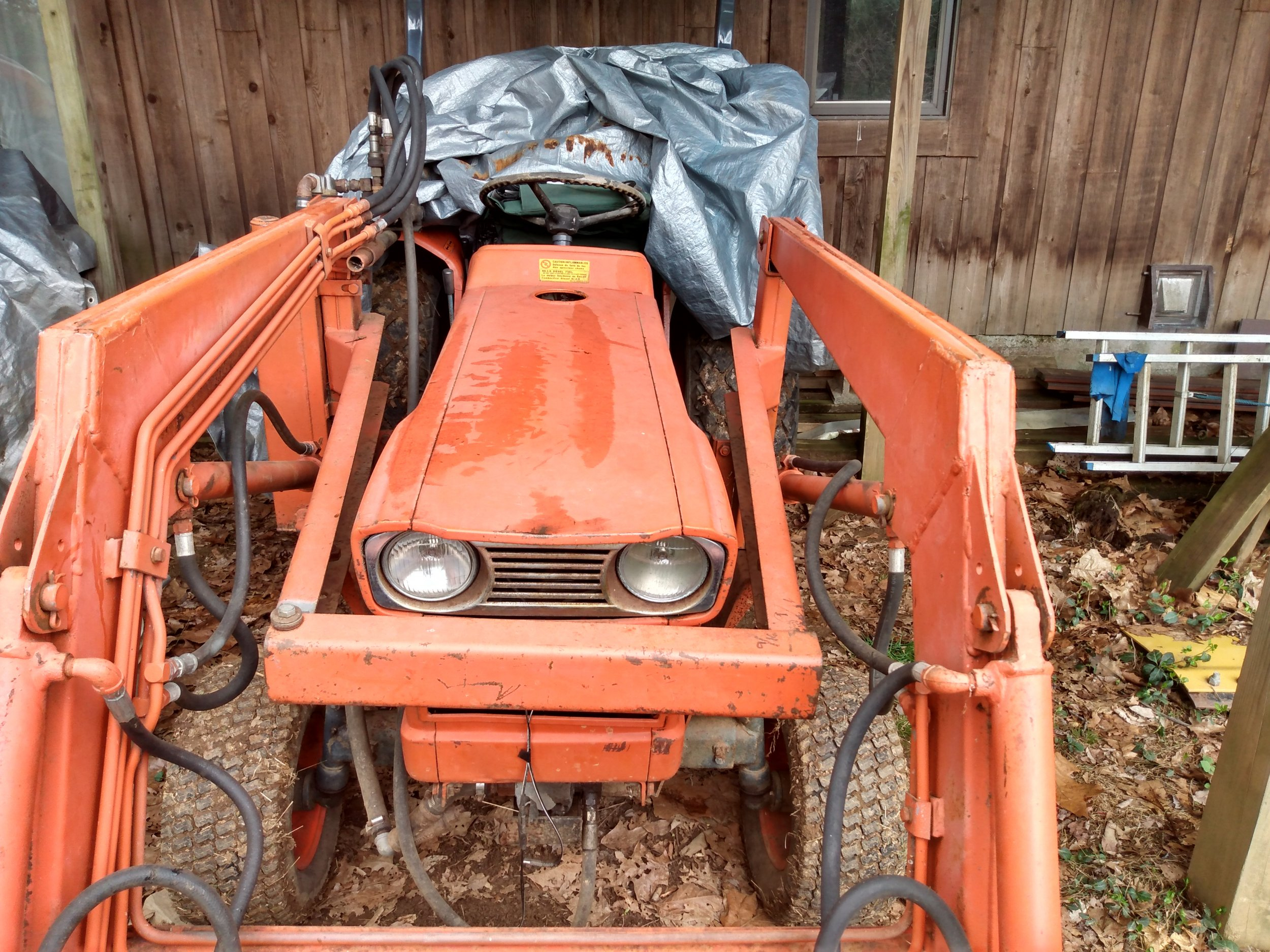

Please help ID this loader. It's mounted to my L-225. Stickers say Kubota but may not be accurate as the whole tractor has been repainted. One of the curl cylinders is leaking so I'd like to rebuild them. For the record, this unit has to use an auxiliary pump mounted to the front of the crankshaft and a remote reservoir because the L-225 hydraulic system is inadequate. I'm sure that it wouldn't require the auxillary parts on a tractor that had strong enough hydraulics.

Appears to be the Kubota L1200 loader.

I researched the L1200 and you are correct. I was able to find a spec sheet and guidance for cylinder disassembly. I was surprised to see that this model was designed for the auxiliary pump an dedicated reservoir. I had assumed it was a previous owners adaptation to make it work on the L225. Still, no model id on my unit. Thanks for your input. It was very helpful.
