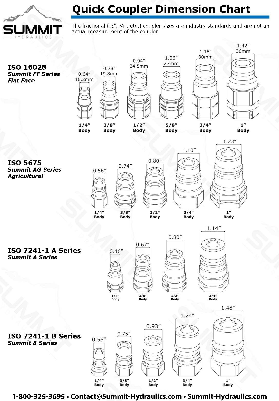

Generally any female QC will have manufacturer/part number embossed on the body... Lacking that consult one of many charts... Can't tell you about hose lengths but generally a ruler plus a bit of extra (inches) will do...

QC is simple 5675 AG couplers. It is the fittings/adapters that thread into the tractor that I cannot find sizes or part numbers for. And yes, the length for hose is easy to measure once the two are mated. But, if someone had the same setup and could let me know ahead of time it would be much easier. Working out of town during week and only have Sundays to work on my stuff. Thanks in advance.

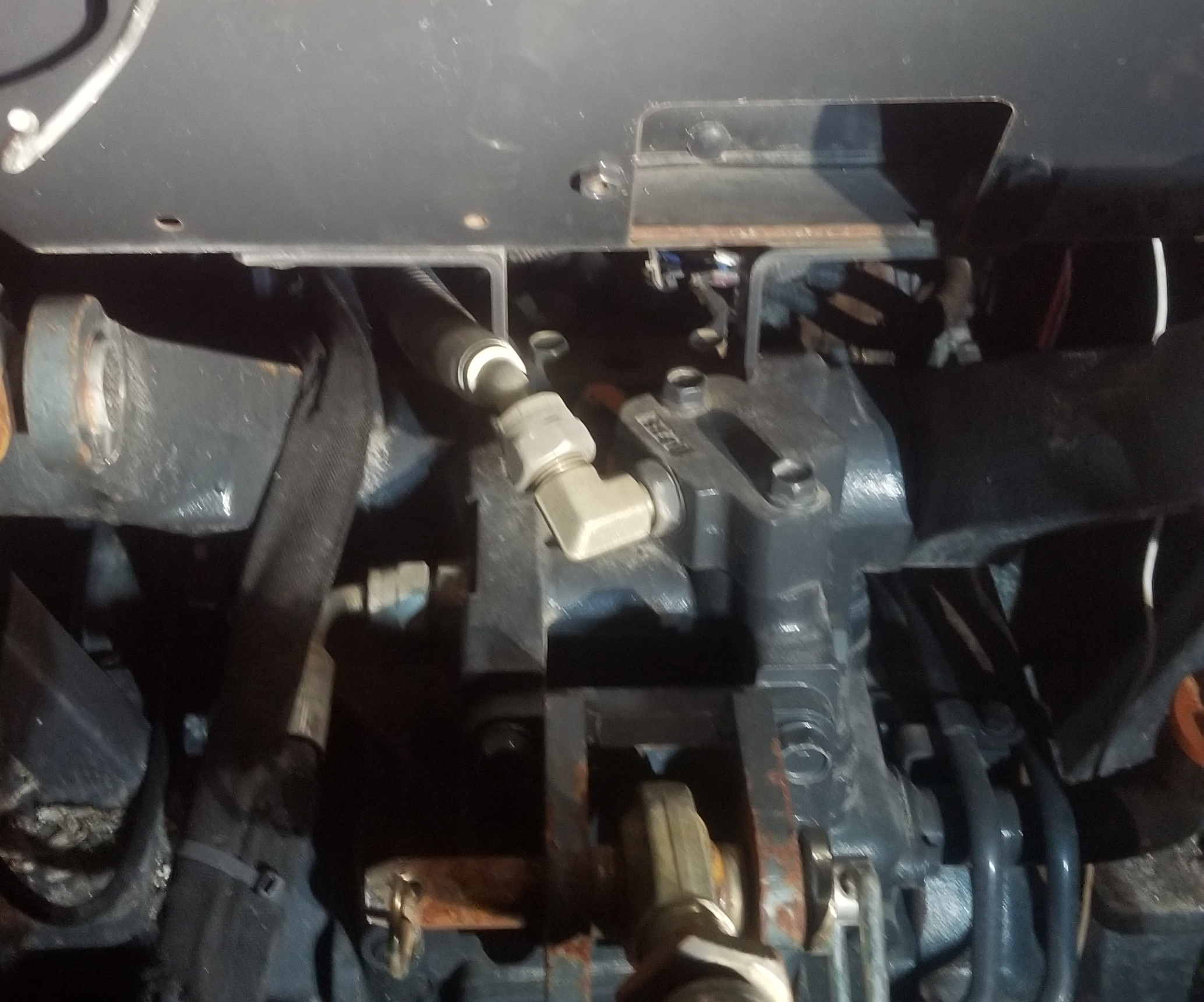

There is a plug on the left hand side of case below rear lift hose. This may be pressure line. With return line further under tractor on left side. Here I also just hab a plug, no hose or fitting. These are the locations on the 3520 of the guy I got backhoe from. Our tractors are identical save for mine not having the rear remote hydraulics.

lower fitting in picture is fitting I need. This is first backhoe hookup. Second fitting is about 2 feet forward of this and on left side of case.
