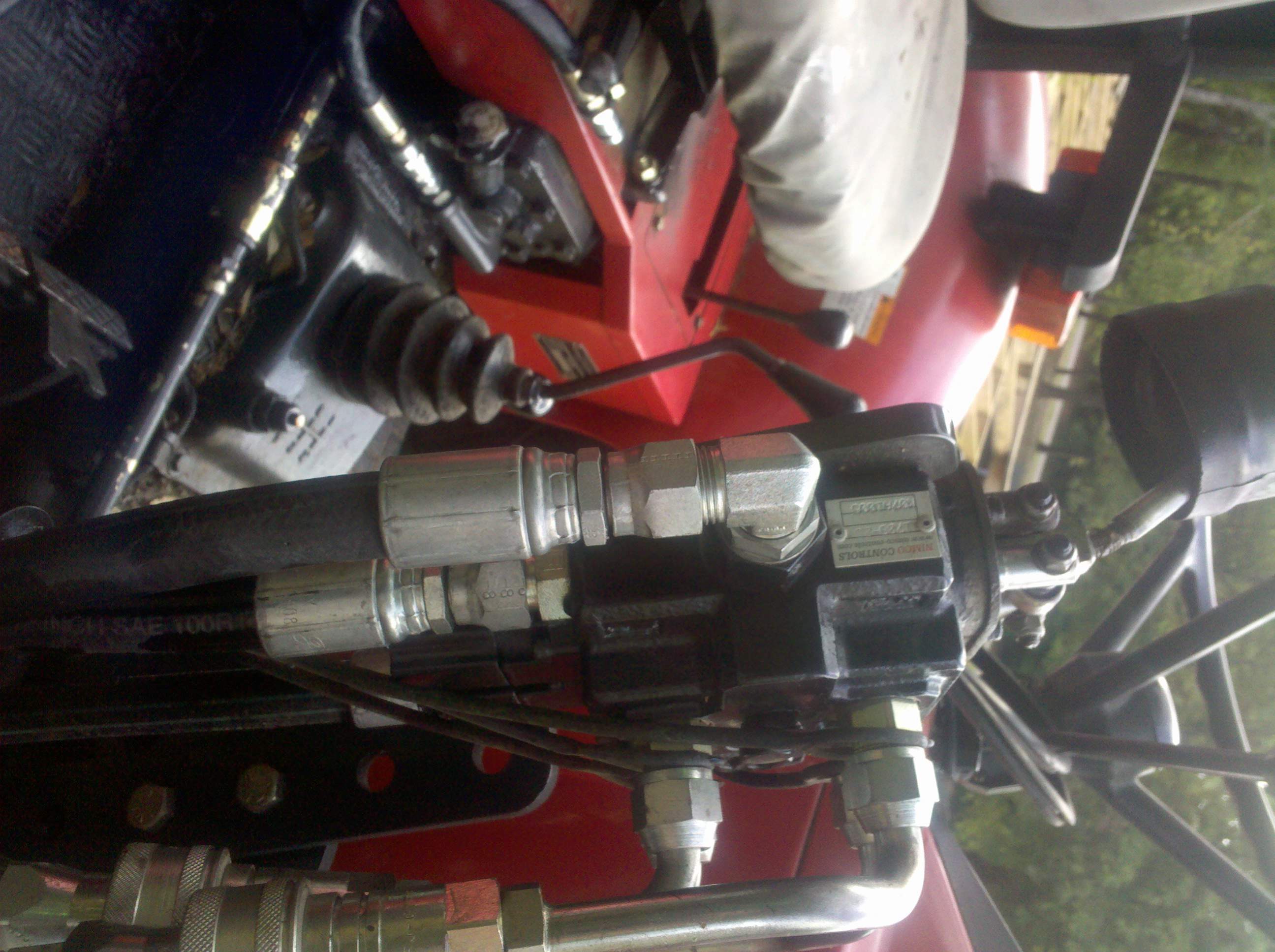

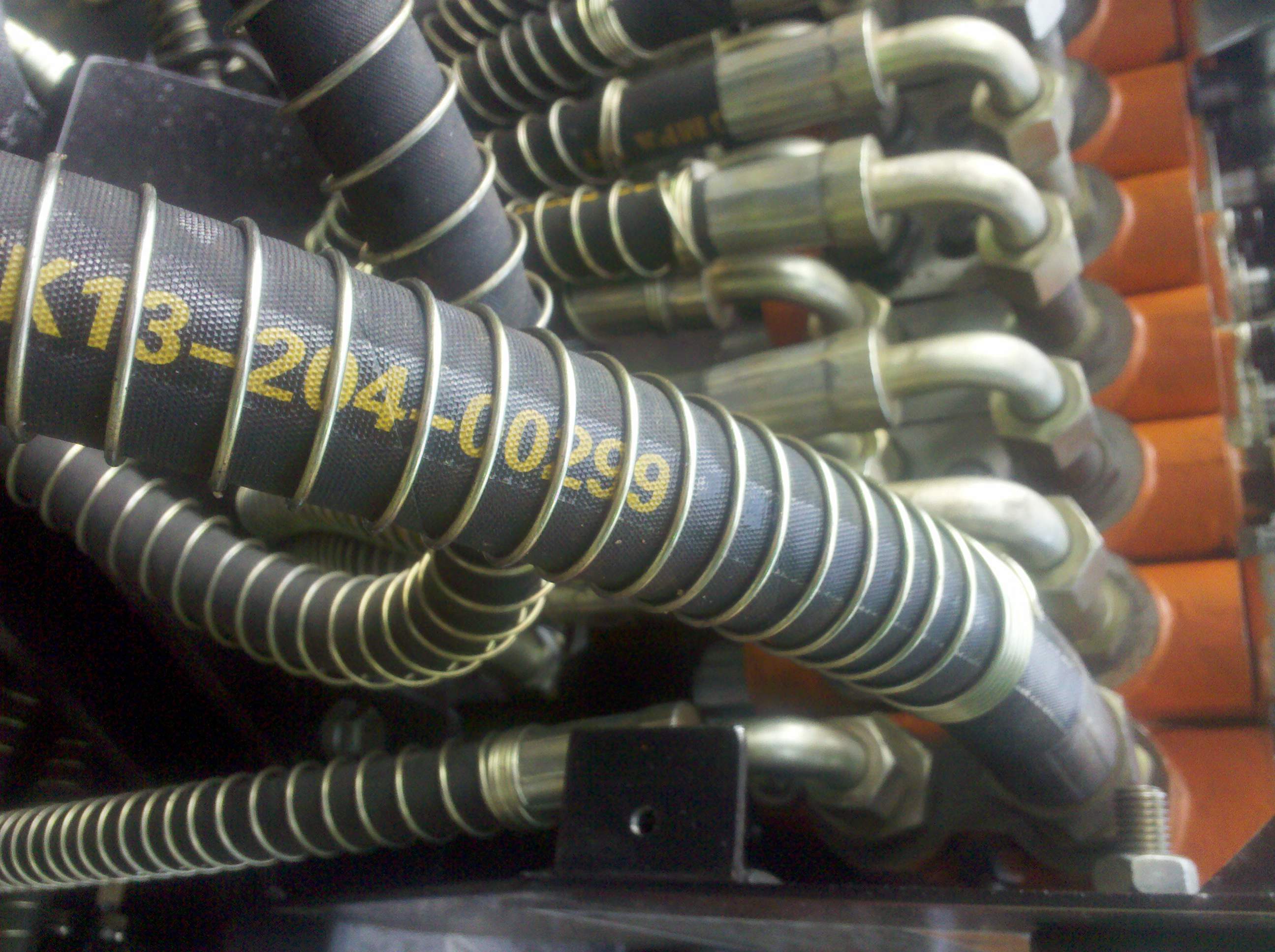

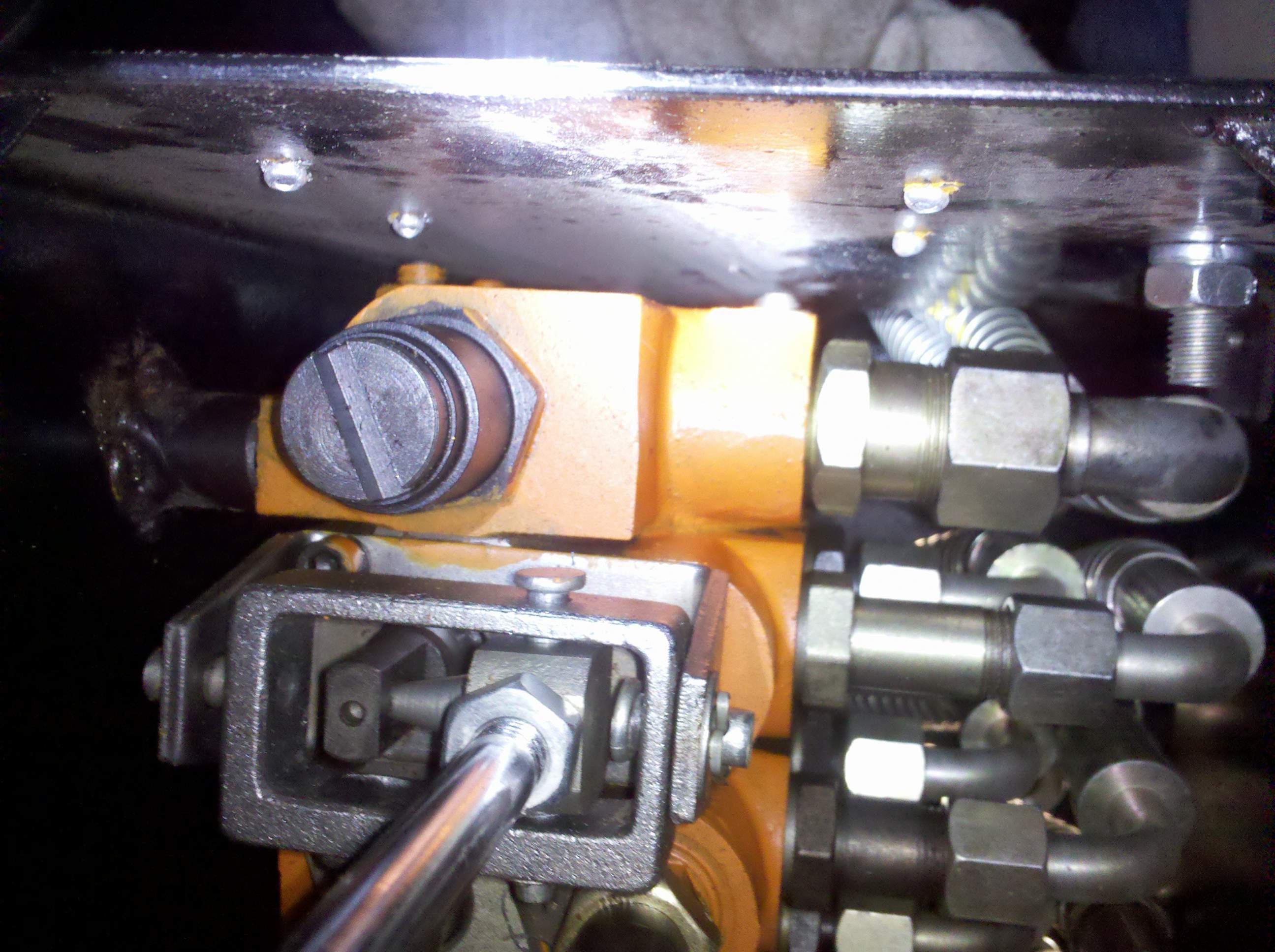

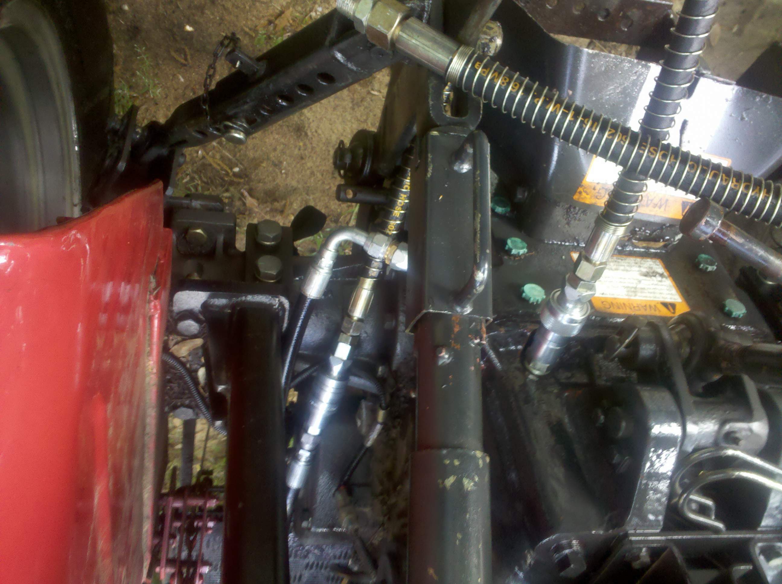

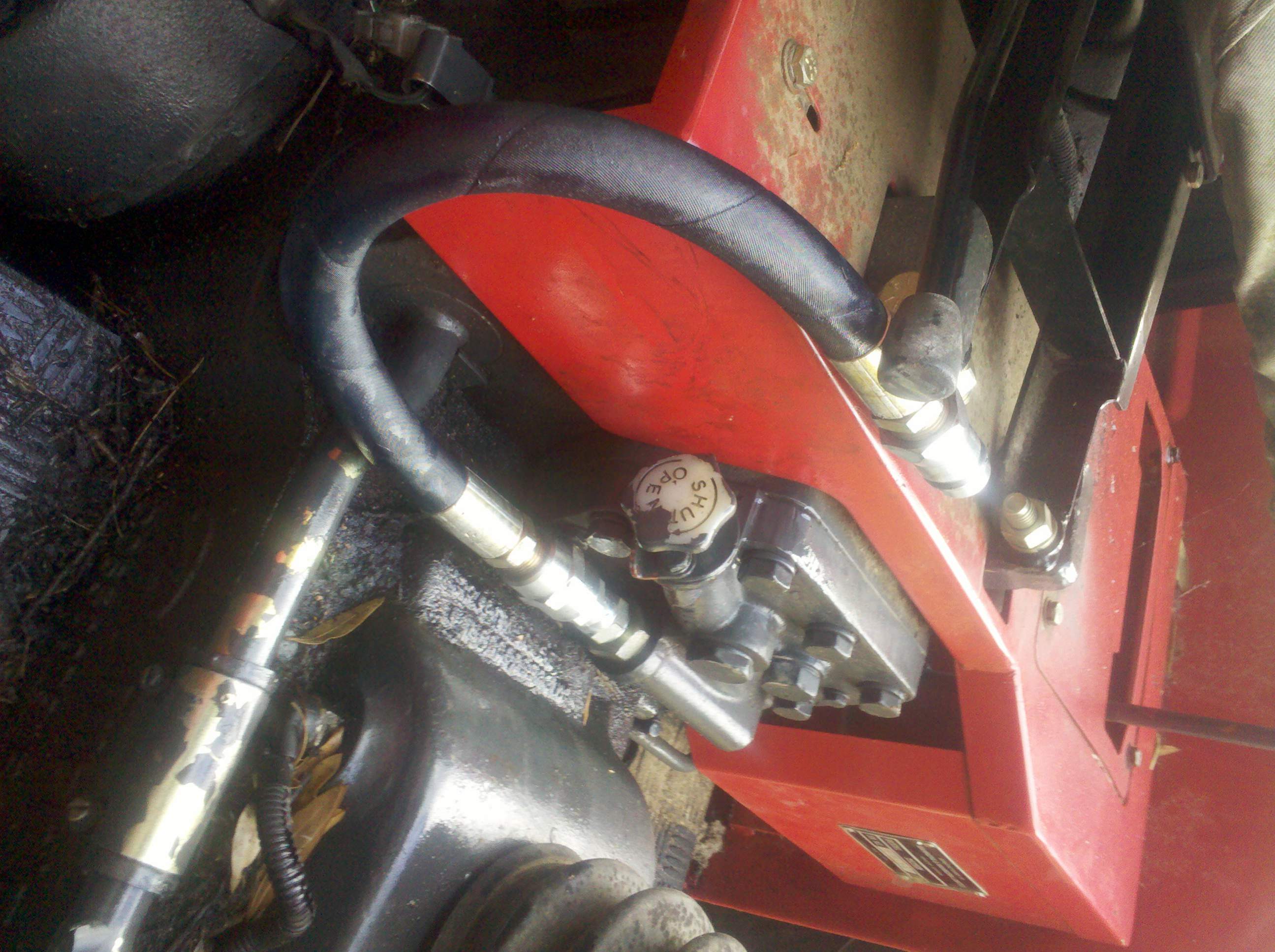

OK we tried what I thought you said but ended up with a blown hose (actually a rigid pipe on the FEL). So then we tried a couple of variations but we either had no pressure or too much. I took some pictures and hope I can communicate which one is what. The 1st is the FEL (you may have to rotate it) The top hose w/elbow is the PB. I unhooked it from the 3pt put a female QD on it (cause I used males on the BH and 3Pt) and ran it to the back of the tractor as my remote. FEL still works fine, 2nd hose on same valve but lower seemes to be the "out" or return and ran to back of tank on tractor. I put female QD on Tank port and male end on this hose (see pic 2). We bypassed the BH tank and connected the new female remote from the FEL PB to the "in" or high pressure supply hose on the BH which is connected to the bottom of the 1st valve on the BH (see pic 3). The "out" or return hose for the BH was connected to the top of the 1st valve (see pic 3) and we ran it to the tank on the tractor bypassing the tank on the BH. To accomplish this. The out or return hose from the FEL was left hanging and the 3pt hitch was disconnected. Result was the BH worked but controls seemed to be backwards or opposite??? and too much pressure on FEL. It would raise but not go down, then blew the rigid pipe. So we Teed the BH & FEL out or return lines together. result was FEL worked better, but BH wouldn't. Then we ran FEL out/return through 3pt and BH out/return through tractor tank. result was nothing worked. So it seems that the 1st way works but just have too much pressure. I noticed the valve on the BH has a slotted control over the out/return hose (see pic 4). Is that a pressure adjustment valve. Are we supossed to adjust that? I feel like we are so close, but I don't want any more hoses to burst! The last picture is just the hose and male QD I put on the 3pt to reconnect to the FEL when the BH is not in use. Thanks in advance for any help you can give us.

Be careful of QD's on any hyd hose, as it will cause a deadhead, and break or blow up things. I suspect a QD was left hanging.
The only way the BH could be getting to much pressure is that your BH may be rated for 2500, and your tractor is rated at 3000 psi.
If there are two hoses, then one hose is the the supply or pressure hose, and it goes to the IN port of the BH valve. Put a tee at the IN port for a hyd gage.
The second hose should go to tank with no QD on it.
If you disconnect the BH with two hoses, then the supply hose goes to the 3pt.
If the BH uses three hoses, one of them is the supply or pressure hose, the second one is the return/tank, and should go to tank.
The third hose is probably BH PB and should go to the 3pt .
If you remove the BH with three hoses, just couple the supply and the BH PB hose together.
Do you have a manual for the BH?
A quick test for the BH would be to just supply a pressure hose and run any other hose to tank unimpeded, no QD's.
All the functions on the BH should work and all fluids from cyl or pump flow is just going to tank.
   / Need help hooking up a 3pt BH to my 3525 Mahindra #8
In your second picture, the female coupling that you put straight into the tank, put a T in before the coupling and attach the original hose that went there, to the T. I think you don't have the return line from the loader valve attached to the tank.
