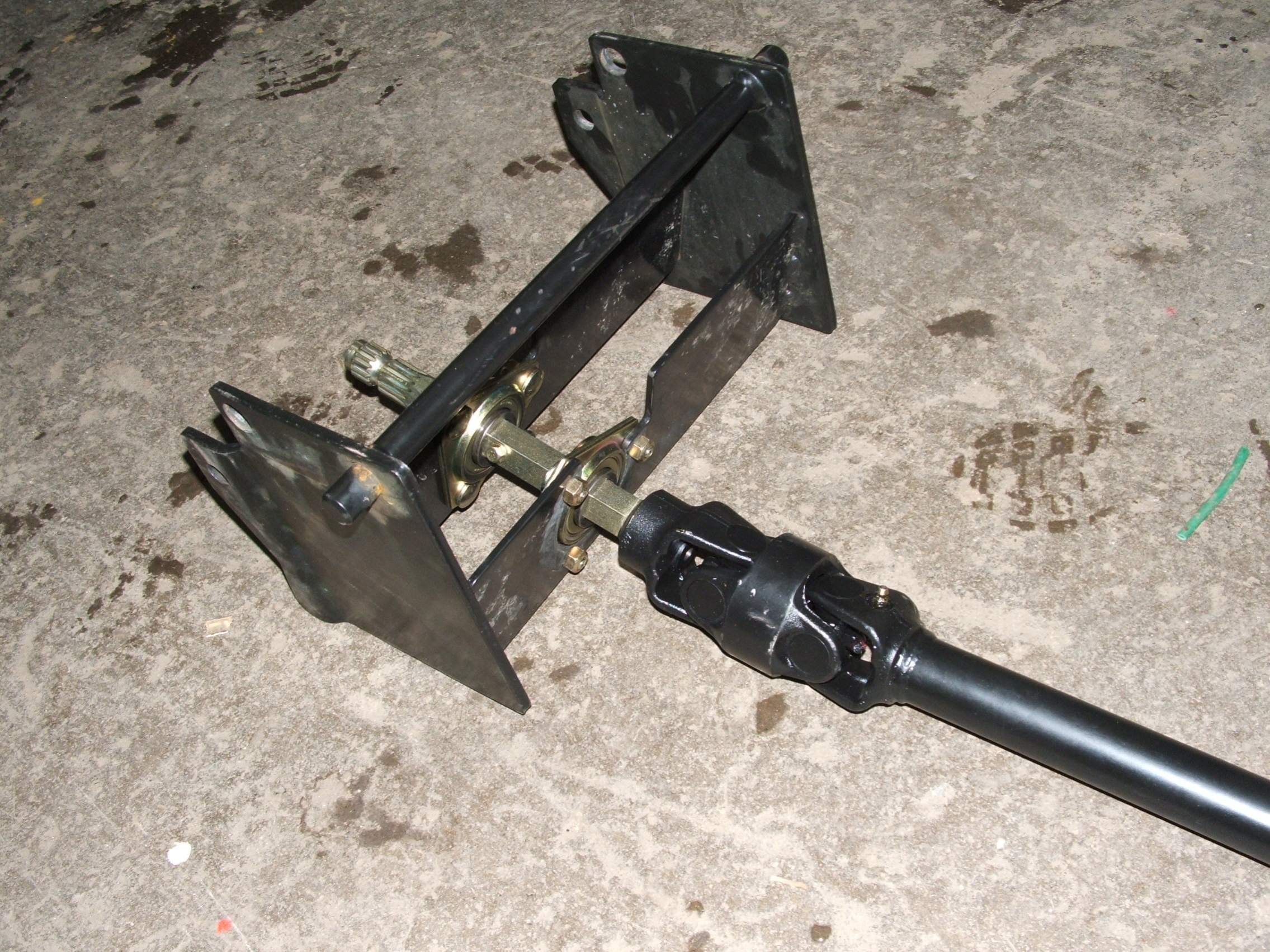

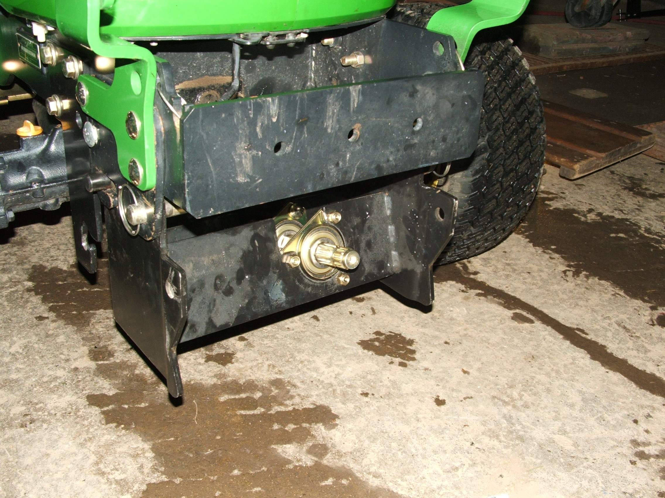

I'm in the process of putting a 47" snowblower from a 420 onto my 2305. I'm making the front adapter and want to make sure that the pto shafts line up correctly. I've ordered my pto shaft but it wont get in for another week and half. Can anyone tell me how far the front pto shaft sticks out past the bracket on the front of the tractor? Thanx!!

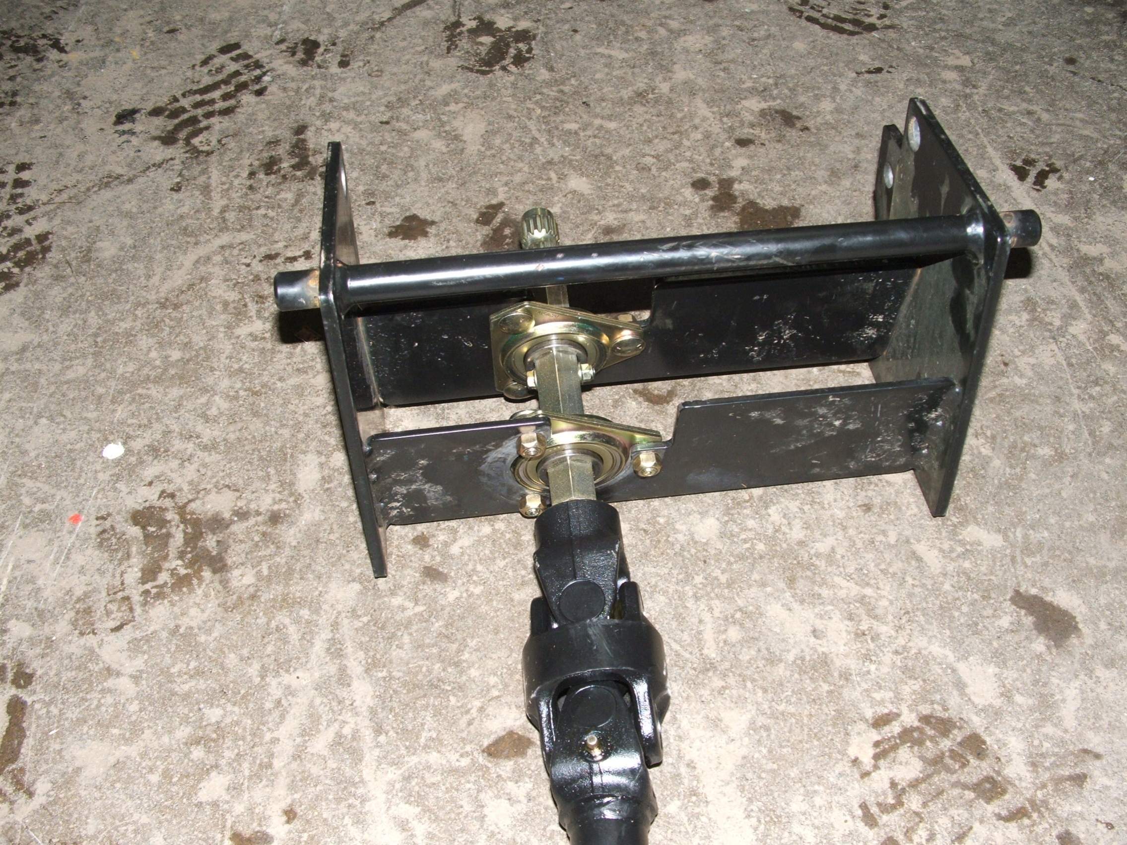

Hi meb9796! Are you making reference to the small shaft in these picture, or the longer one?

Prolly the length of that short stub that "sticks out past the bracket on the front". Good pics.
Does the long shaft have a snap coupler at either or both ends, or does it just slip on at both ends?

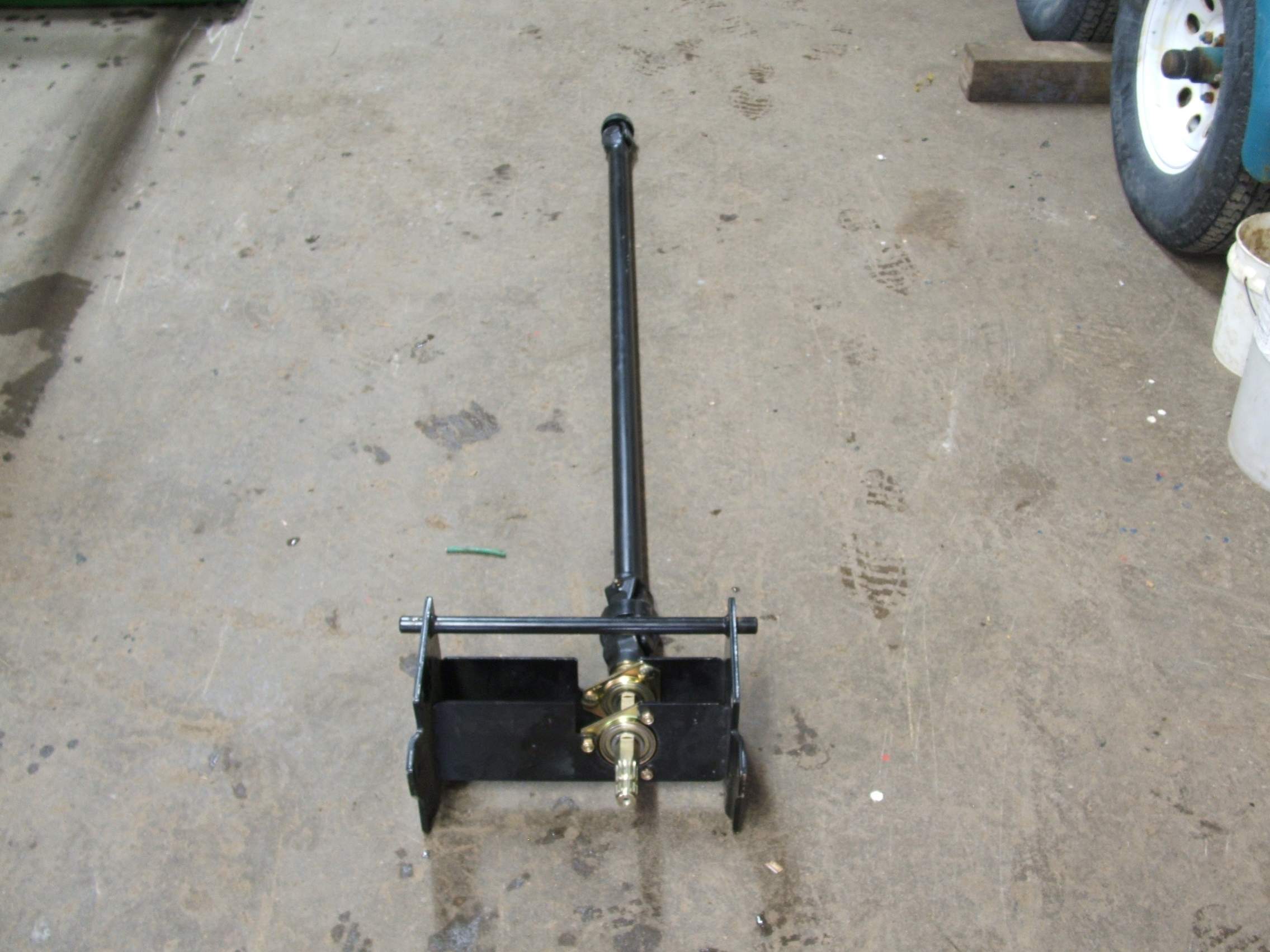

The long shaft have a snap coupling at one end. I can't quite remember if the other end is lock with a roll pin. Will take a run to my garage and get the measurement and the shaft attachment for you. Here's a couple of picture that might help. Henri

Ok, small shaft is sticking out 2 1/8''. Middle groove in the small shaft to the end is 1''. The long shaft and short shaft is all in one welded piece. Keep in mind that this shaft is the retrofit from the old slip shaft that originally came with the 47 inches snow blower. This new shaft, as you can see has a CV joint. Henri
