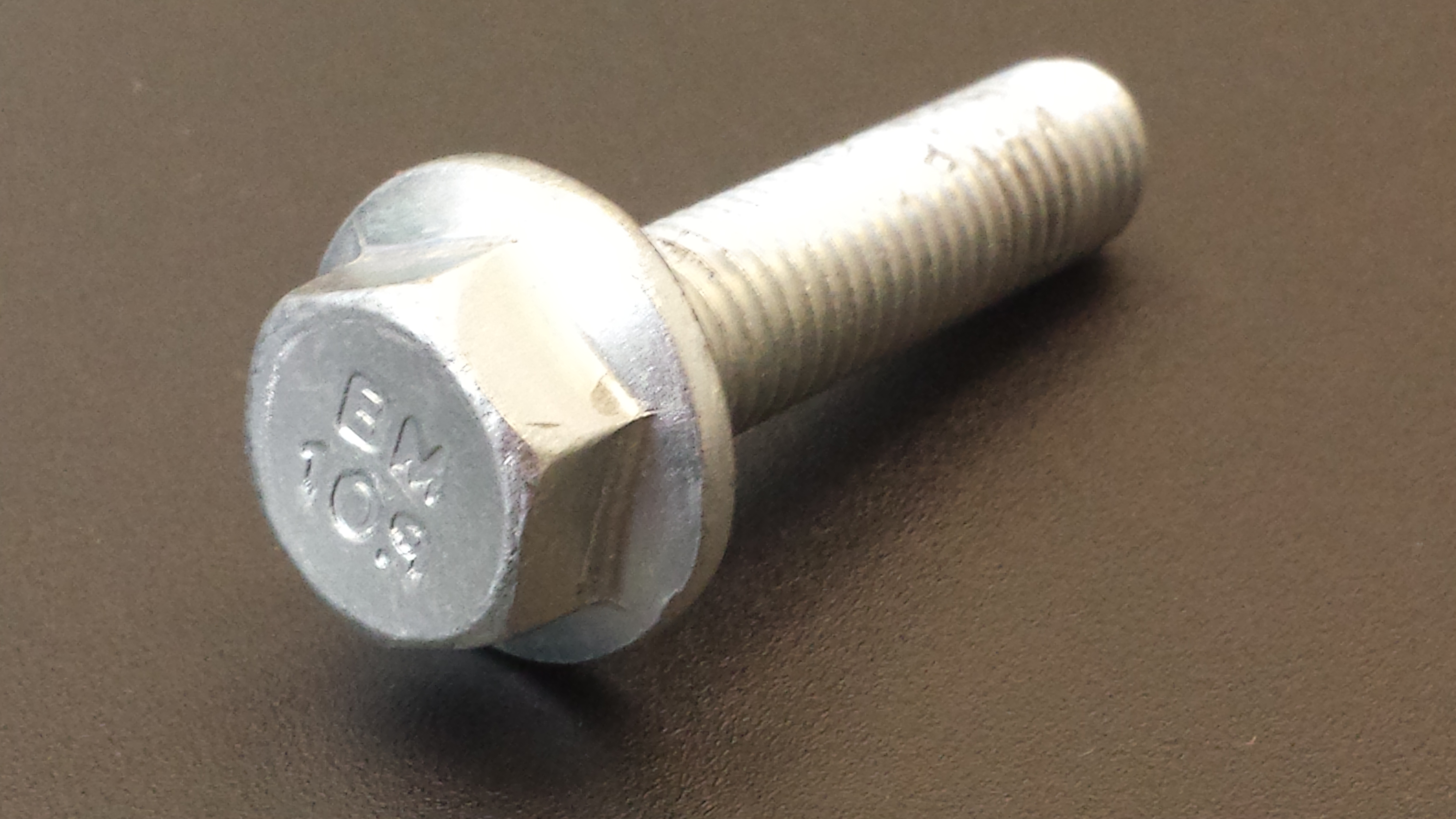

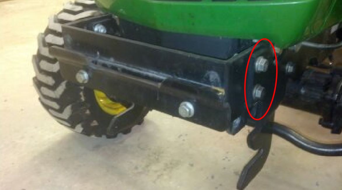

I'm struggling to find this exact bolt from my JD1025R tractor. It's an M12 x 50mm long grade BM10.9 bolt (a 55mm long bolt will also work). In this case, a longer bolt than what came on the tractor is required because I added some accessories that require additional front brackets, and the longer bolt is necessary to sandwich the two accessory brackets onto the frame (see photo of actual application with bolts circled in red).
I'm looking for a JD part number if anyone can help with this.

Your app pic is too blurry to see what your accessory bracket is like, and just curious to what it is...

12X1.75X50 W/ 30 of thread, flanged head, gr 10.9 19m8306
12x1.75x50 w/ 44.7 of thread, flanged head, gr 10.9 19m7814

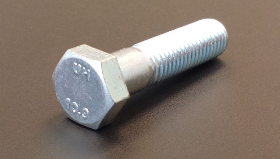

Yup, 19M8306 is the one!!!! Thanks. I had originally thought it was 19M7361 -and ordered (4) of them. But this is what showed up...
Obviously, NOT the Hex Flange Head Cap Screw I wanted!
Thanks MORRISONSTEEL for the CORRECT part numbers for this bolt!
