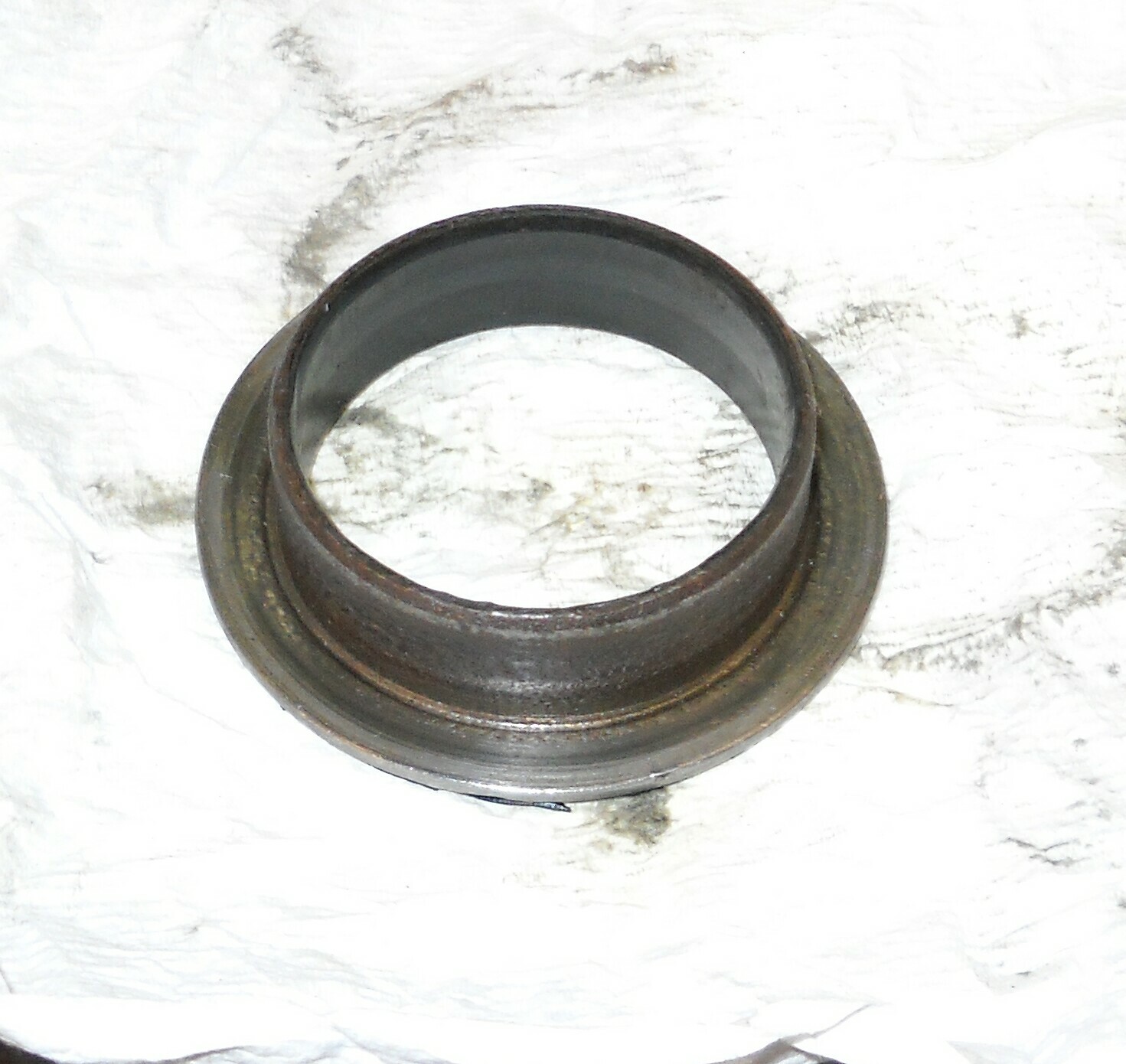

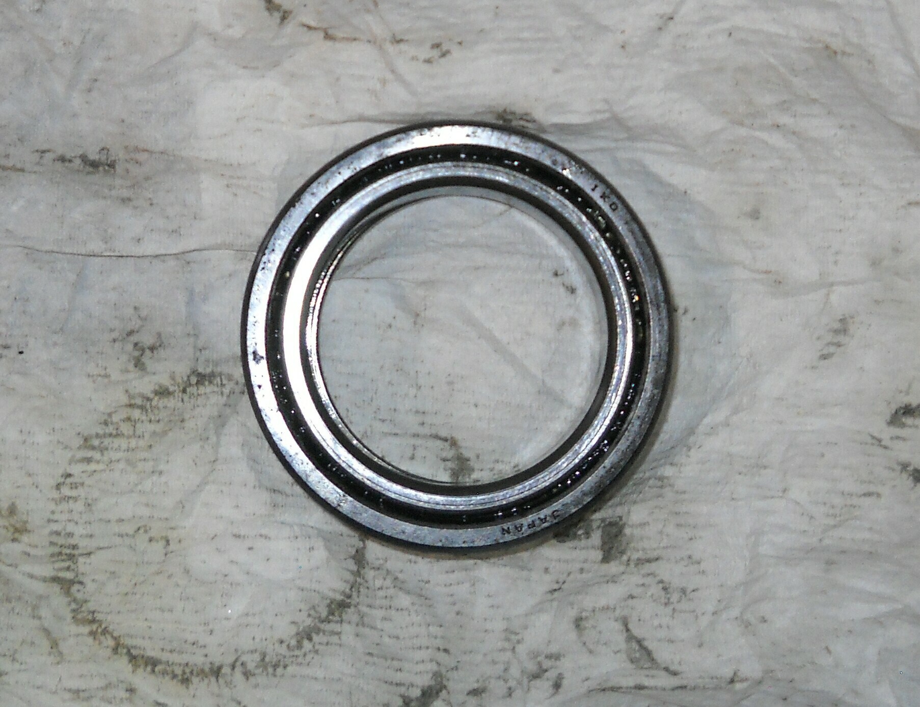

My D-1600 is in the shop. Left rear wheel-hub bearings are shot. Called today and was told two were easy enough to find, but having a very hard time finding the bearing that goes over the shaft at point of entry through the transmission housing (at least that's the one I think is the issue - haven't been in to shop to look at it myself). If all else fails, thinking best way to maybe run one down is pull undamaged bearing from right hub and get a number off of that. The bearing to be replaced is too damaged to lift a number. Local bearing houses drawing a blank.
If any of you guys have been down this road and/or have a D-1600 parts manual and can steer me in the right direction it would be much appreciated. Also having trouble finding some seals but have no specifics on that.

Get some dimensions. ID, OD, and width. Is this just a standard ball bearing? or is it a roller or tapered roller?

That's why you need measurements. Need that to get the common bearing number. The mfg number is going to be all but useless unless going direct to the mfg or dealer.
Give that mfg number to any bearing supply place and the only way they are going to help is if you have dimensions.

He probably already has type and measurements, just can't locate a replacement. Local supply houses here usually pretty good, so it's an odd one. I e-mailed him the bearing supplier links including VBX, and will get him the number for Kamen in Duncan. Hopefully can run one down. Trouble finding a couple of oil seals too. Thanks for the offer DuckSlayer. Wish I had a parts manual in Japanese or any other language, but I don't. Part of the gray market experience. Recurring treasure hunts
Thanks to all. I'll post what we find. Maybe save the the next guy a little time.
