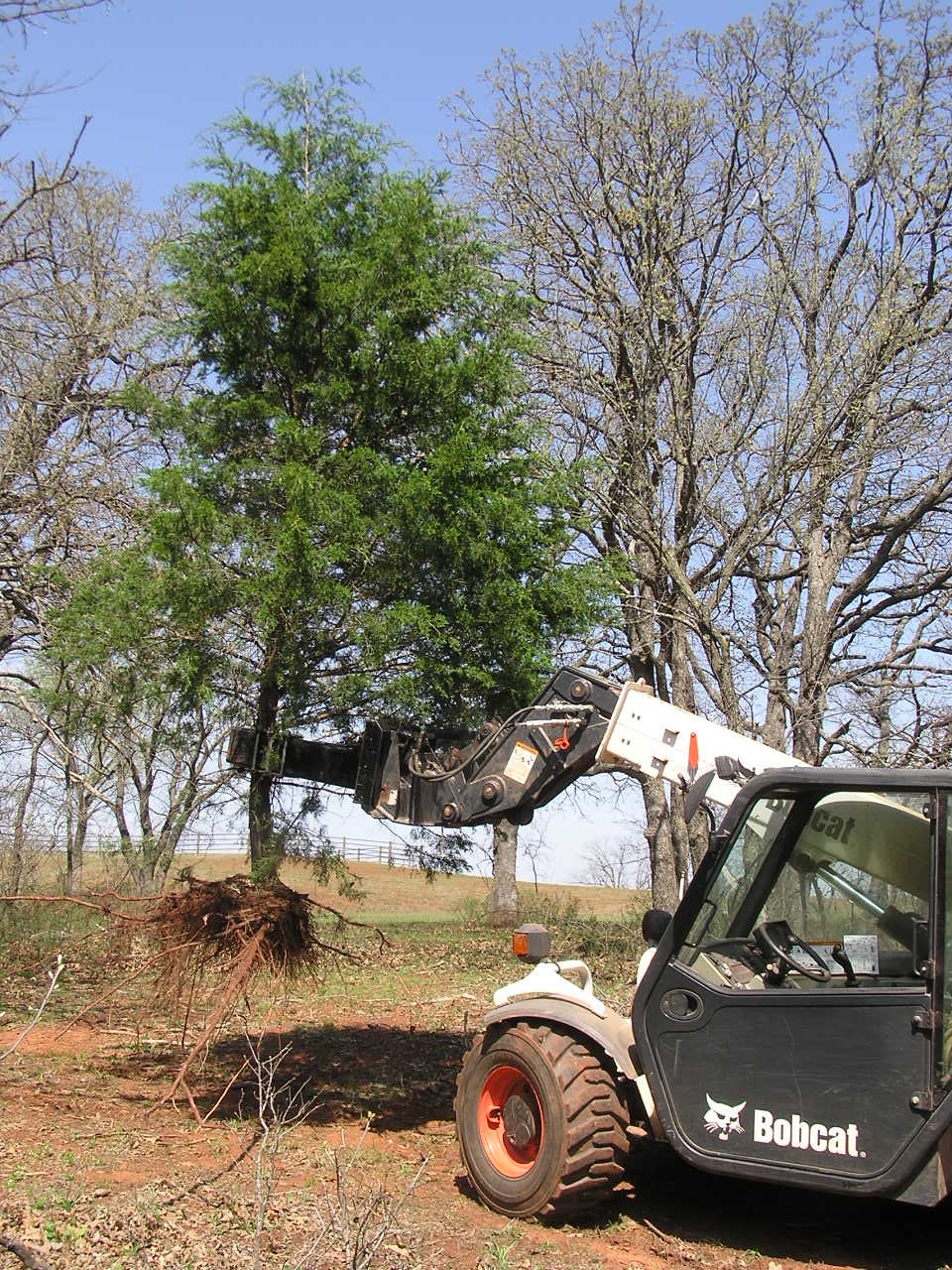

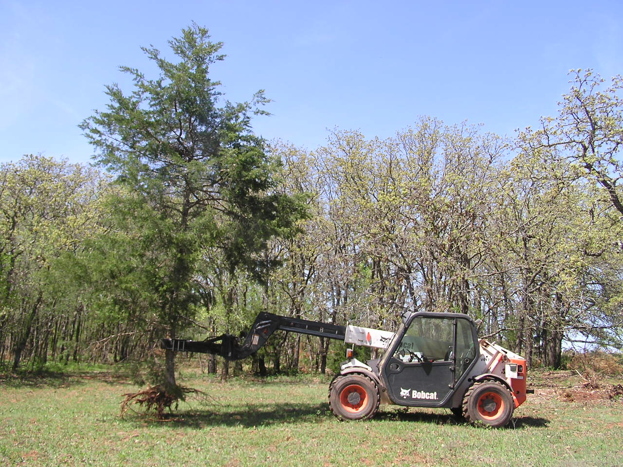

I have a good machine for pulling cedars, and doing much more. Here is a thread with more info: http://www.tractorbynet.com/forums/.../274285-single-tractor-vs-skidsteer-mini.html Also click the second link in my signature.
attachment.php
attachment.php
