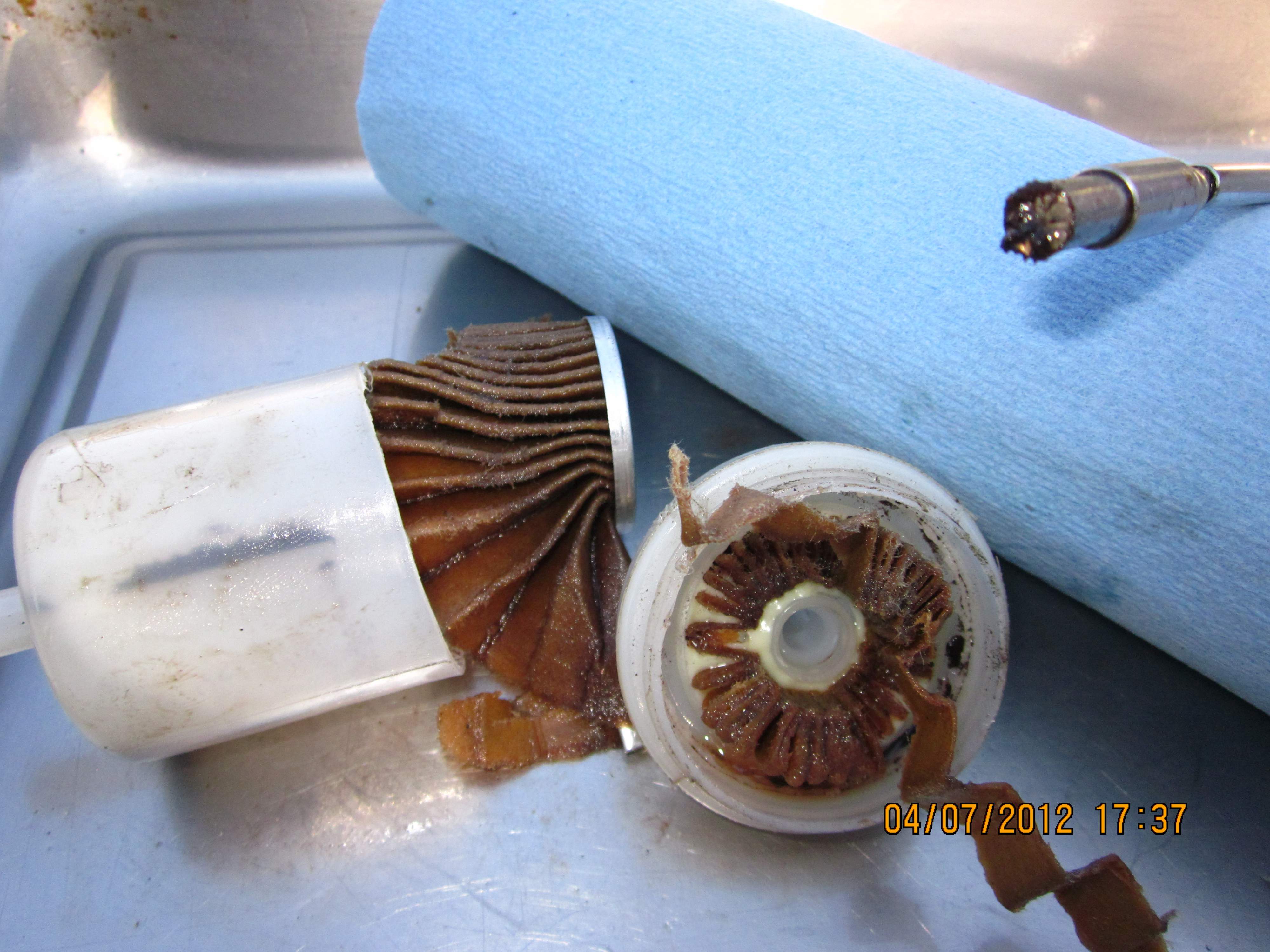

I have that problem when it starts to starve for fuel.
First time I had a plugged tank from the plastic vent holes drilled in fuel containers. http://www.tractorbynet.com/forums/parts-repairs/222566-strain-fuel.html
Second time was a corroded fuel sending unit that plugged tank outlet. Both times I could by some time by putting a plastic bag with rubber band over filler oppening and blowing air pressure from 1st fuel filter (yes the one behind the shields and deck) back into the tank. If you do not hear your fuel pump clicking with ignition on that would be first thing I check.
   / Need Help - BX2660 shaking / running rough #4
When sending unit corroded this is what I found in the filter. Magnetic tipped me off it was sending unit as it is the only metal in tank.

Guys, thanks for your help. I had a lot of crud in the first fuel filter and the tractor seemed to run fine after I swapped filters. I also had a gas tank issue where the nylon mesh filter on the nozzle of the gas tank had been eaten by the diesel and found its way into my fuel. I have sinced purchased a container appropriate for diesel.
I'm hoping for no more surprises. Taking the deck and skid plate off are becoming less and less fun the older I get!
