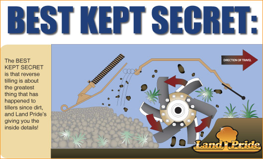

   / Need help buying a hydraulic motor #8
When you are connected the tiller, determine the rotation of the drum by looking at the tines, the cutting edge of the tines. Turn the drum the correct way and notice which direction the input shaft turns. The gear box may have one ratio, and the pulleys have another ratio.
You will also have to consider the mounting plate for the tiller, as to which side to mount it on. Do you want the tiller to fwd till or reverse till.
With a reverse valve, you can select the correct direction.
Typically, fewer passes will be needed with a Reverse Tine Tiller. Forward Rotation Tillers tend to 'walk' on hard ground. Reverse action 'sucks' the tiller into the ground. This tiller buries large clods first, wtih smaller clods falling on top creating a perfect seedbed.
Reverse tilling is also when the tines are turning opposite of the wheel travel direction.
