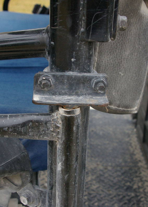

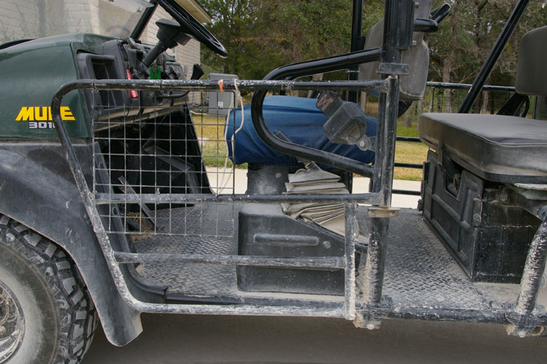

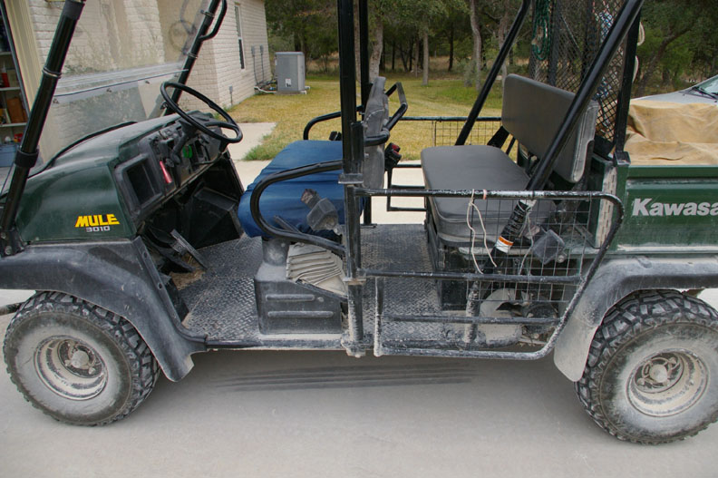

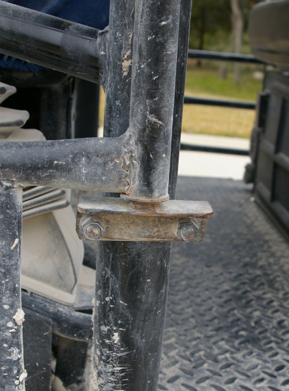

Well, I did build my doors. Guess I took the advice of
well i would just get some material and make some your name says it all . have fun.
Used 1 inch metal conduit to build them. Lots of redneck design, with a little Rube Goldberg and Jerry rig thrown in, but hey, they work. Goats can't climb in the Mule anymore.
I know what you mean, I just bought a new John Deere gator last week. One of my first chores was to replace some tin on the goat barn. loaded up my tools and headed out to the barn. Started work on the barn needed a tool out of the gator there were two goats in the front and one trying to get in the back. So if you come up with a good idea for doors let me know.
If you can use anything from the photos Jwaynejtx, go for it.
Pic 1 shows the door open.
Pic 2 shows the top hinge.
Pic 3 shows the bottom hinge.
Pic 4 shows the door open.
Been using nylon string to tie the the doors open and closed. Anyone with a better idea, please share it. The ties have worked well so have not been in any hurry to come up with a better idea.
