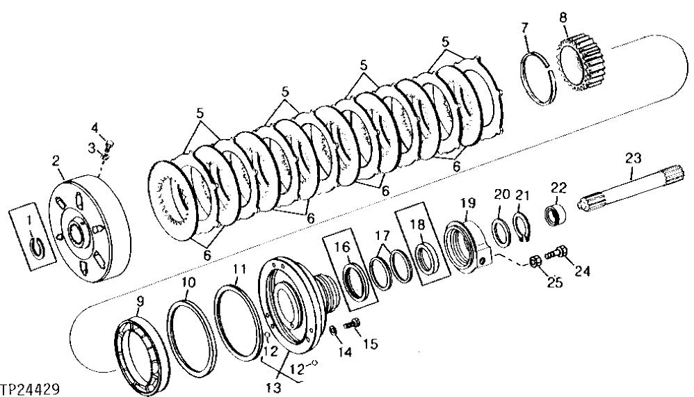

Hey guys, just bought a 450c crawler. I have to replace the steering clutches on both sides of the tractors and i'm having a problem getting them out. Does anyone know how to get the output shaft that runs through the steering clutches out of the tractor. Do i have to take the final drive off like on the 450 or is the 450c different, is there someting i'm missing. Please help guys any info or pictures would be great

Have you a tech manual available?
Have you been on jdparts for a part breakdown, which can be helpful "seeing" what the individual parts look like.

I do not have a manual the nearest place to get one is about two hundred miles away.
