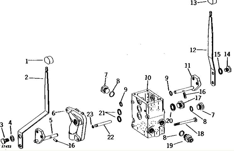

Thanks for the advise. The leak appeared to be coming from the lever for the rear remote. I'm going to check the above suggestions when I get home tonight.
   / Need Help-1520 Hydr Leak #9
jon
Hope it checks out well, and will be an easy fix.
jdparts shows the individual parts, and here is an example...several 0-rings and some referred to as 'packing' #21 and 'sealing washer' #20, and 0-ring #9 and #23 for example.
You can get into jdparts (free registration) and put in the model number to look at various schematics of parts for your 1520 that may help.
Thanks. I went to the JD dealer today and got 2 of the # 21 and 2 of the # 9 rubber gaskets/washers. I am hoping that is what I need. Thanks for the help.
