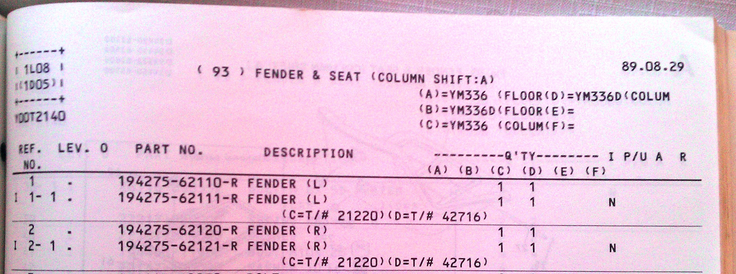

Can you please check your parts manual and tell me the Yanmar part numbers for the large left and right rear fenders of the YM276D? Thank you.
   / Need fender part numbers for YM276D #2
Two numbers on the parts list for both sides. 194275-62110-L, 194275-62111-L for left. 194275-62120-R, 194275-62121-R for right.
Just wondering if they will fit on a YM336D? I have the part numbers from the YM336D parts book, and I want to see if the same fenders were used for both models. If you can look at the YM336D parts manual, they list 2 of the part numbers mentioned above, however, looks like that was a misprint as indicated in the "notes" at the end of that parts section. A little bit confusing. I have a source for a set of used fenders, but they are from a YM276D.

Here is photo from YM336D book. The part numbers are the same as the YM276, however, I am unsure of how to interpret the C=T/# and the D=T/#. I think that the D=T/#42716 means that part applies to serial numbers AFTER 42716 and above. What is the D=T/# mean?
I do not know. However, the top of the page in my photo, refers to "Column Shift". At the beginning of all Yanmar parts manuals, they have a 3 page explanation of the reference letters that occur throughout the book. I was unable to figure out what the C=T/# and D=T/# mean. Maybe you will have better luck figuring out these letter/symbols after looking in your book.
   / Need fender part numbers for YM276D #8
I give up. I did find that the -R suffix stands for red paint. There are other letters for the different colors.
   / Need fender part numbers for YM276D #9
The explanations of A,B,C,D are at the top right of every page.
A=336 FLOOR SHIFT
B=336D FLOOR SHIFT
C=336 COLUMN SHIFT
D=336D COLUMN SHIFT
So D=T/#42716 would be design change at serial number 42716 on a 336 4wd column shift.
The front of the parts book says "N" means new part will fit old & new tractor but old part will not fit newer tractor.

Thank you Aaron at Hoye Tractor Parts for sorting this out. Now, I just have to find out the serial number of that YM276D and whether it was a column or floor shift. Winston, you were definitely on the right track. Could you please post a photo of the page in the YM276 parts book detailing the fenders just like I did above for the YM336D? That will tell me which set of fenders goes with the serial number of those YM276D fenders. Thank you.
