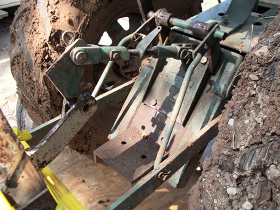

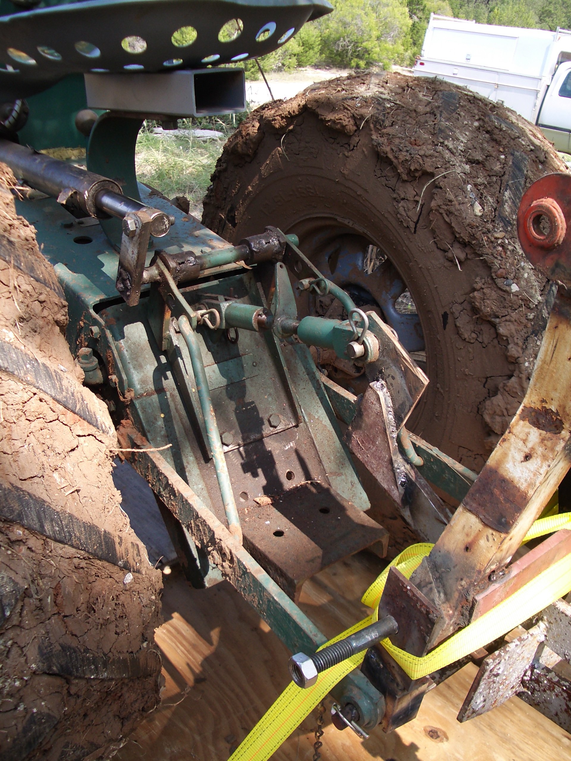

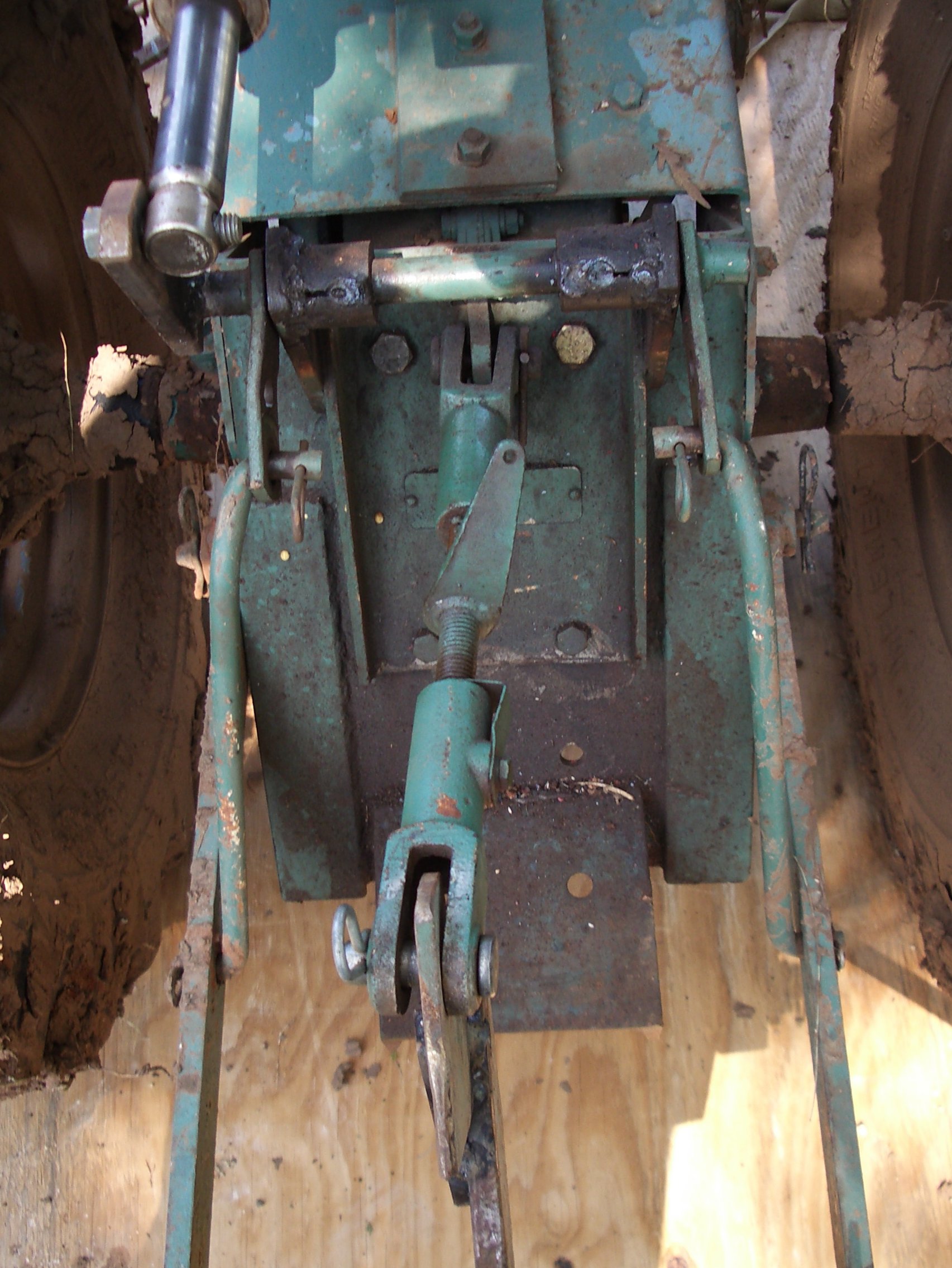

Just picked up an older Sears garden tractor and a 3pt tiller for the tractor. Unfortunately it doesn't have the 3pt hitch attachment. At one time Sears did sell them but they don't anymore. Old guys in the parts department do remember one although the newer type lawn tractors use a pull type tiller.
It did have a manual lever 3pt system to lift the gas driven tiller so looking for a picture or drawings of how it worked.

I need the whole set up if possible, how it hooks up to the tractor and the tiller. Looks like there is one plate on the tiller with an upper rod on the tractor with handle on it for lifting the three point to the tiller. Only not sure how it all works.
   / Need drawings for Cat 0 3pt hitch #5
Maybe these will help. The only difference is the manual handle has been cut off on the right.

How long are the lower arms from the farthest end to the center of the joining shaft?
What is the width between the lower arms?
What is the distance between centers of the lower arm shaft to the upper lifting shaft?
For the third point of the hitch is that the stock location where it attaches to the tractor?
Oh yes, an important question is with a manual lift how is the handle locked in in the up position??
I gather your motor has a down drive shaft how does it drive the hydraulic pump?
What hp is your tractor just curious my little 13hp might not be able to power a pump. Although the 13hp tractor is the same size as the 17.5hp tractor so there might be a motor up grade in the future.

Lower arms are 18" between outer holes with lift hole being centered. Lift rods are 10"long with a bend 2" from lift arm and those are 4 1/2" from cross shaft to lift rod hole. Top rod tab is just below cross shaft.
There is no hydraulics hooked up yet. What you see is a linear actuator from a wheel chair lift.

Is the actuator strong enough for heavier attachments? My tiller is about 200#s for sure I gather your actuator will handle it.
All I basically need now is how the handle locks into place once the lift has been completed.
