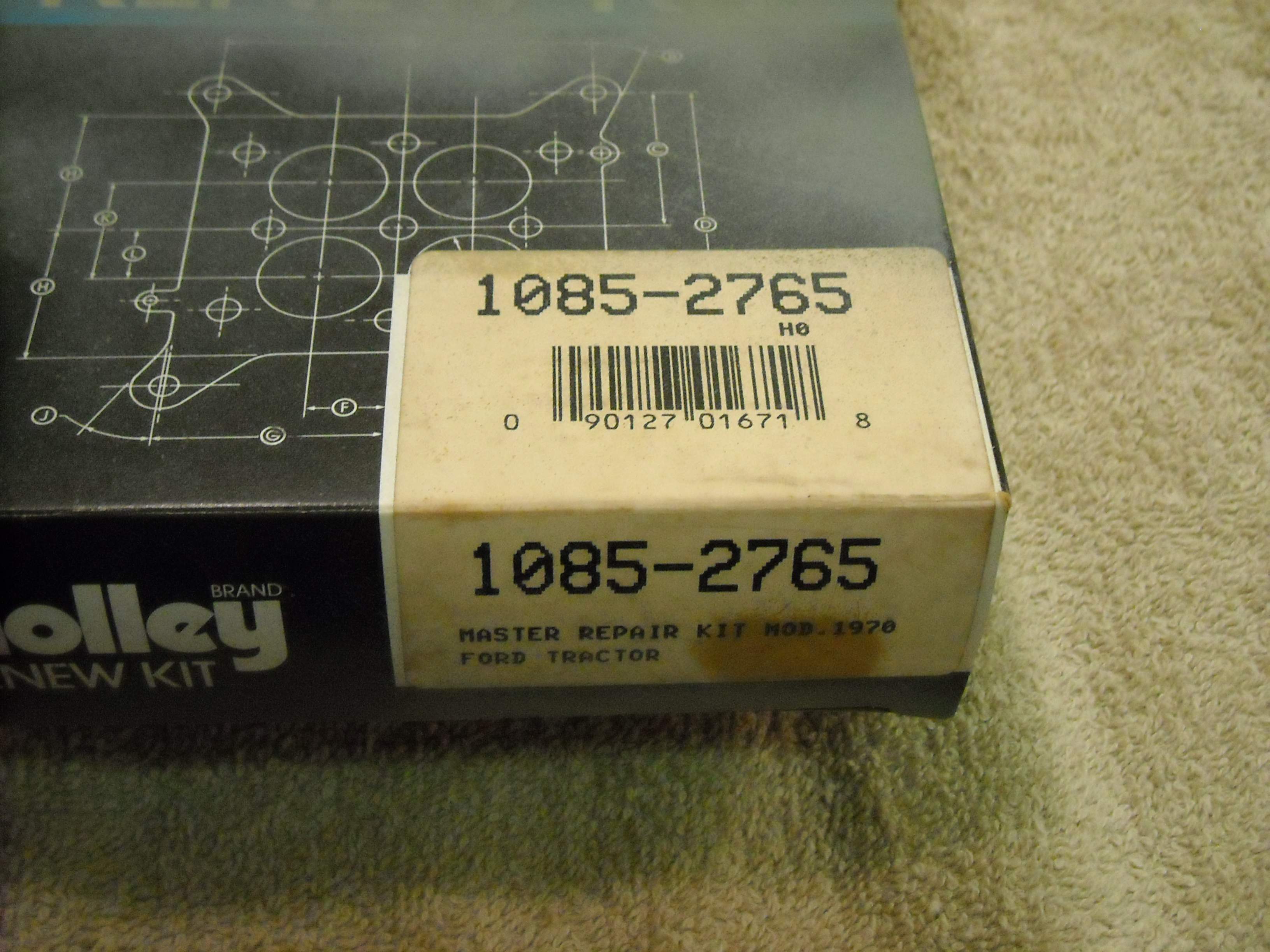

I have had a 5000 gas tractor for nearly 30 yrs and the carb needs rebuilt again. I bought a rebuild kit 25 years ago made by Holley and I saved the box just so I could get another in the future but that part # is obsolete now. The 5000 carb is different than the 2,3 and 4000. Some suppliers list a kit for 2-5000 but when I bought the kit 25 yrs ago the 5000 had it's own kit that was different from the rest. Does anyone out there know of a source ? Thanks for any info. Dave :begging:

027.jpg027.jpg I have tried to attach a picture of the original Holley kit box from 25 years ago. The # of the Holley kit is 1085-2765. I called several places that sell Holley kits and that number is no longer good. I have Googeled it also without success. It's like the kit never existed but I still have the box to prove it. Dave

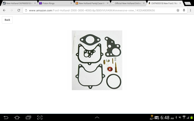

The part number from Ford New Holland for the 5000 kit, CKPN9591B, shows still available through New Holland dealers. That same number shows online as replacing all Holley kits, 3 and 4 cylinder, and shows both bowl gaskets in the kit. Is there something that might not be in that kit?

I guess thats possible. I did not even check the NH dealer for a kit because when I bought the first rebuild kit 25 yrs. ago there was no kit available at the tractor dealer. They had them for a 2,3 and 4000 but not the 5000. Anyway, I wound up ordering a kit from the place in Canada where another member recomended which is the same kit as the 2,3, 4000 and I guess I will find out shortly if it has the necessary parts to rebuild my carb or not. Thanks for the heads up on NH having a kit. I will check it out. Dave
