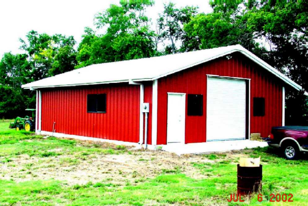

I agree with Inspector507. Harvey has come up with a great way to build you own. But if you want a complete bolt up kit, try Mueller, Inc. - Steel Buildings and Metal Roofing
Mine is not a horse barn, but it is a Mueller bolt up kit. 30'x40'x10'

I've been needing to build a bigger shop building and didn't know about Mueller until seen your post. You have an impressive looking bldg. (I'm planning a kitchen and bathroom also) The prices on their website didn't look too unreasonable either. I'm looking at 30-40-12 or 30-50-12. If you don't mind...could you give me some insight as to the ease of putting it together; did everything fit; quality of materials; and your overall pros and cons.
Thanks, Ralph
   / NEED BOLT UP METAL BLDG KIT IN TEXAS? #7
Ralph - I was pleased with Mueller and the resulting building. I had a couple things that did not fit up right. But a phone call to Mueller and they quickly made it right.
As far as ease of putting it up, not bad at all. I had help putting up the frame and putting the roof panels on. Otherwise, I did it all myself. Although it would have been much faster to have had help with the entire process.
The key is to start off with a square slab. I measured and re-measured the forms before they poured the slab.
If you want more info, PM me and I will go into more detail.
