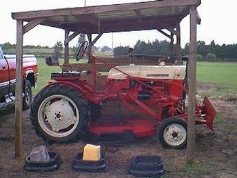

Sounds like you are on the right track in your thinking.. However.. too bad your cub didn't come with a few more implements. The cub totes a 'which way' 1 bottom plow, or a disc plow, as well as a 5' sickle bar mower.. or a 44"? belly mower. They can have front snow blades as well as engine driven hyds. 3pt would have to be an add on.. but with fast hitch and onboard hyds.. you got lots of options.
I mow a couple acers of fence and right of way with my 66 cub. It has an IH belly mower and a front blade, has hyd's as well. It's an absolute pleasure to drive.
Soundguy
