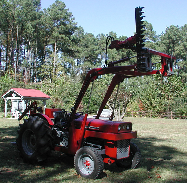

Presently I am operating a 4 ft vertical sickle bar attachment to the bucket. The 10 gpm rated motor is connected to the 3PT selector valve. I have to select either the 3PT or the sickle bar motor, and of course when I choose the bar, the 3PT goes into pumping mode and keeps the 3PT up. The speed of the motor is controlled by the draft lever. The onboard pump is about 4 gpm. In this configuration, in terms of speed, it does an acceptable job, not great but okay.
The loader is operated by a 7.2 gpm PTO pump. At the time when I connected the sickle motor to the 3 PT selector, I did not have a PB on the loader valve. Now I do and here is my question.
If I would connect the sickle bar to the PB and using a motor control valve, would I get a better performance? (More fluid going to the motor?). When the sickle bar would be running, the loader would pretty much stay in in one position, so most of the fluid should go to the sickle bar motor. Am I off making this assumption?

Yes, you are correct.
When the loader is in neutral, the loader bucket should stay where you left it.
Is it your primary intent to run the sickle bar mower at a faster speed?
However if you use the loader for up/down to trim, the hyd motor will slow down.
If you plugged your sickle bar valve in the PB port of the loader valve, the sickle bar motor would run much faster if using all the PTO flow.
If your valve is a friction type [ stays where you leave it ]motor spool valve, then the sickle bar motor will run at the flow provided by the motor valve.
You could use this variable speed type valve and let the excess flow go to tank or to 3pt.

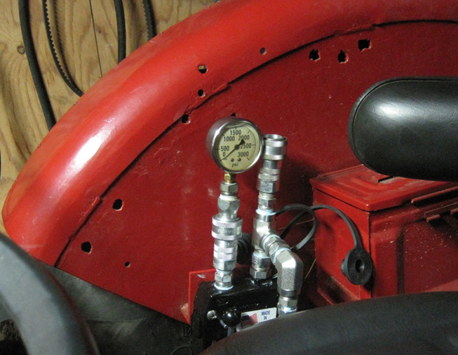

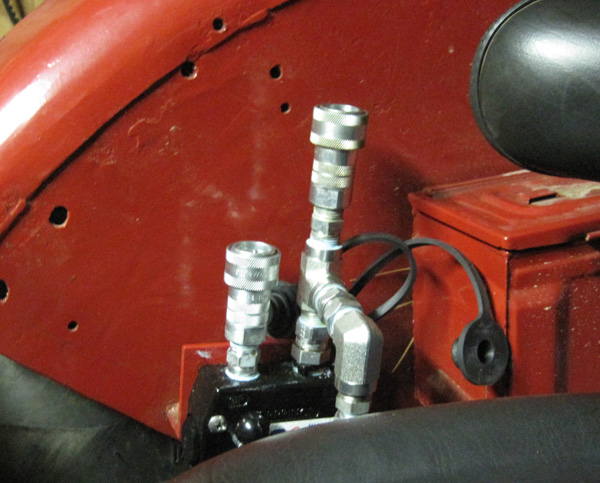

Few days later…….after finishing all the trim work, I removed the sickle bar and disconnected the QDs from the tractor.
Strange thing is happening. With the male QDs out and the control valve in off position, the safety valve of the control valve kicks in and squeals. When I put a test gauge (with a male QD) on one the ports there is no squealing and there is no pressure on the gauge as it is supposed to be.
Right now I left the gauge on the valve, so I can use the tractor, but what’s going on?
Is it a defective QD, or control valve, or lines need purging. I am incline to believe it is the QD, but I am not really sure.
Ideas?
   / Need an expert hydraulic opinion. #8
From your post. I can't tell what you are doing or have done.
Sounds like you closed off the flow and the relief valve is screaming.
Explain in detail what you have done from installing to removing the sickle bar mower.
Maybe pictures.
If you want to read pressure, you need to be on the pressure side. A tee in the IN port of the first valve.
Or a work port that you can supply hyd too.

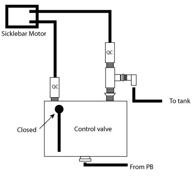

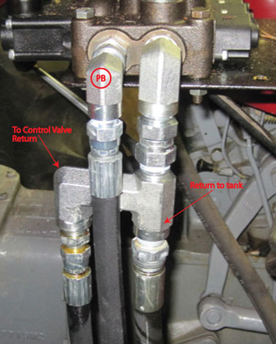

#9
J.J.
In removing the sickle bar, the only thing I did is disconnect the QDs from the control valve. When the valve is off, shouldn't the fluid be bypassed to the tank? But yet, it squeals.
What baffles me is that the squeal disappears when I insert a test gauge in the left QD.
As I mentioned above, when connected, the sickle bar setup worked great.

   / Need an expert hydraulic opinion. #10
With a blocked flow path on the CF, the relief will surely activate.
In the off position, there should be no fluid to the CF port, therefore no pressure.
Is the excess flow really going to tank.
You might try a short hose to jumper for the two QD's.
The EF has no relief.
