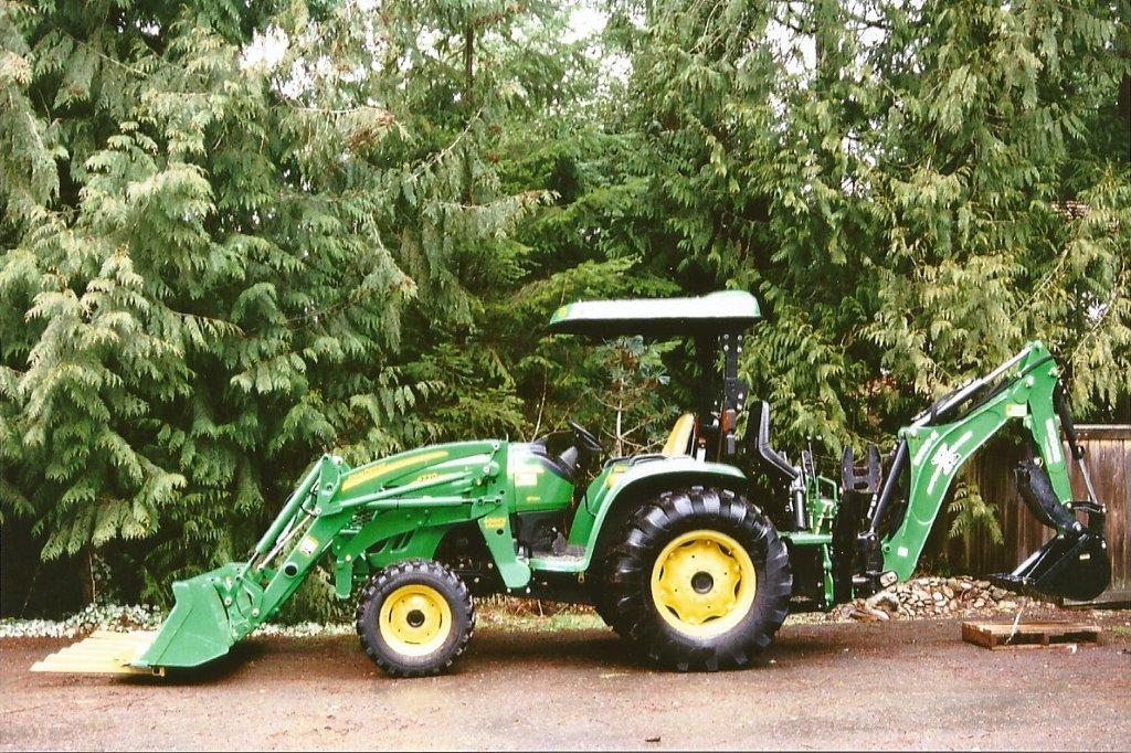

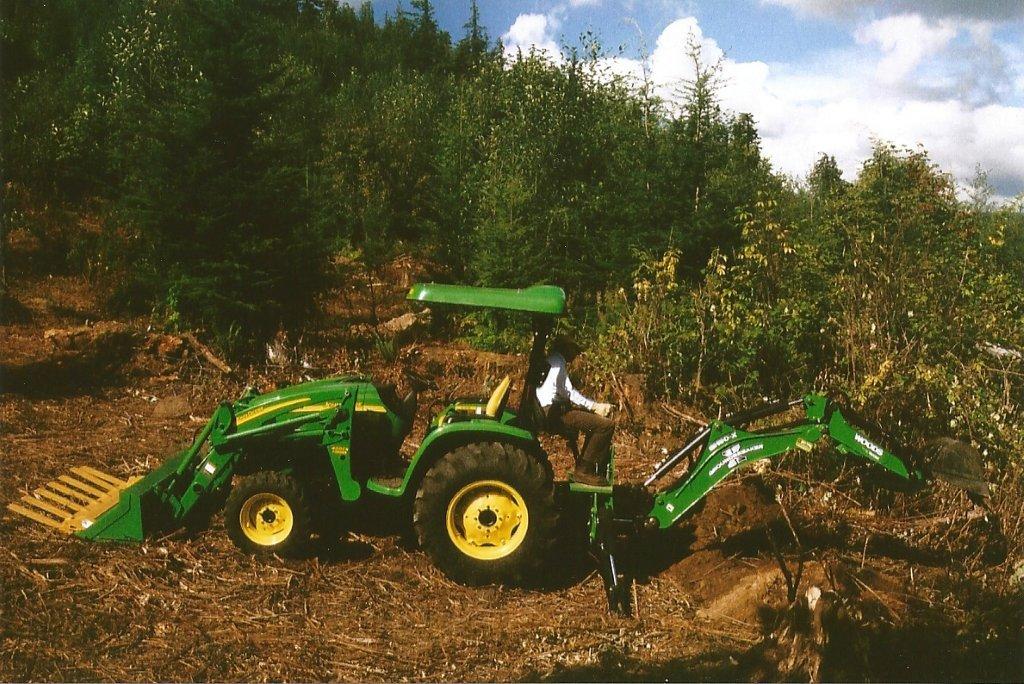

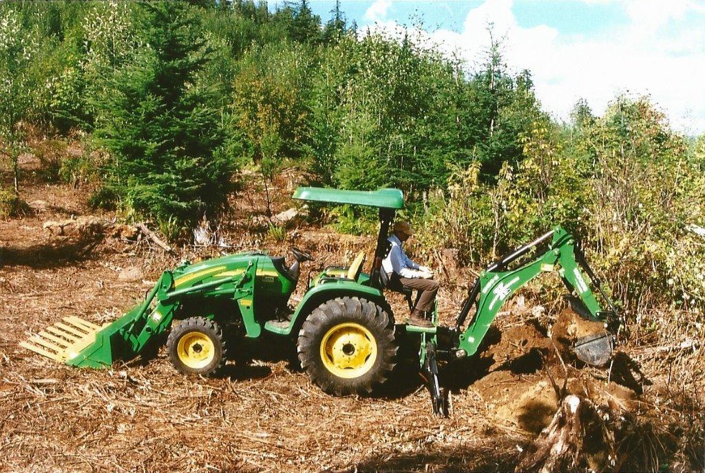

Here are some photos on my JD 4720 w/ BH-90X. Could not find any with it fully stowed but the one has it almost stowed and then two at different points while in use.
I would definitely have the tires loaded for the weight if you do not already have it so.
Let me know if there is anything more I can help you with on your decision. If you do get the hydraulic thumb option let me know the incremental cost of it from your dealer.
