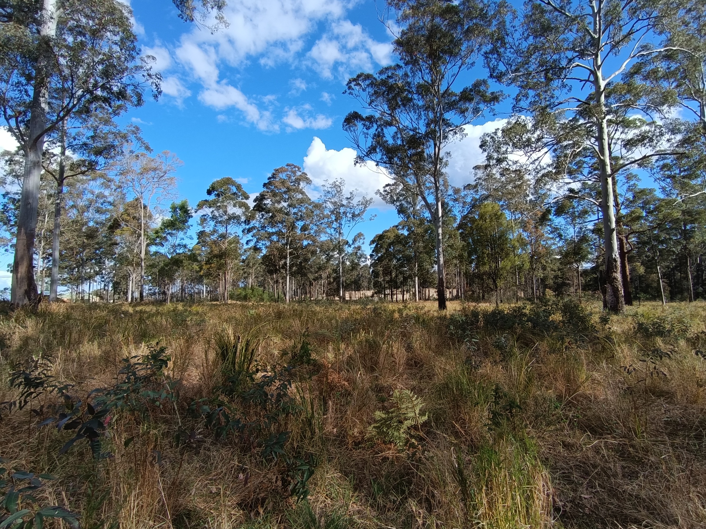

Hi All,
I'm in Australia looking for advice on what you guys think would be the best cutting attachment to initially clear, then keep this scrub cut down to reduce the fire hazard.
I've chatted to a few dealerships, they have all said different things about slashers, mulchers, and brush hogs. The ground is very flat, little to no rocks, and some branches from the gum trees around it.
It's 8AC but limited to Bobcat 26HP, I don't mind taking a little longer to mow it down, especially if it's kept nice and low.
I'm totally at a loss on the right choice.

A slasher will do it easily. Get one properly sized for the tractor.
   / Need advice on right cutting attachment #3
That looks pretty light, so practically any type of cutting implement would get the job done. After having used a flail mower for the last 2 years, I would definitely recommend the same for your application.

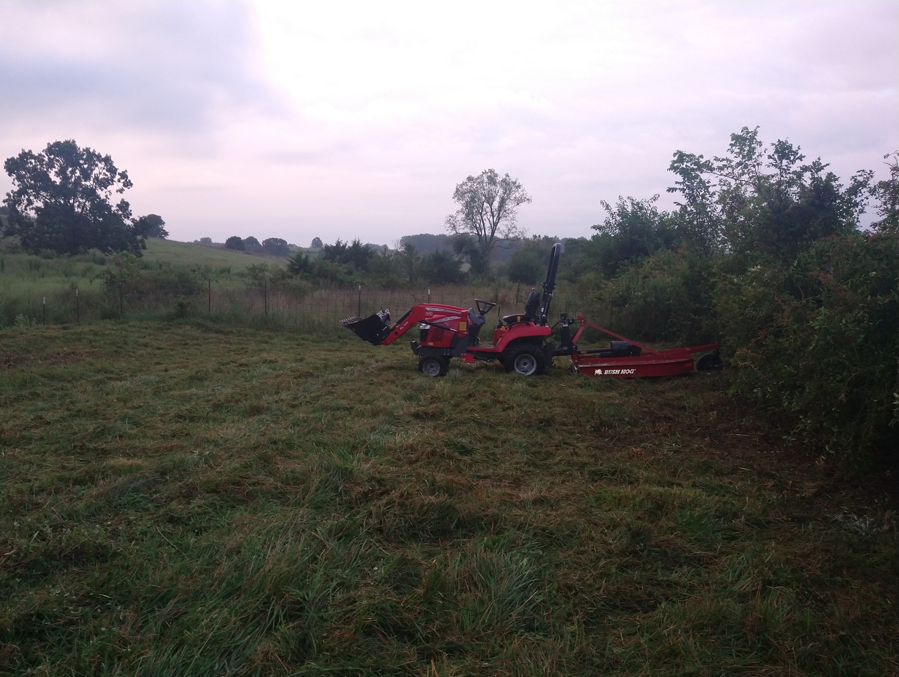

Yeah, I used what in my part of the USA is called a "Brush Hog" but most manufacturers here call a "rotary cutter" ... This is my 4' (44" cut) behind my 25 HP SCUT ... Three years ago ...
Small 1" - 1.5" cedars and multi-flora roses had to go ... And I had go very slow, and to back up and "hit them again!" (It's rated at "up to" 1"!)

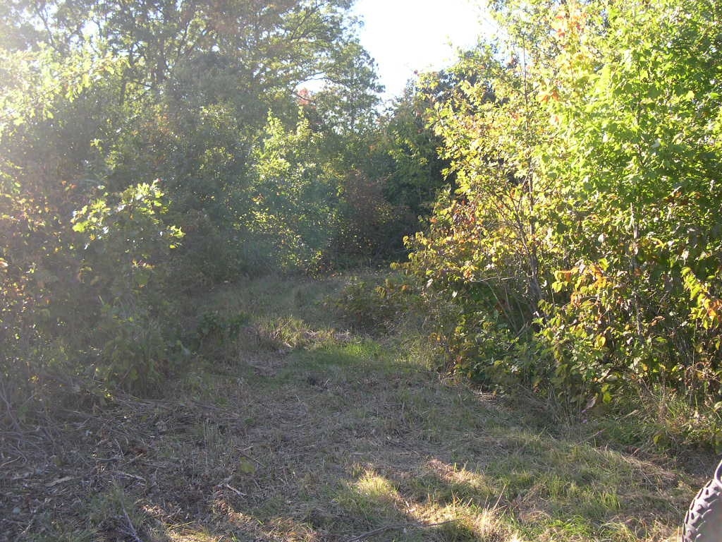

The stuff on the right was cut once by me after purchasing it ... On the left is probably more than 10+ years of neglect ...
I traded the 4' for a 5' (56" cut) which does a pretty good job, but heavy stuff I gotta go slow ...
All done in that corner after 1st cutting!

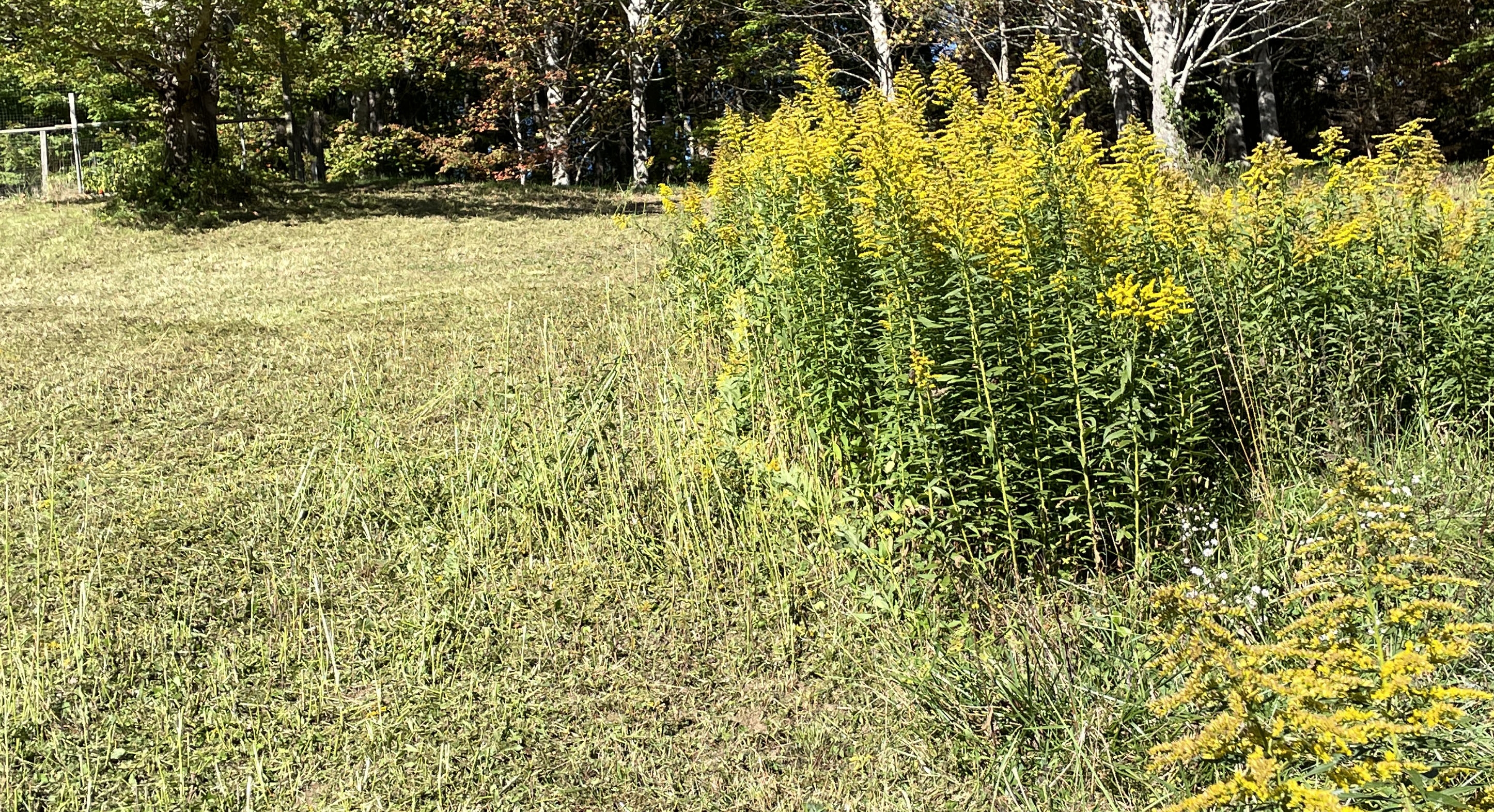

If you want it to look more like this ... I'd suggest at least three cuttings a year!

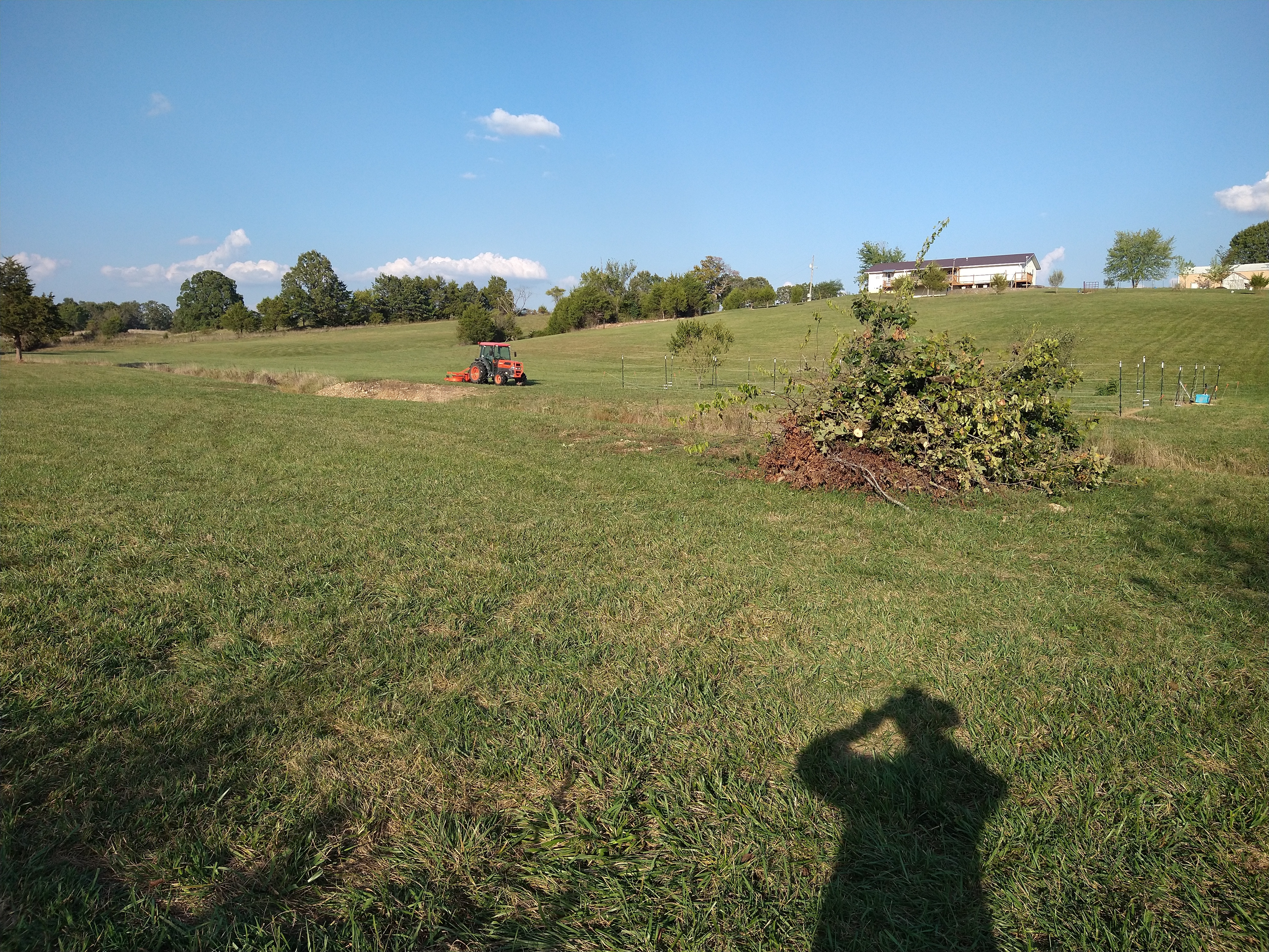

Now I mow it with a finish mower ... Looked like this last week! (Standing in the same corner as the picture two above here "all finished in that corner" looking back from where the Bush Hog brand, brush hog is!) 😁
ETA - A rotary cutter will leave a trail, or windrow of cut "grass", that a flail won't ... A rotary cutter is much longer than a flail ... A rotary cutter is easier to sharpen the blades ... A rotary cutter is less money, and tends to take rough treatment/terrain better ...

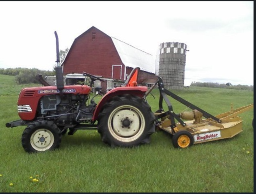

Cut brush 8' tall with a 15hp Shibaura and a 4 foot rough cut mower/rotary cutter.
