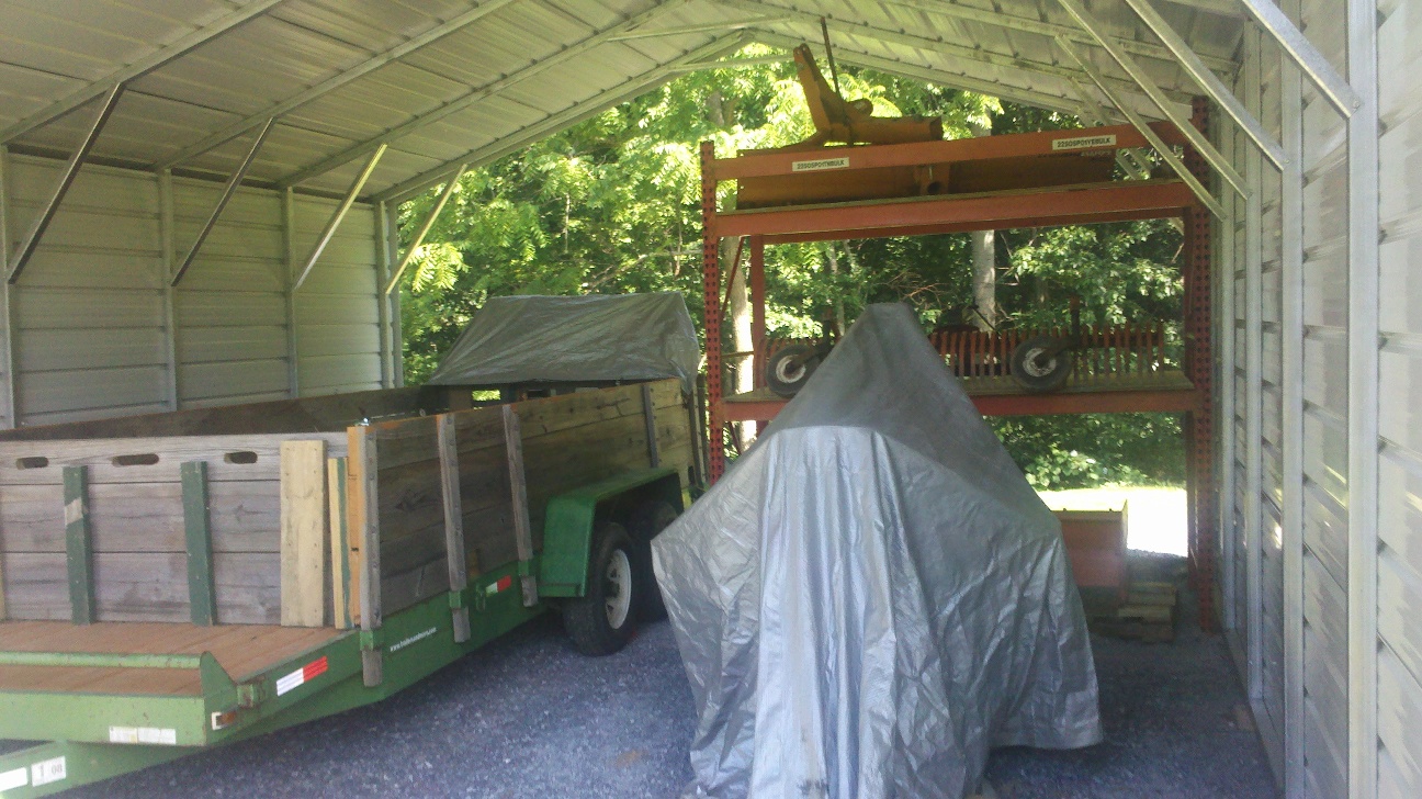

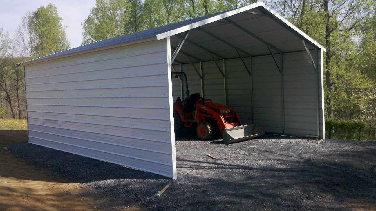

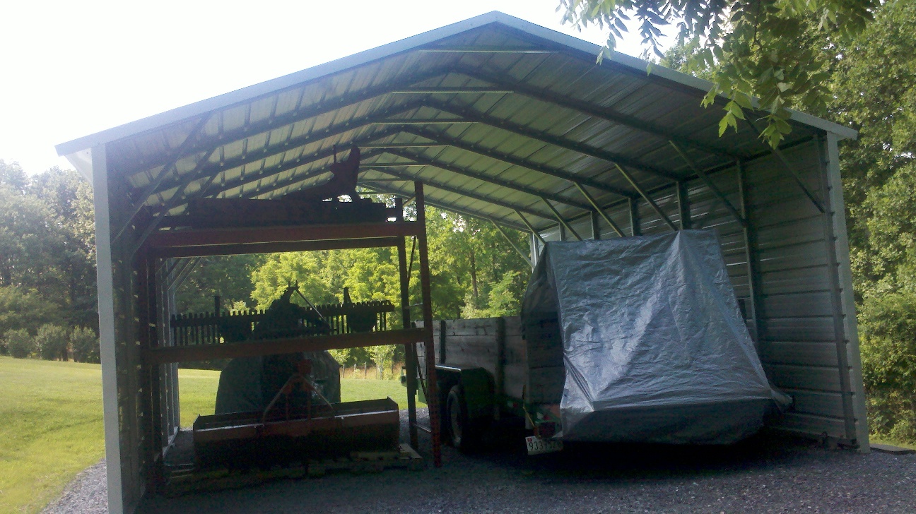

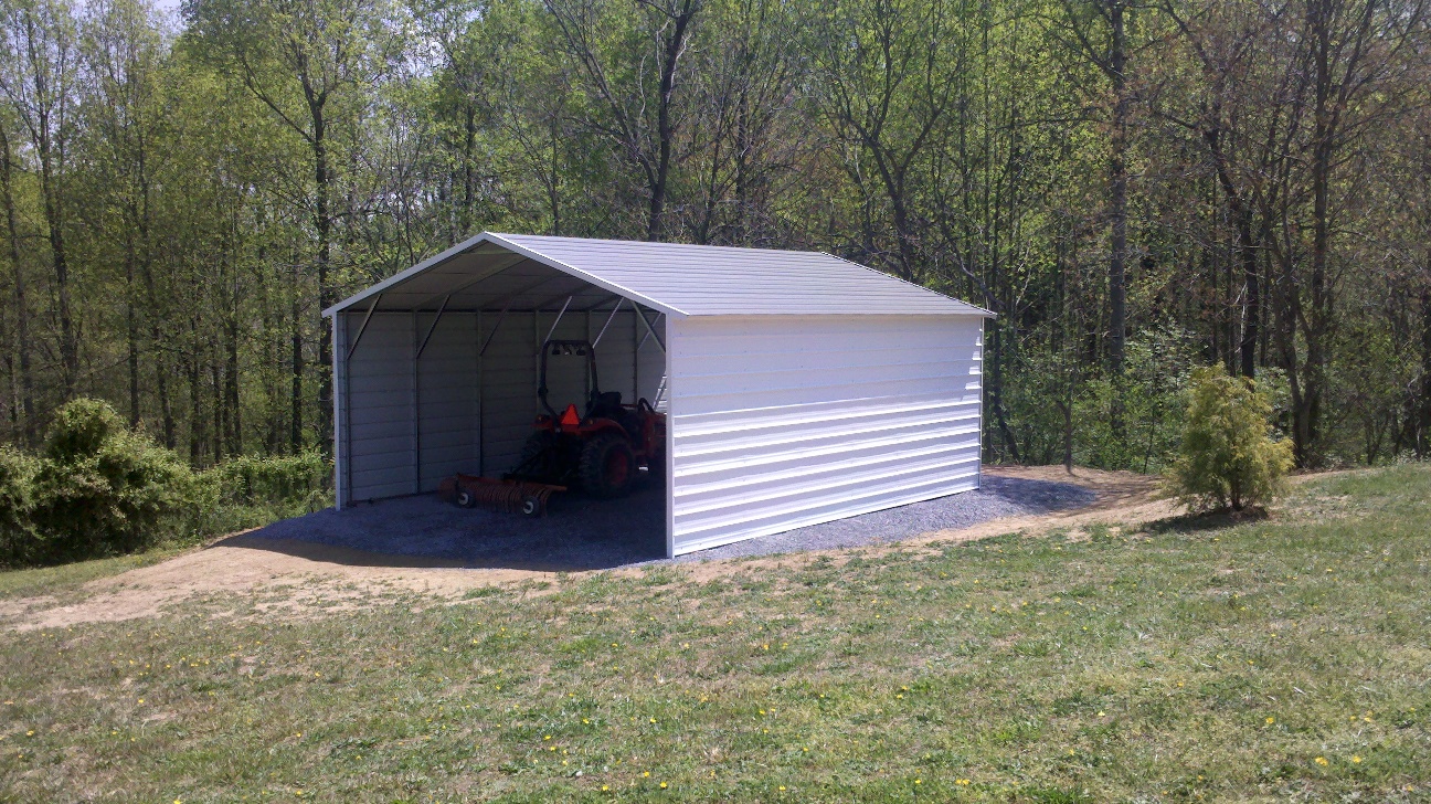

I ended up going with a closed side heavy duty carport, 20 x 25 x 9 open ends for $2500 fully constructed. I excavated and bought my own gravel. I'm really pleased with the carport too. Not a full enclosure, but meets my needs for much less money. I think I could have gotten it with closed ends with a garage door for about $4000 fully constructed.
   / Need advice on pole barn cost-- #10
Just wanted to point out that I couldn't get near my buddy's price either, especially with concrete. I know he got a deal and I'm envious everytime I go to visit. And I'm sure NY is much different than WV. BTW, I'm in Maryland and a pretty good bargain shopper myself. Shopped long and hard to get the $8500 price. This is what I ended up with for $2500.
