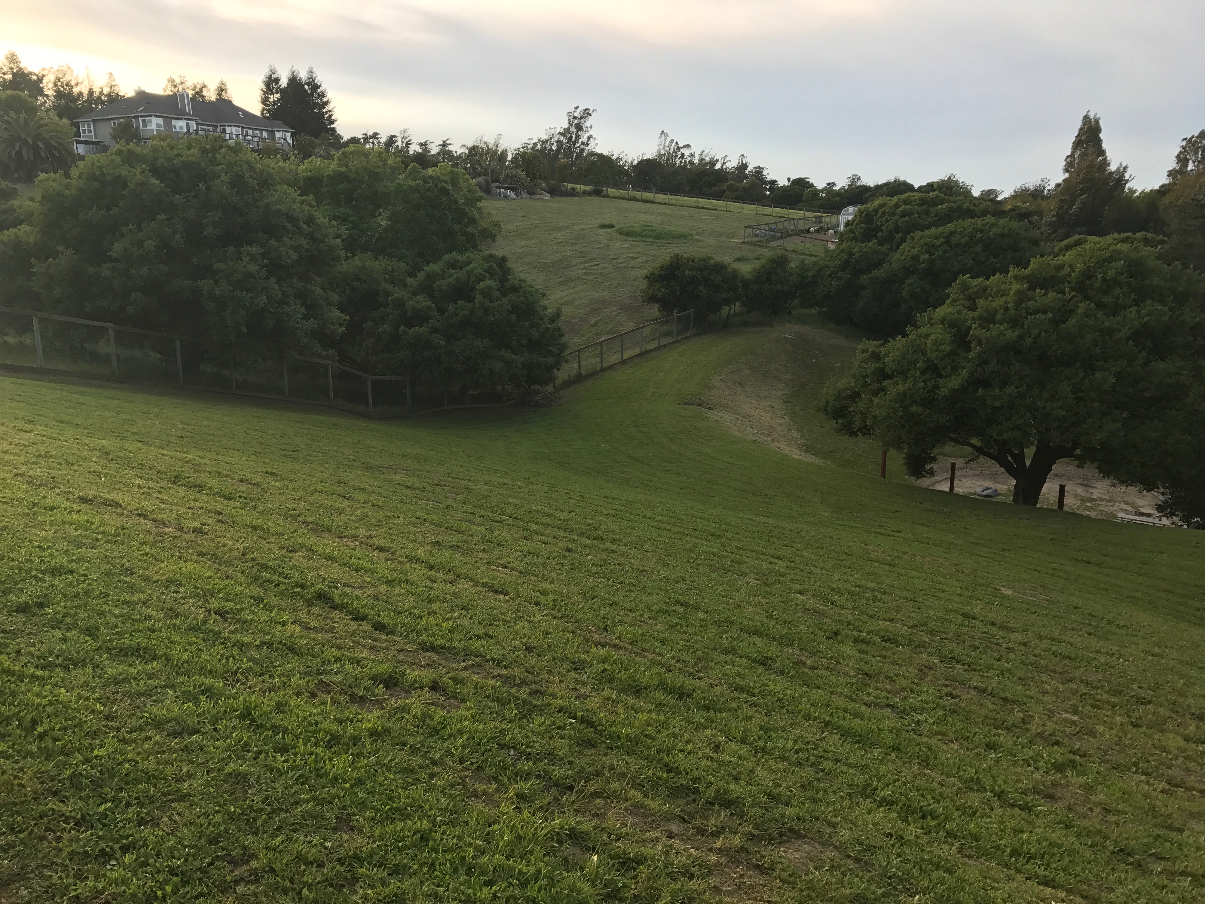

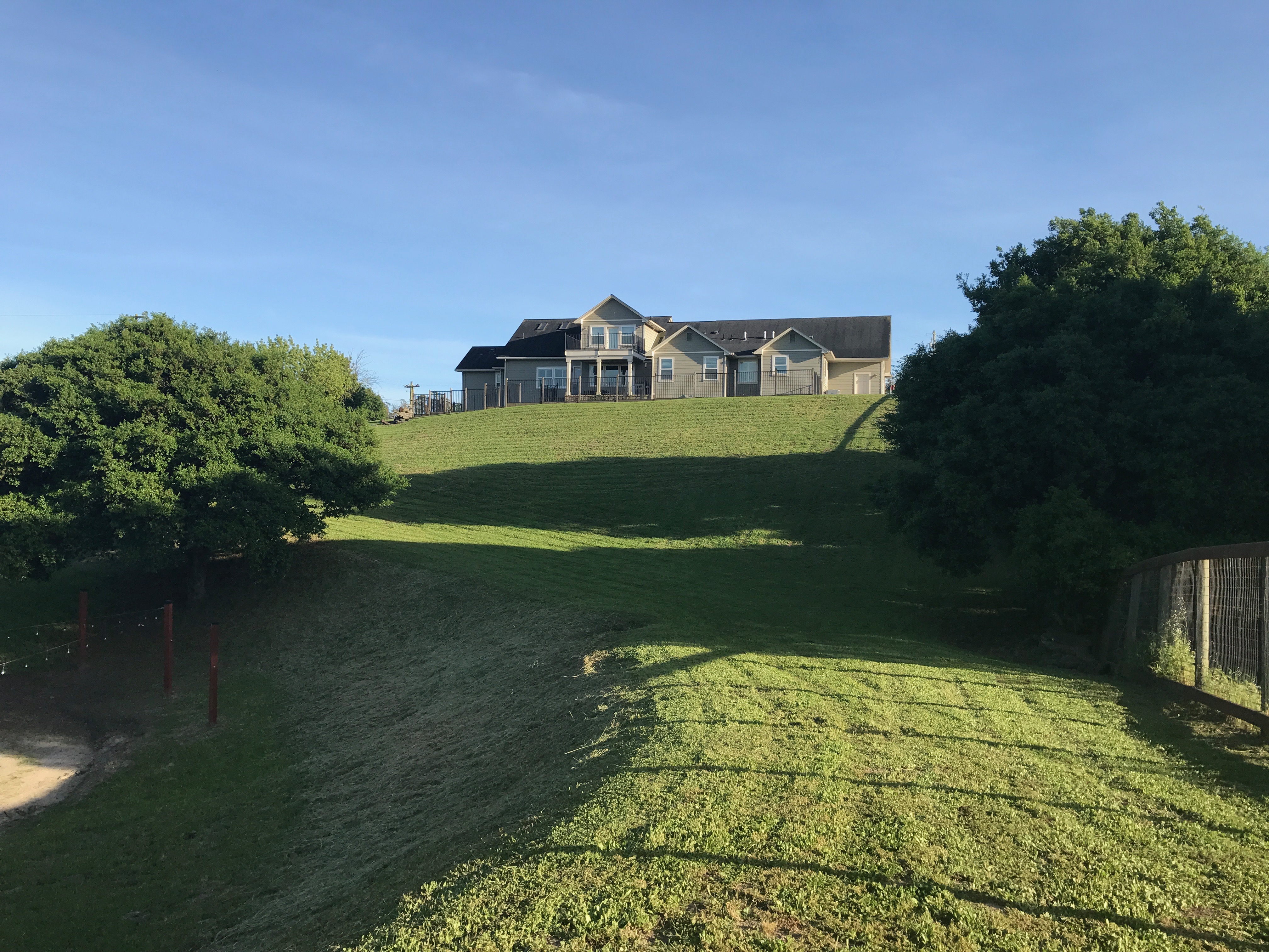

There's a picture below of the biggest part. Not the toughest, but the largest hill I have to mow. It's pretty steep. I have the seat switch jumped so that I can lean when side hilling. In 14 years, I've never even come close to tipping, though, it is always a possibility. What I'd like is some recommendations and/or validation to some of the tractors I'm considering.

A piece of equipment that can handle your terrain and give the exquisite cut quality that you demand will cost some $$$$. Either pony it up or settle for a less than country club look.

A mower that will handle that terrain day in and day out is going to cost you over $6000. A mower similar to my Ferris IS700Z zero turn with Hydrogear 3400 drive motors is the least you will get by with on that property. I have hills that I mow sideways and it will mow true as long as the wheels maintain traction without sliding. Most zero turns don't recommend sideway hill mowing over 8 % grade but with my Ferris I can mow a 20 degree slope easily and regularly mow my pond dam in places that are 45 degrees for short distances.
Any mower you get whether tractor type or zero turn needs to have a commercial grade hydrodrive unit of at minimum a 3400 series. Anything less and you will be replacing them frequently. A blown cheapy transaxle will cost $1500 to replace (no fixing them) and at every couple of years, that adds up to a good commercial unit pretty fast.
It is just as the old mechanic says: You can pay me now or pay me later. As you have discovered from John Deere, a good heavy duty 5series lawn tractor is going to be around $8K.

This isn't what you want to hear, but you need a small 4 wheel drive tractor, usually called a SCUT. A very high quality mower would also work, such as a Kubota F series, but they are really big buck. I'd say the links you posted aren't any better than what you have. Look for a small used tractor with a mid mount mower, you can get them with a 60" deck. I think you might also surprise your self on how often you would use an end loader.
I went through the same thing, beating up a cheaper riding mower, than beating up a better riding mower, than I bought a small tractor. I have zero regrets and it's worth every penny.

I've used a rear finish mower hooked to a tractor for over 24 years. In that time frame I have spent very little money on repairs to either the tractor or mower. Started out with a grey market Yanmar YM 1700, upgraded to a New Holland 1720, and now run a utility sized tractor with a 6 foot mower. With that much area I would recommend a CUT and RFM. Your slopes are no more severe than what I have been mowing.

I can't recommend a mower but I have to ask what kind of grass that is and if you water it. It's far nicer than my lawn.
