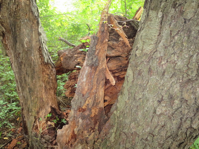

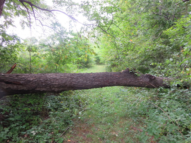

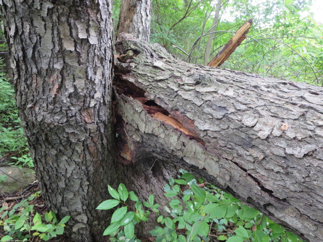

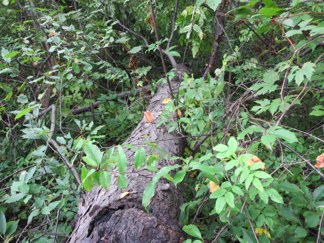

Thanks for the replies, guys. Here are some pics.

oops, they came out backwards. Not that it makes a difference I guess. The first pic is an area I'd just as soon not get into, where the top is laying.

Thanks Dan. I'm *really* looking for an alternative other than going into that viney, thicket area I showed in the one pic and working from the top down. That seems more like an accident waiting to happen because I can't see all the tree where it's laying. Plus the chainsaw could grab at those vines. If it was in the open I would certainly start there.
It's looking like undercutting is the way to go. Man, that's a lot of undercutting. I better pick up some Wheaties. I really only need two cuts though, since I don't have a fireplace. I should at least be able to move it with my tractor once that section is cut out.
