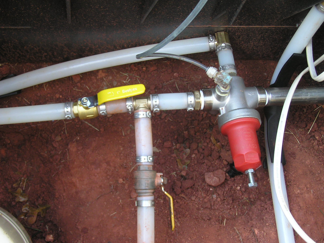

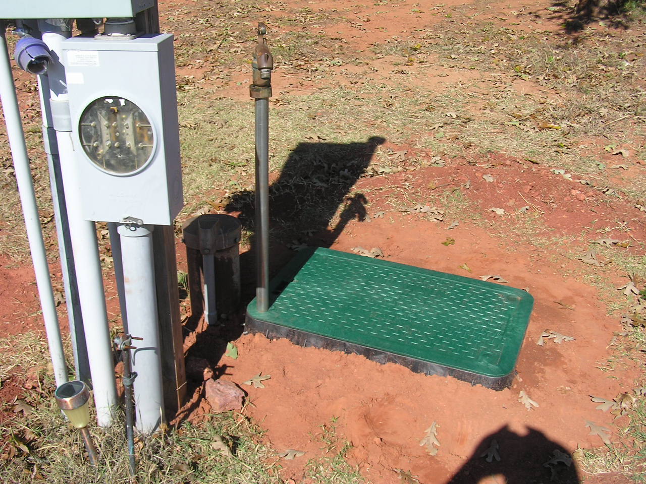

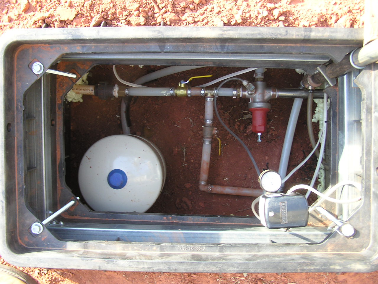

The CSV is an excellent way to prevent cycling for small or large water users
With a direct order cost of only $63 and free shipping, it may warrant a try before spending way more on a tank you may not need
   / Need advice on a captive air tank #8
Very happy with the way a CSV works for us: http://www.tractorbynet.com/forums/...ell-pump-monitor-post4258924.html#post4258924
This one is 24" underground, no heater required here in Oklahoma.
