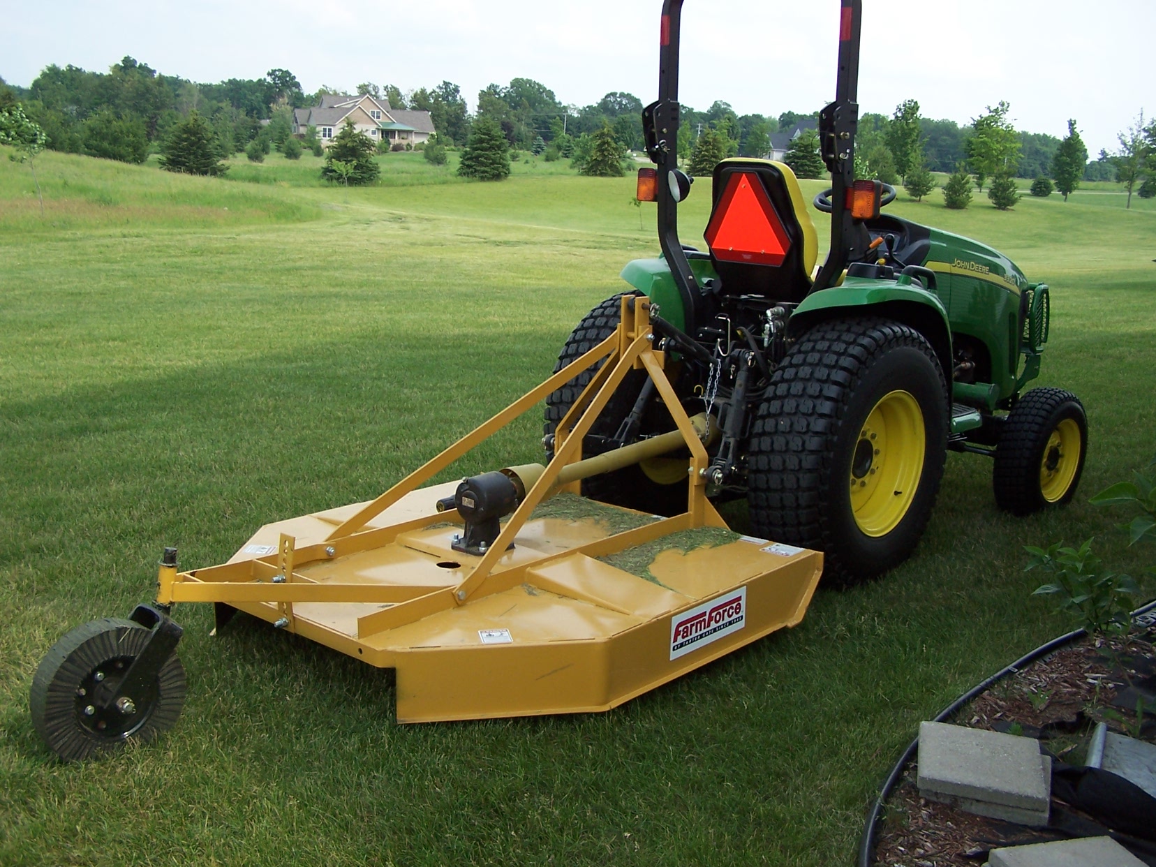

I just bought this 5' unit from TSC for $614.79 out the door. That included a $50.00 off coupon that came in the mail. I think the 6' was about $50.00 more. It works just fine.
