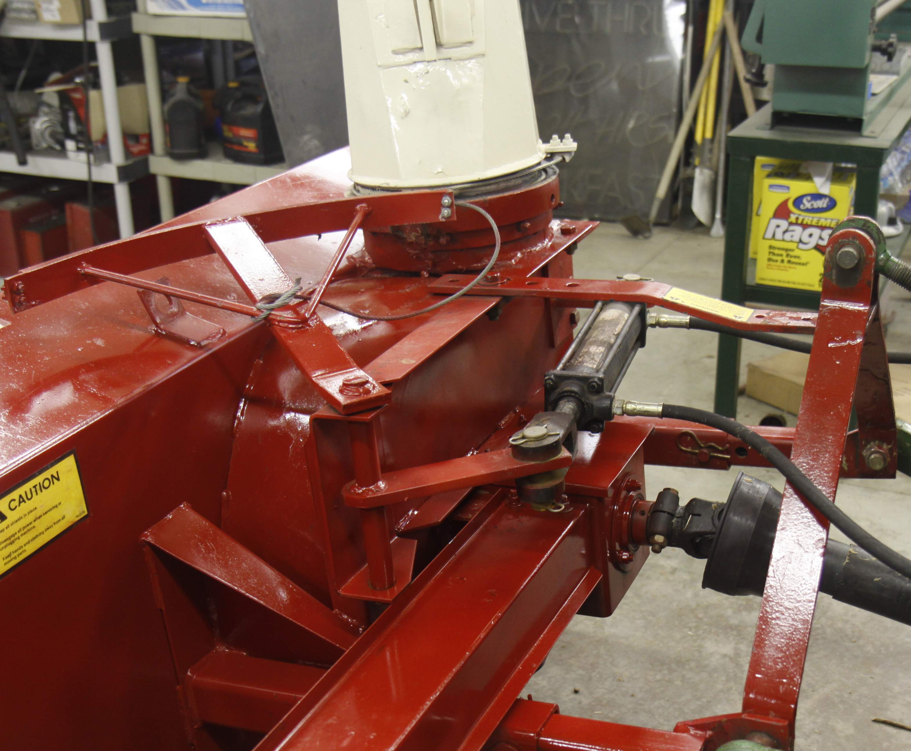

Mind you, if you ever want to make the chute a hydraulic rotator, the farm king offers a kit for about $100.00 plus the cost of the cylinder. The cable rotator transition to hydraulic is sweet. After using the hydraulic rotator, you'll never want to go back.
