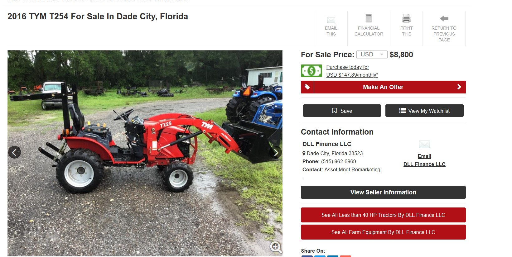

   / Need advice. New home, need tractor #9
This
