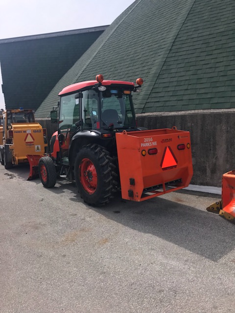

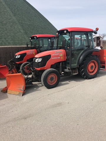

Thanks for the reply Ralph, the contract unfortunately requires a blade. I have attached a picture of a bigger machine (M7040) that handles these types of contracts with ease, however for the purpose of this new job it is too expensive for the town to agree to. I have attached a couple of pictures of the set up they have. I basically need to know if the B2650 can handle this much plowing for a 5 year term. M7040 2.jpegM7040.jpeg

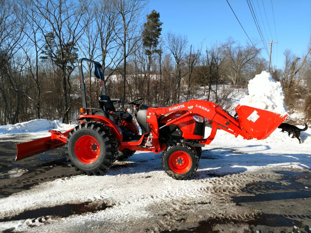

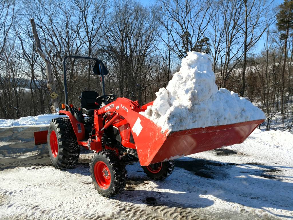

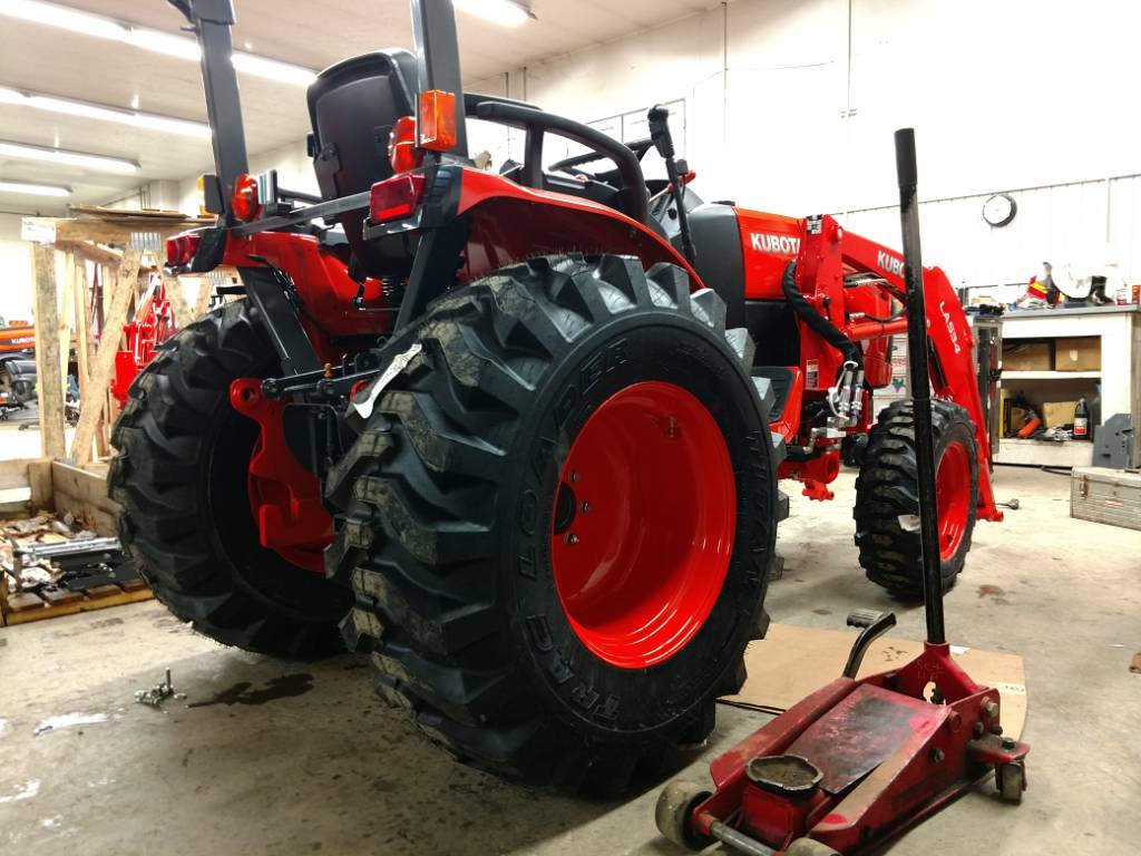

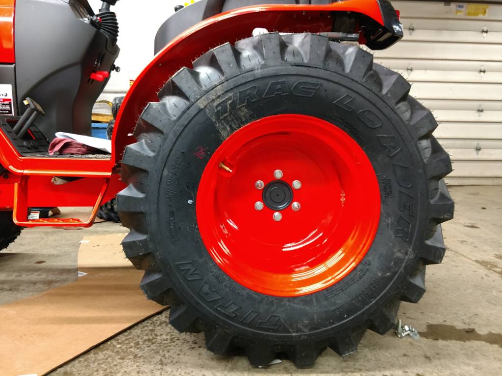

Your talking about a foot shorter than mine, and it's a V plow, so your never really pushing/plowing, your more sliding snow out to your sides. That will be cake work for a B2650 with fluid filled tires and around 500-800 lbs of rear ballast. Kubota makes a ballast box for this size tractor that is only about $300. You can also use a PTO drive salt spreader as your rear ballast.
All in all, that plow would be a walk in the park for my B2650 in medium range unless it was literally a 12"+ nasty, wet, heavy snow.

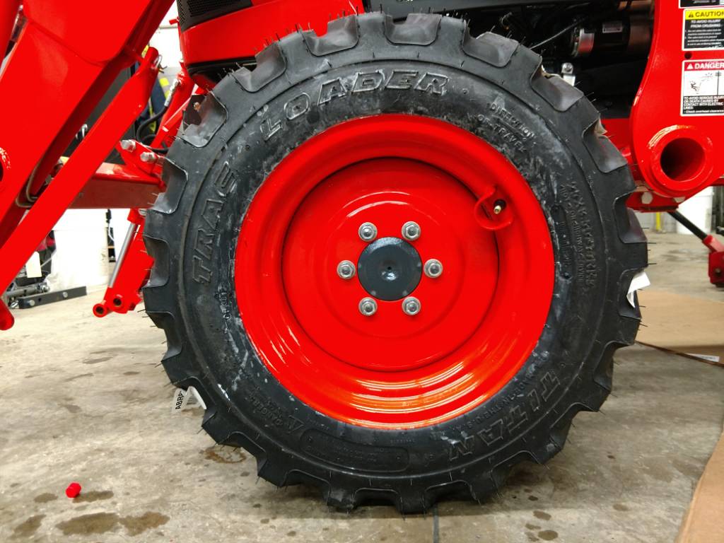

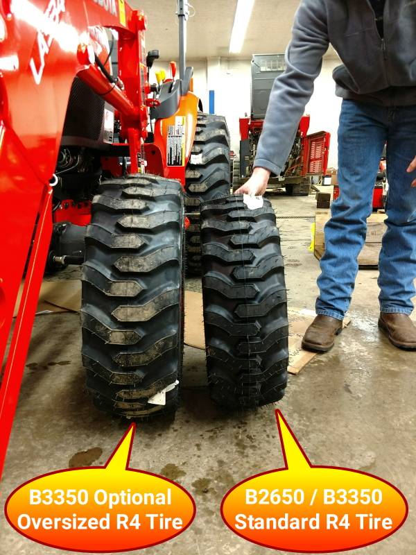

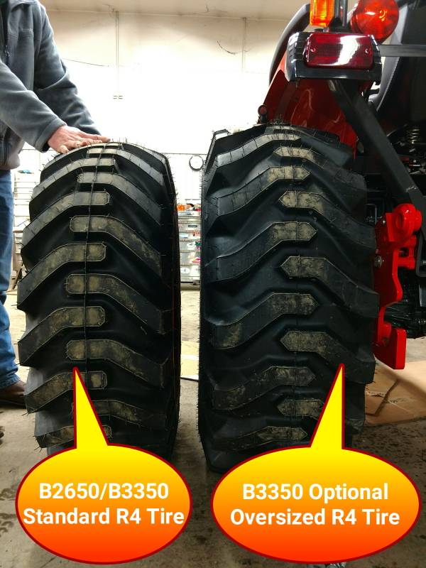

May I strongly suggest doing your build with the wider/heavier ballasted B3350SU R4 tires? I'm plowing paved surfaces with them and traction is never an issue while I see others talking about chains and the such. Unless I needed plow on ice or up honest to goodness steep slopes, chains are totally not needed. Because I'm on blacktop, there is never ice. Even in a 0°F day I can plow it and the sun his the visible cleaned black stripes and it heats it and starts melting. After plowing in the AM, the entire drive will be dry blacktop by the time the sun goes down. I only salt in the areas that are always shaded.IMG_20180118_144232765.jpgIMG_20180118_144224037.jpg
