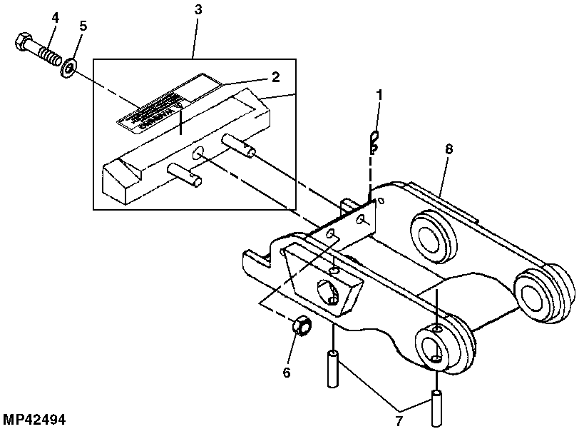

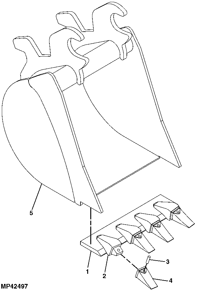

What does the quick-mount look like? I have a JD 375 and would like to build a small trenching bucket for it, but dread changing the buckets because the darn pins are so hard to work with. A few pictures would sure be nice, I could copy the ideas. thanks....
   / NEED A USED Bucket John Deere 110G TLB #7
   / NEED A USED Bucket John Deere 110G TLB #8
Bear in mind or be aware that there are two styles of quick attach mounts and are not interchangeable.
   / NEED A USED Bucket John Deere 110G TLB #9
Yep... gotta be a QA bucket for the thumb option. No thumb available with a pin-on bucket.
2 styles of QA, huh? That's a new wrinkle. Thanks.
'Course you could always retrofit your hoe with the QA coupler, too! Sell your current pin-on bucket.
AKfish
   / NEED A USED Bucket John Deere 110G TLB #10
I am not aware of two different qa for the 110, 27, 35. The 50 and 60 mini's are however different (the ears are wider) but as far as I know any qa from a 110, 27 and 35 should work I can't speak with confidence on the qa style for the skidsteer hoe att though.
