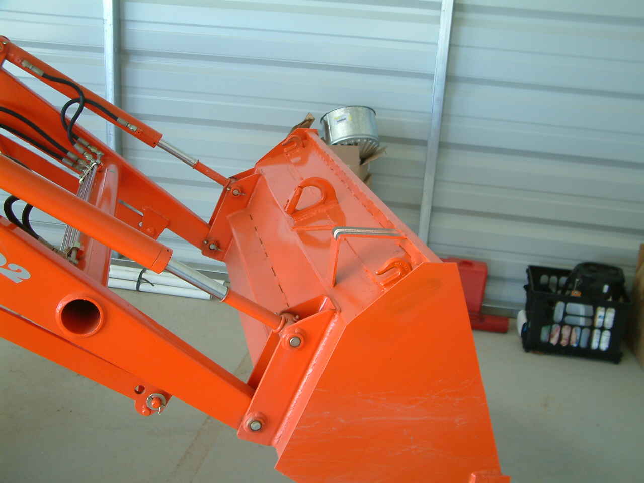

Last May I bought a new Kubota B7510HST with LA302 FEL for $12,600 + tax (10% down, 0% APR, 36 months). I use this 21HP tractor (16HP at the PTO, 3 cyl diesel) for the kind of jobs you describe on my 10 acre parcel (flat, weeds, 28 almond trees left from a previous orchard). The tractor weight is about 2000 lb with the FEL so it should fit on your trailer with ease.
The hydrostatic transmission (HST) makes the tractor very easy to operate, especially when using the FEL. Like all new U.S. tractors, it has a roll-over protection system (ROPS, a big roll bar) and a seat belt. The ROPS is hinged so you can lower the upper part to get around tight places, like an orchard.
The FEL reach may be a little short for your needs. If I read the Kubota specs correctly, it can only lift about 67". You may have to build a dirt ramp to empty the bucket into your dumpster. Easy to do.
I added a King Kutter box blade (48" wide) for $375 at Tractor Supply Co (TSC) and then a KK rotary cutter (brush hog) for $675 also from TSC.

Be sure to have the dealer weld chain hooks onto the top of the FEL bucket (see attachment). It makes the FEL a lot more useful
