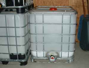

I have a question about diesel fuel tanks. Can plastic tanks be used for long term diesel storage? I found this tank locally and for a 250 gallon pallet tank with a lower drain unit that I can attach the hose and filters - for $100 I don't think I can go wrong if it would be OK to use for diesel??? The tank is on an aluminum frame/pallet and would be easy to move/fill with the pallet forks.

I've heard these aren't suitable for diesel storage .
I'd go with 30 and or 55 gallon plastic drums.

I have been using one for 5 years with no problems. I built a stand at first then ended up putting it up on my rafters that are beefed up in my pole barn. I put a 2' section of hose then a filter followed by a 12' piece of hose and a gas station type nozzle. I just call the co-op and they come fill it with off road diesel.
Chris
