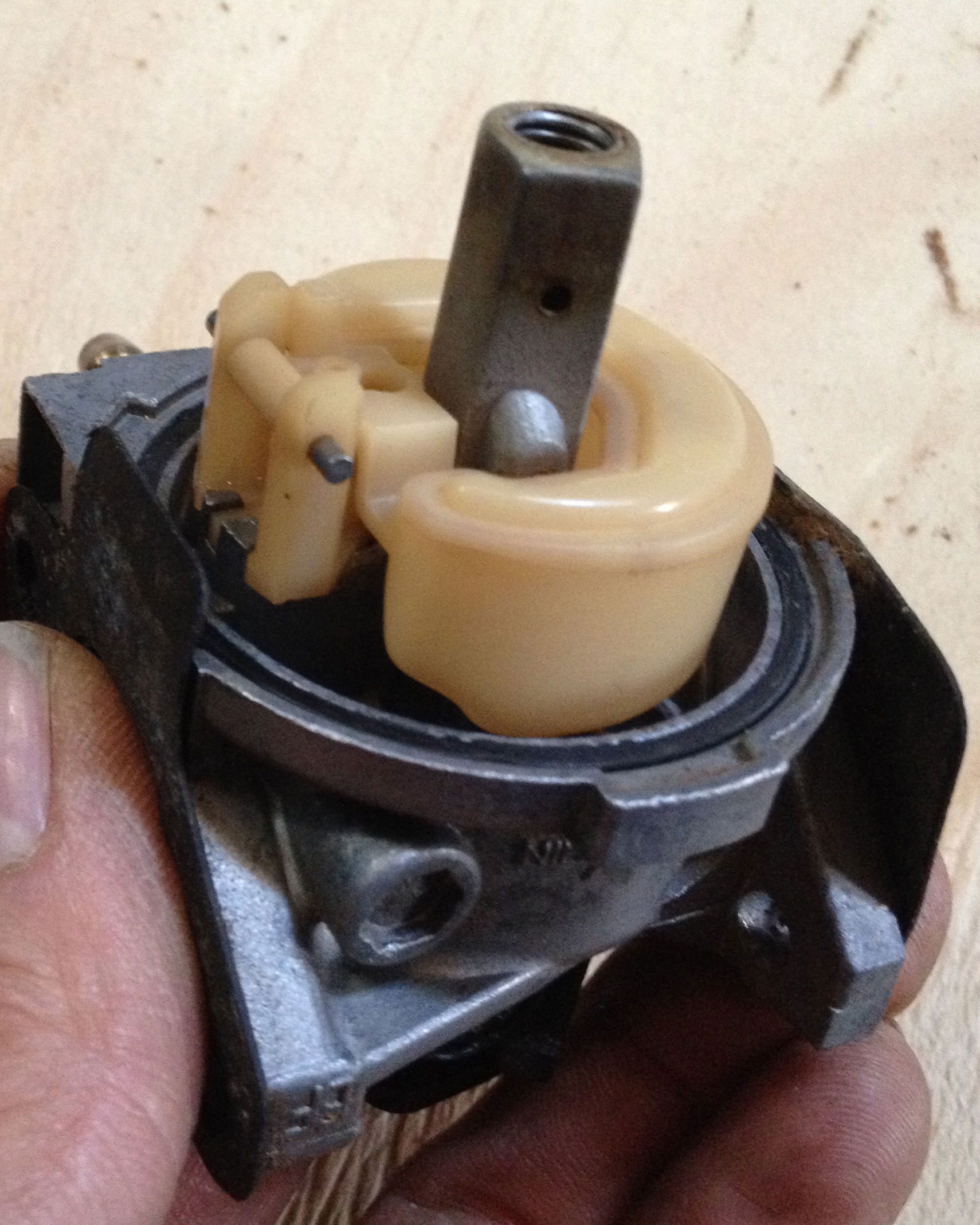

I have a nice little Honda EX1000 generator, tried to use it to run my sump pump during a recent power outage but it leaked gas out the overflow.
Took carb apart to clear the float needle seat and found that it was leaking from the plastic fitting OUTSIDE the needle seat. I need some kind of sealant to go around this plastic or nylon fitting. Any recommendations?
The float assembly

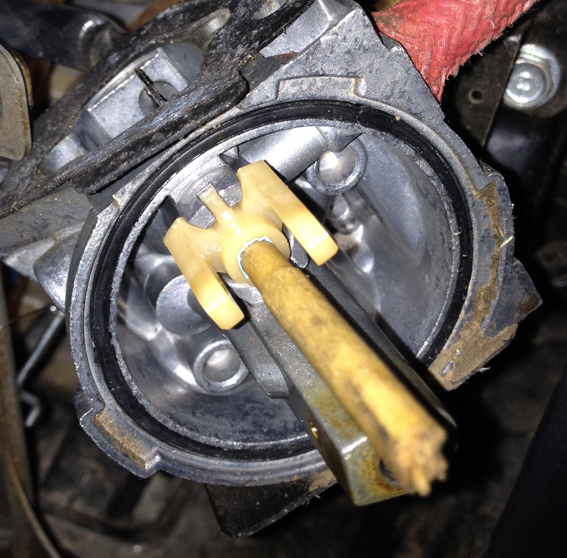

Wooden dowel with a glove-finger for a seal

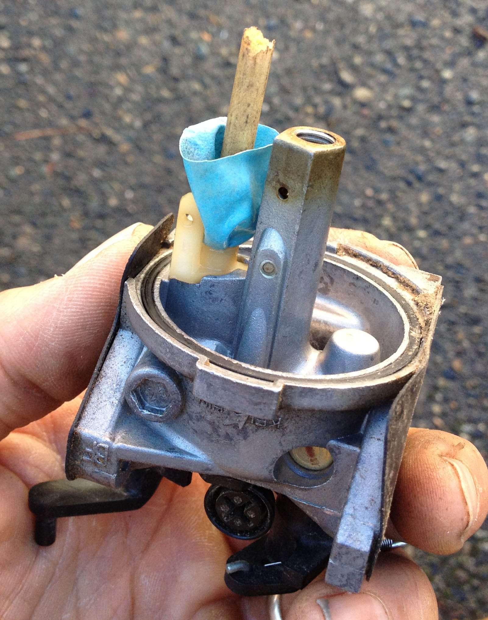

Needle hole plugged
Where the gas is leaking from. I tried to pull the needle seat unit out, to look for an o-ring back in there but it didn't want to come out, seemed like it might break before coming out.

It can be pried out and there is an O ring around that fitting. I have pulled one in an emergency and replaced the ring. the little retainer fingers will tend to break off when pried.
   / Need a sealant for INSIDE carburetor (for ethanol)
Thanks Cory. Yep not shown as a separate part. It leaks a lot, enough to fill the carb bowl quickly, RandyT I can't imagine how a failed o-ring could flow that much, except dried out & separated? The generator's been sitting, with dry bowl, for maybe 7 years.
