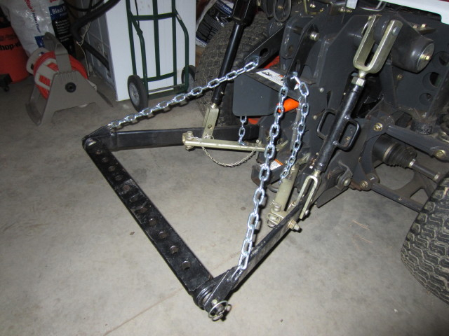

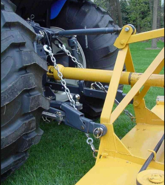

In not a check chain will:
   / Need a reality check on a mod I want to do to my tractor's hydraulic setup. #7
I find using check chains solves a lot is issues with keeping implements at correct height on 3PH.... No longer depend on hydraulics.... Got really tired of dragging ballast in the dirt when "I thought" it was being held up with hydraulics...
You can either purchase or cobble something together...
Dale
