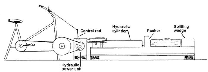

I think I'll pass.
Diagram source:
Low-tech Magazine: Pedal powered farms and factories: the forgotten future of the stationary bicycle
From Wikipedia:
When considering human-powered equipment, a healthy human can produce about 1.2 hp briefly (see orders of magnitude) and sustain about 0.1 hp indefinitely
With 0.1 hp input, what would be the time of the cylinder stroke on a typical log splitter?

I saw this a while back and would like to see somebody actually split even a straight grained softwood log with it. Having said that, the site does contain some other useful ideas for people who like the idea of using human power - also some more "nutty" ones.
I will stick with my block splitter and wedges, partly because it keeps me fit, partly because it costs so little, and partly because I only need about 6 tons a year.

A human that can sustain 0.1hp would be capable of about 0.06GPM hydraulic flow @ 2500PSI.
Actual cycle times based on just the raw math assuming 0.1hp sustained and 2500 operating PSI with a 12" stroke under full load would be:
4ton splitter: 2.8 minutes
8ton splitter: 5.6 minutes
12ton splitter: 8.4 minutes
20ton splitter: 14 minutes
That is assuming the wedge is already up against the wood to be split and you need to exert the full 2500PSI for the 12" of stroke, but it does give you a rough idea of time.
I'd split the load with an axe long before I got that machine out ;)
So a maul would be faster and easier.
