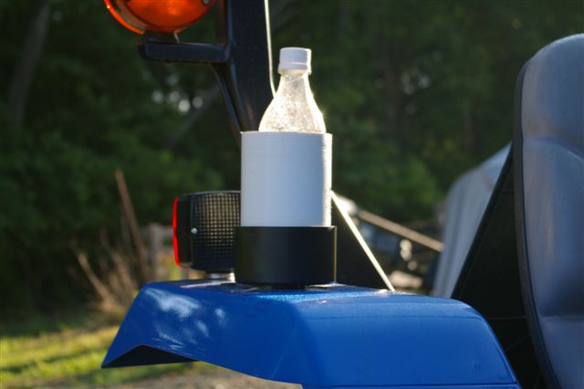

I just added a cupholder to my TC30 using this basic design. I was able to find a black ABS 3" cap that was already flat on the bottom. Used white PVC pipe and it matches the color scheme. May paint it, or may just leave it.

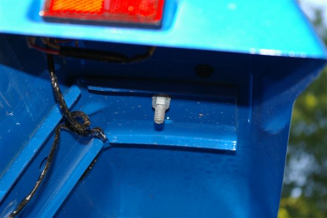

Here's mine. I used a 2" long 3/8" carriage bolt, but could've gotten away with 1.5". I placed a flat washer between the fender and cup holder for drainage. I need to put another flat washer under the fender.
It holds a 20 ounce bottle of gatorade, a 500 ml soda bottle and a 12 ounce beer bottle in one of the zippered neoprene koozies.
It will not hold a 12 ounce can in a foam koozie. Might need to use 4" PVC and make it shorter. I may experiment with that. I have another fender with an identical hole to the left! Never know what kind of beverages i have in the fridge, so I need to have cup holders for a variety.
Wonder if there's some way to make them quick detachable?
