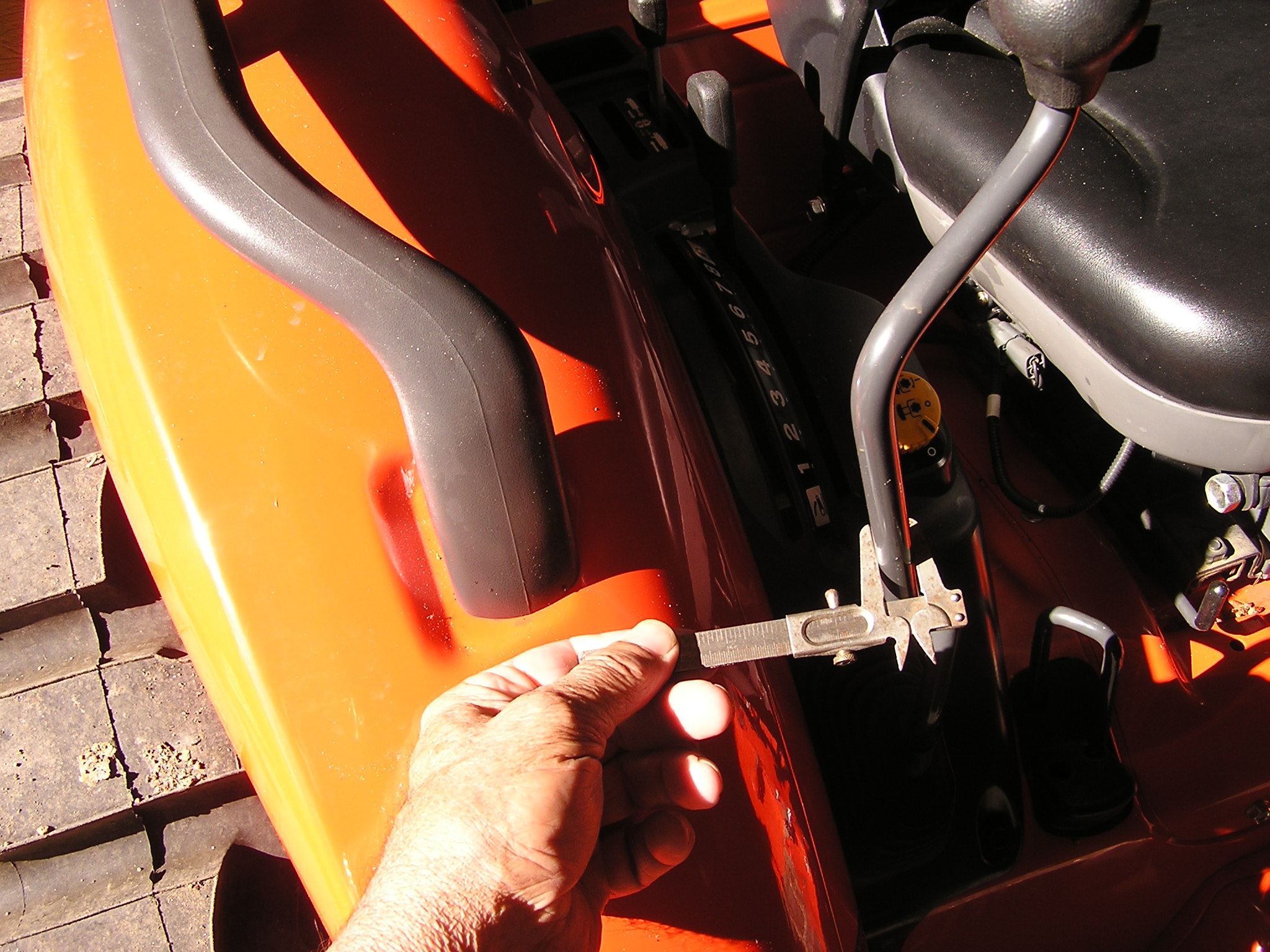

Like the title says
Need a measurement for a L4240 Loader control handle shaft diameter.
The measurement needs to be off of a NON third function Kubota.
When my L4240 was delivered I forgot to measure the loader control handle shaft diameter.
Worst thing, it was on my list of things to do and I overlooked the task.
I'm fabbing up a third function for the tractor and will be grafting a John Deere third function joystick on to the Kubota loader control shaft.

My 2012 L4240 has a half inch diameter shaft. I will follow your fabrication carefully. If it turns out to be not too difficult, I will probably do the same. Good luck with it.

Paul, I believe that it is metric sizing and is actually whatever size is juuuuuuuust a hair bigger than 1/2".
   / Need a measurement, L4240 Loader control handle shaft diameter #6
Per MtViewRanch; "Paul, I believe that it is metric sizing and is actually whatever size is juuuuuuuust a hair bigger than 1/2"
I would have guessed the diameter to be 12 or 13 mm and was quite surprised that it turned out to be 0.50 inches. That's why I included the picture. Note that if it were 12 mm (0.4724 inches) it would have measured approximately 1/32 under a half inch and if it were 13 mm (0.5117 inches) it would be approximately 1/32 over a half. Both differences are easily picked up with a caliper, even one as old as mine. Just to be sure, I went out and remeasured. Mine is 0.50 inches. Doesn't mean others might not be something else. Hope this helps.

All I know is that I have supplied control grips with 1/2" holes in them for a 1/2" dia rod (that's what I thought that they were also) and the grips did not fit over the rod. Maybe some just have more paint on them then others. :confused3:
