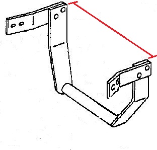

Aug 17, 2012 / Need a measurement from a 70 or 70A loader #1 Mechanos Veteran Member Joined Aug 6, 2010 Messages 1,115 Location Roosterville, MO Tractor JD 955/70A/7 TLB If someone with a 70 or 70A loader could pull a measurement for me it would really help me out. I need the distance between the two uprights on the front yoke/parking stand. I've attached a picture with the dimension I'm needing indicated in red. Thanks in advance.
Aug 17, 2012 / Need a measurement from a 70 or 70A loader #2 JD755 Platinum Member Joined Aug 16, 2009 Messages 919 Location Kansas Tractor John Deere 755 purchased new in 1993 The inside dimension on mine is 24 and 9/16 inches.
Aug 17, 2012 / Need a measurement from a 70 or 70A loader Thread Starter #3 OP Mechanos Veteran Member Joined Aug 6, 2010 Messages 1,115 Location Roosterville, MO Tractor JD 955/70A/7 TLB Thank you. I need to cut the parking stand off my loader and rebuild it. I'm going to add a temporary support to keep things lined up for rewelding.
