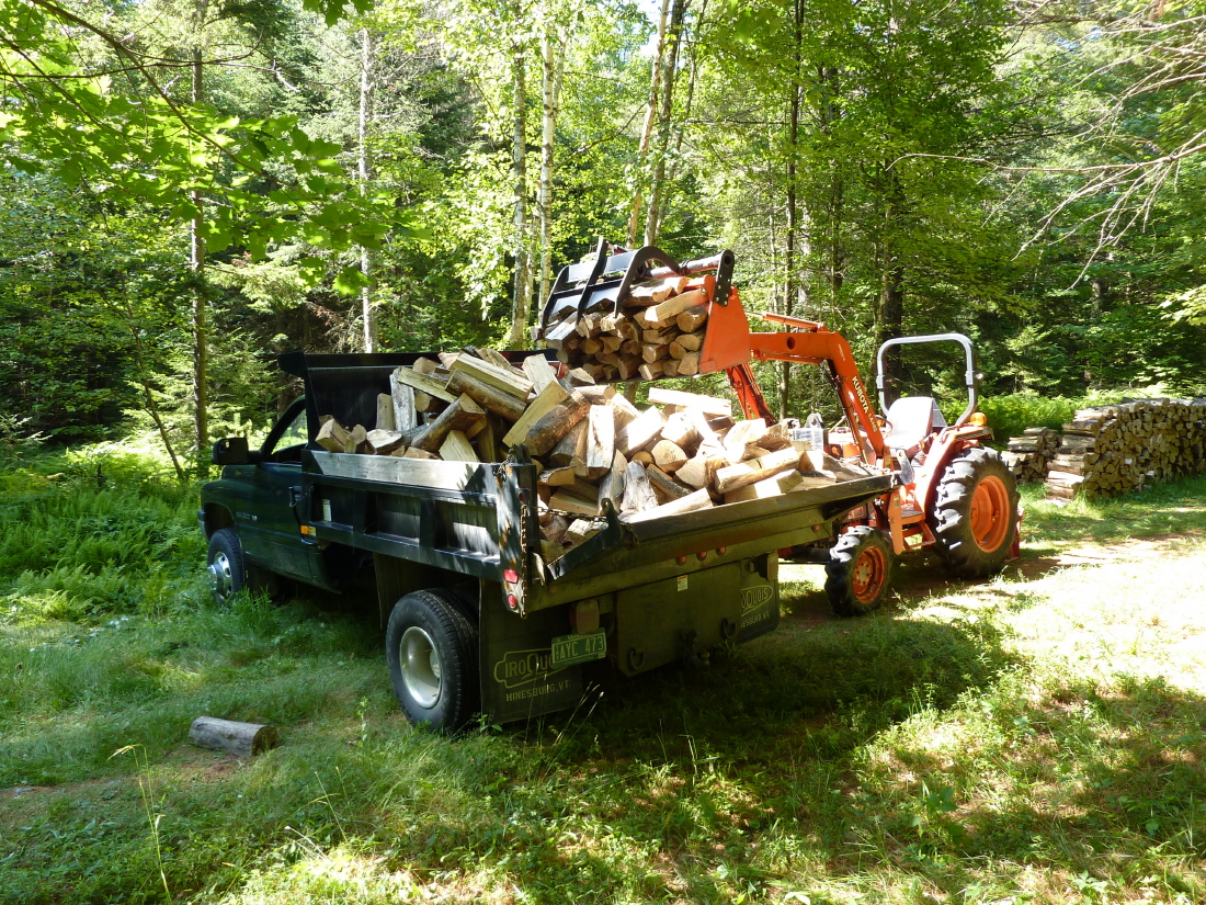

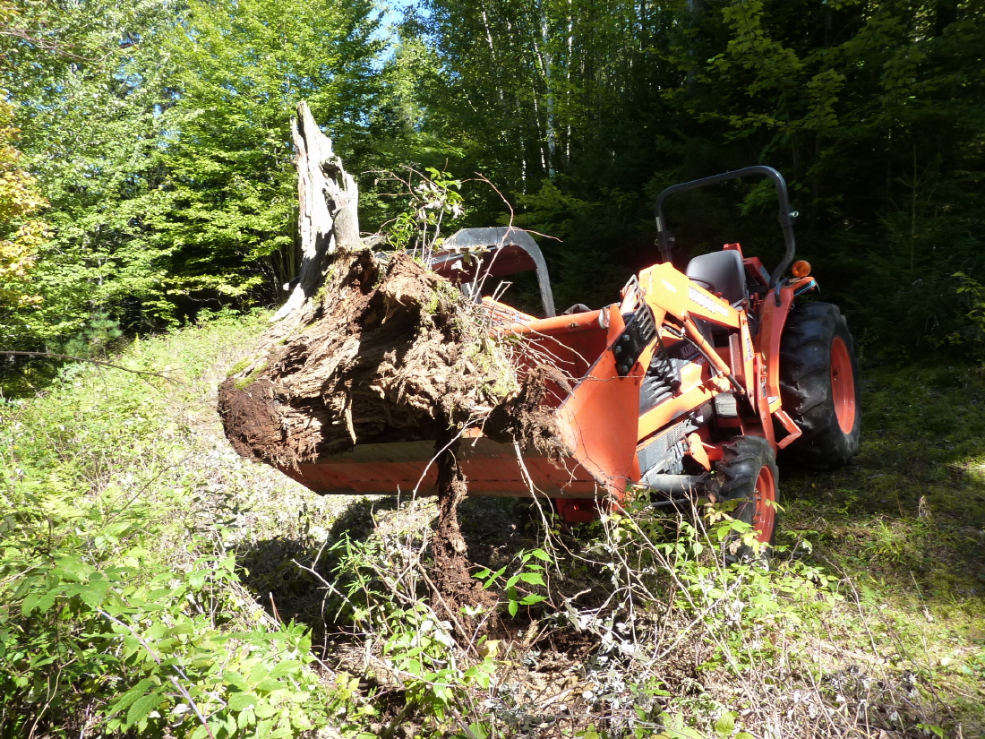

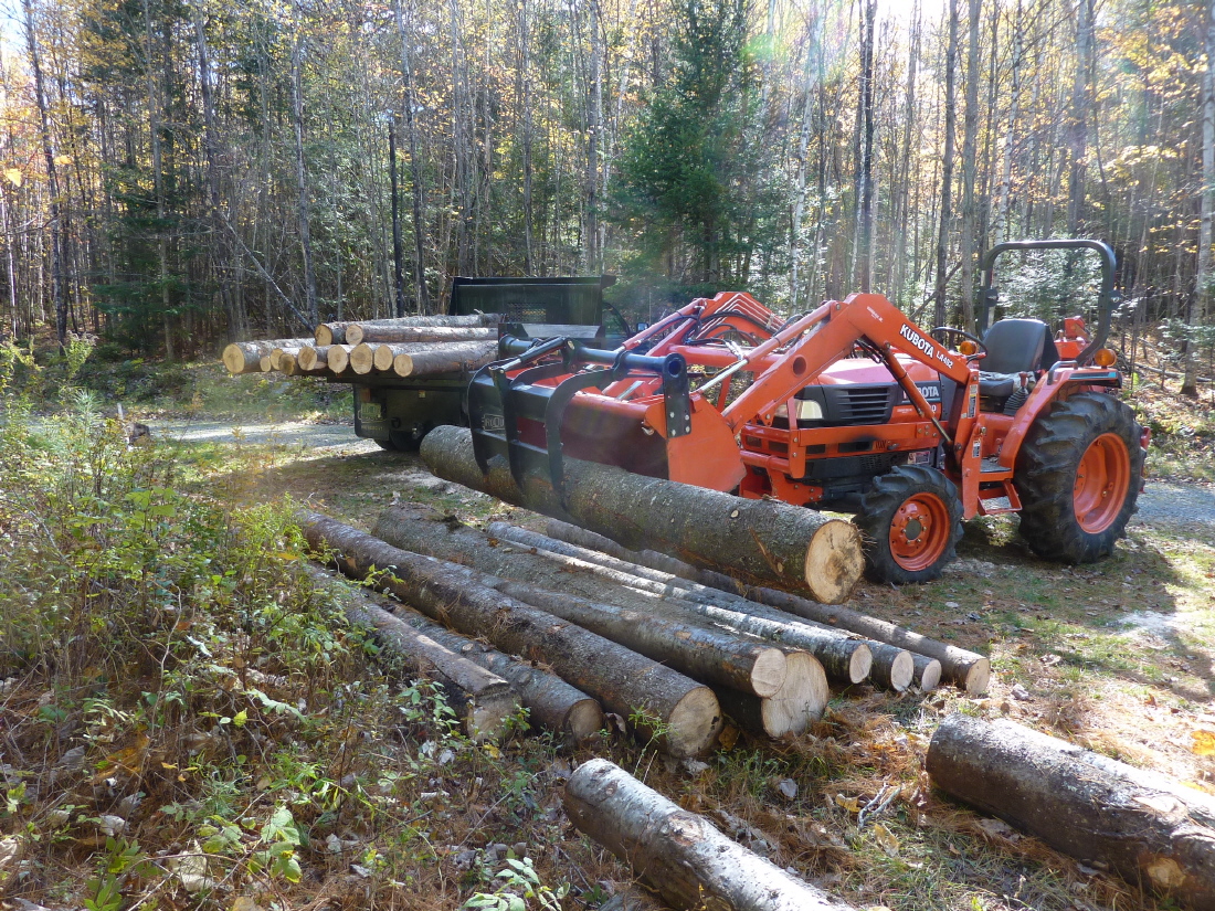

API Grapple. Not as mean looking as the others but work good. Less money.
