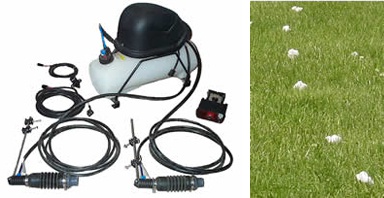

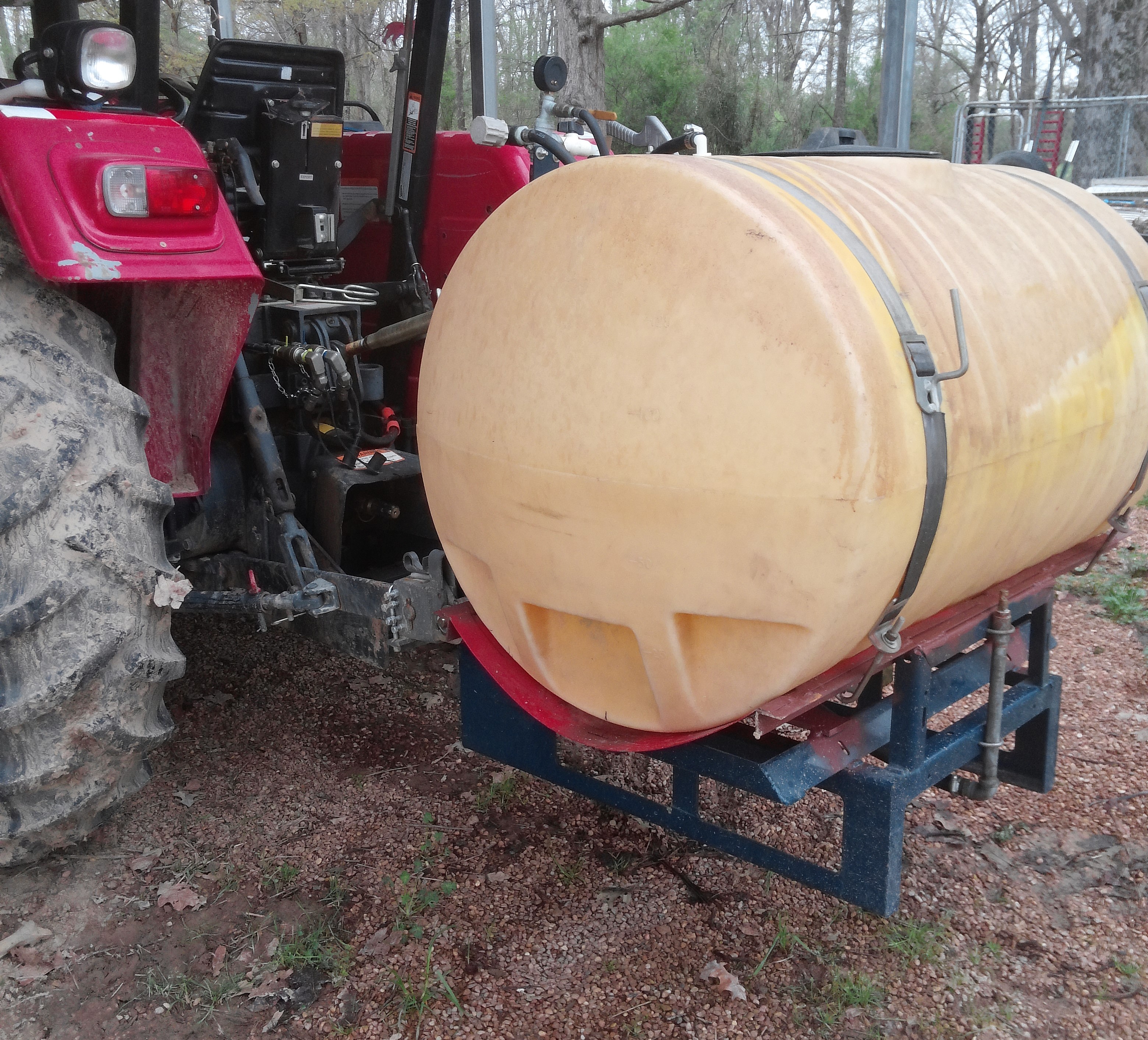

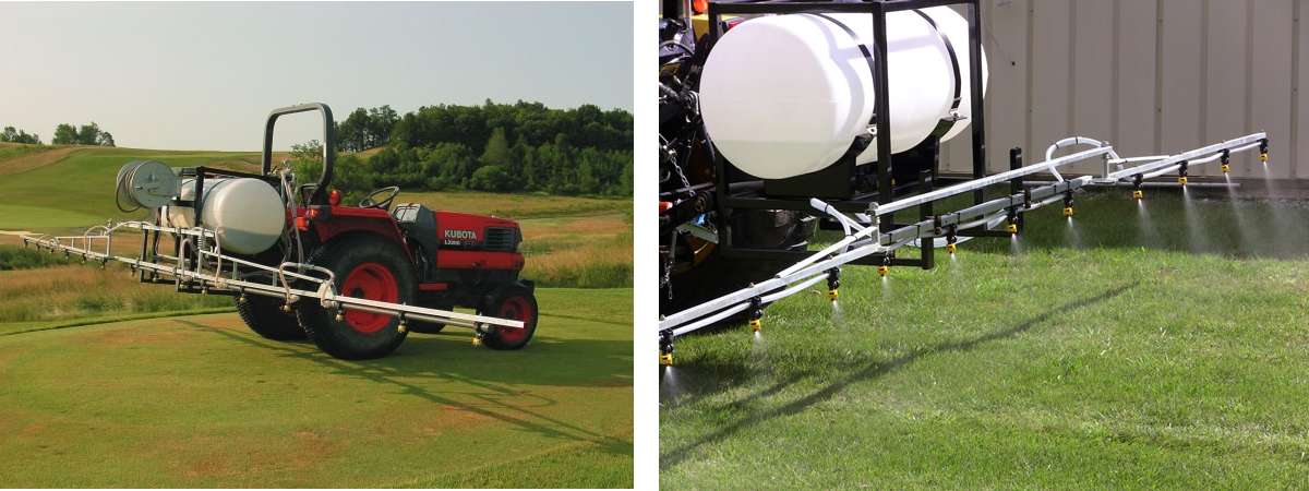

The setups for auto-steer tractors are accurate to within inches and not meters (yards). You got to be a BTO for that kind of setup. I have been thinking about getting a single foam marker under the sprayer so I can at least tell where the tractor was on the last pass. Maybe just get rig a removable 27' boom and use it with foam on each end and still have the broadcast head for those tight places
My Boomless Rig
27' boom
Foam Marker Kit

My cousin sprays some odd shaped fields and some of them are small is one of the reasons he uses this tint. On a large parcel a foam marker would be more be economical.

Stick with a foam marker system. Or learn to judge distance off your last tracks. That's what I do but I've also sprayed several thousand acres with foam markets too.
Measure it out and add a sticker to the ROPS or somewhere. When that it lined up with your last tracks your X feet from them. You do have to allow for the roll of the land.

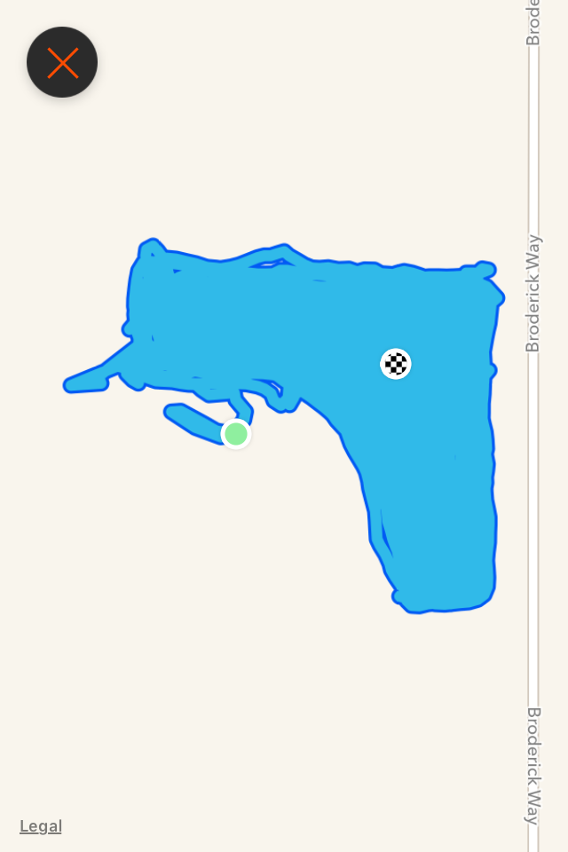

I have an app on my phone to record my bike rides. Just for grins, I used it the other day for brush-hogging our prairie. Here's what I got:
Looks like I missed a couple of spots but I didn't. As others have said, the accuracy isn't the best. I also have a Garmin computer that I use on the bike more than my phone. Maybe I'll try it next time to see if it's more accurate.
