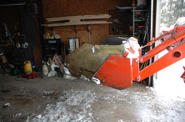

hey guys i have a ct230 was wondering where can i find a bigger bucket for snow the one that came with it is so small cant move to much snow at a time with it dont want to spend too much $$$$$$ thanks steve

72 inches wide just not a deep bucket
   / need a bigger snow bucket #4
Honestly I don't think you could get a big enough bucket to fit on a ct230 to even notice a difference. The bucket that came on mine is rather large for a 30hp tractor....
I think the key is the push the snow, not pick it up...
   / need a bigger snow bucket #5
Not sure how well it shows but if you look at my avatar and the attachment, this is what I added to my bucket to increase the capacity. If you don't weld someone could make it up for you easily enough. It just bolts on and off and is just plate steel. Works very well and a lot cheaper than a whole new bucket.

i seen the way you made your bucket bigger i think i could do something like that also .thanks for the picture it really is nice to have somewhere to go to get ideas thanks again. steve
